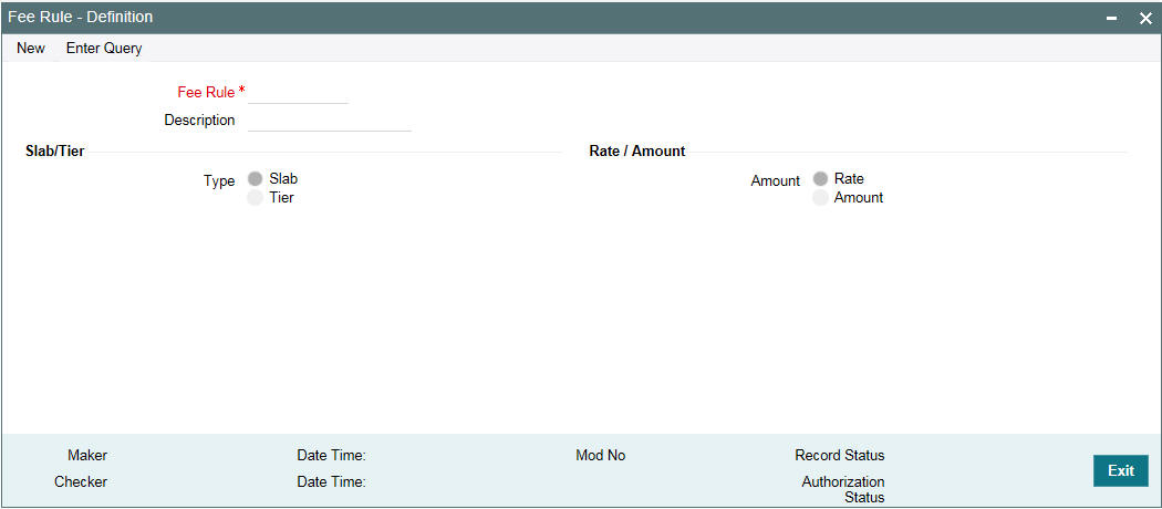

You can define a fee rule though the ‘Fee Rule – Definition’ screen. You can attach the fee rule to a Fee Class or directly to a syndication product.
You can invoke the ‘Fee Rule - Definition’ screen by typing ‘LFDFEMNT’ in the field at the top right corner of the Application tool bar and clicking the adjoining arrow button.
Specify the following details in this screen:
Fee Rule
Every fee rule you define in Oracle FLEXCUBE must be identified by a unique code. Assign a unique code to the rule you are creating. You can define a code comprising of a maximum of nine alphanumeric characters.
Description
Briefly describe the rule you are creating to facilitate identification from a list of similar rules. The description can consist of a maximum of 30-alphanumeric characters.
Slab/Tier
When defining a fee rule, you can specify whether the rule should have a Slab or Tier structure. However, the actual Slab or Tier structure should be maintained in the ‘Fee Rule Maintenance’ screen.
Rate/Amount
You can indicate the basis on which the rule being defined to calculate the applicable fee for the fee component – as a percentage or amount. Accordingly, you can capture the fee rate or fee amount applicable for the various Slabs/Tiers defined for the rule in the ‘Fee Rule Maintenance’ screen.
For more details on this screen, refer the heading ‘Maintaining Fee Rule details’ in this chapter.

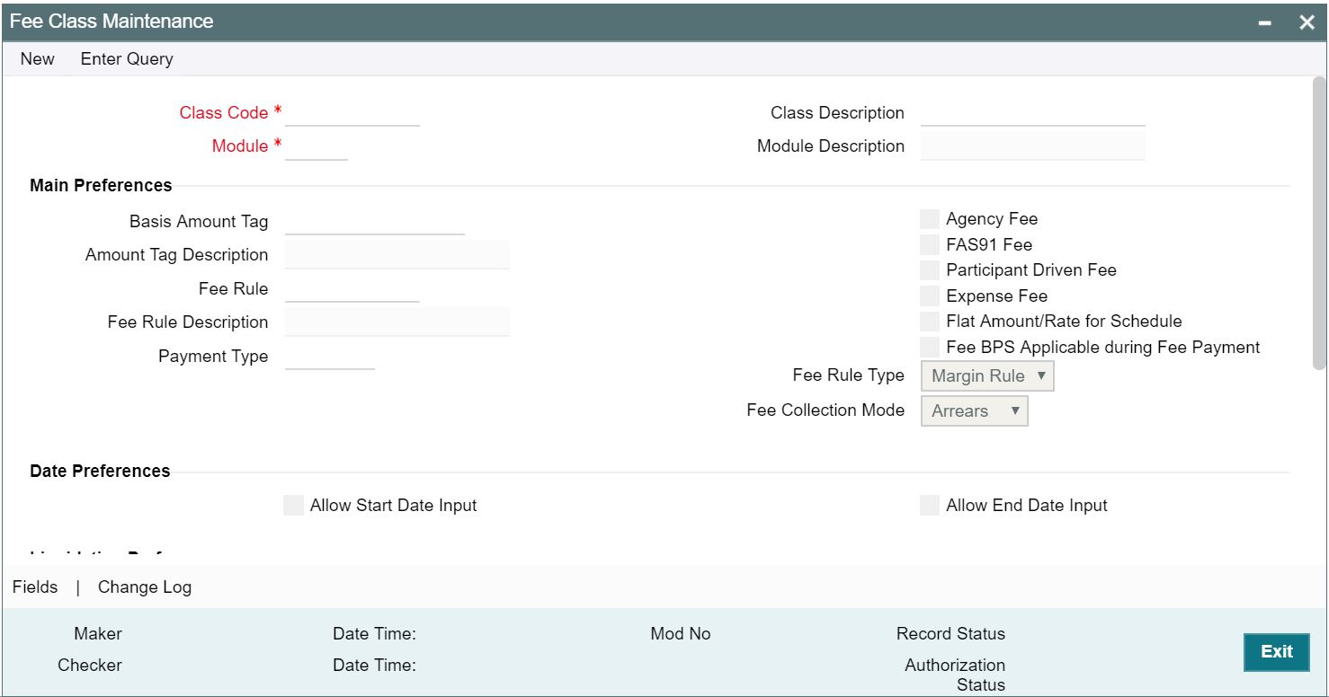

You have the option of defining a Fee Class through the ‘Fee Class’ screen. If you define a Fee Class, you can attach the same directly to a product. The product automatically inherit the attributes of the class.
If you do not define a Fee Class, you have the option of attaching a ‘Fee Rule’ to a product. In this case, however, you have to specify the fee preferences for the product at the time you associate the product with the rule.
You can invoke the ‘Fee Class Maintenance’ screen by typing ‘LFDFEECL’ in the field at the top right corner of the Application tool bar and clicking the adjoining arrow button.
The details to be captured in this screen are explained below
Specify Basic Details of the Fee Class
The basic details include the following:
Class Code
When defining a fee class, identify it with a unique code. The code helps you identifying the fee class in the system. You can devise a code consisting of a maximum of 10-alphanumeric characters.
Description
Briefly describe the fee class you are creating to facilitate identification of the same. The description can consist of a maximum of 30-alphanumeric characters.
Module
You have to select the module for which the fee class details are being maintained. Choose LB to indicate that the details are specific to the Loans Syndication (LB) module.
When you select the module, the description associated with it is displayed alongside.
Specifying Class Preferences
In the ‘Main Preferences’ section of the screen, you have to specify the following:
Agency Fee
You may select this option to indicate that the fee income received on a contract is meant for the leading agent alone. It does not get propagated to the other participants of the syndication contract.
If you select this option, you are not allowed to select the ‘Participant Propagation Required’ option.
FAS91
Select this check box to perform FAS91 computations. System validates if:
Participant Driven Fee
If you select this check box, system allows you to define an individual fee amount for each participant.
Note
Expense Fee
Select this check box to enable the expense fees. The fees can be accrued or amortized.
The expenses may be flat amounts (such as Legal Fee) or rate based on a specific basis amount (such as fee paid to credit guarantor)
These are expenses incurred against a contract which the bank does not directly recover from the borrower. These expenses can be one-time expenses or periodic expenses or paid in advance or in arrears. They may be incurred at the Facility/Tranche/ Drawdown levels.
In expense the fee calculation happens only within the schedule period of the contract whereas in normal arrears the fee calculation happens from the start of the contract till the schedule end date and for advance from the start of the schedule till the end of the maturity date.
For more information refer, to ‘Expense Fee’ section in this User Manual.
Basis Amount Tag
When defining a fee class, select the basis amount tag on which the fee amount should be calculated. The applicable amount tags are displayed in the option list provided. The description of the tag is displayed when you select the amount tag.
System computes a fee for issuing a letter of credit. This amount is paid only to the banks that have issued the LC. You can define a maximum of 10 such issuer fee components for 10 different issuers. You can associate each fee component with the corresponding basis amount tag.
The following table illustrates the amount tags used at the facility, tranche, and drawdown levels.
Basis Amount Tag |
Facility |
Tranche |
Drawdown |
Utilized |
No |
Yes |
No |
UNUTIL |
No |
Yes |
No |
DD count |
No |
Yes |
No |
User input |
Yes |
Yes |
Yes |
Principal |
No |
No |
No |
Principal-Outstanding |
No |
No |
No |
Tranche-Current-Limit |
No |
Yes |
No |
Tranche Outstanding |
No |
Yes |
No |
ISSUER1_LCOS |
No |
Yes |
No |
ISSUER2_LCOS |
No |
Yes |
No |
ISSUER3_LCOS |
No |
Yes |
No |
ISSUER4_LCOS |
No |
Yes |
No |
ISSUER5_LCOS |
No |
Yes |
No |
ISSUER6_LCOS |
No |
Yes |
No |
ISSUER7_LCOS |
No |
Yes |
No |
ISSUER8_LCOS |
No |
Yes |
No |
ISSUER9_LCOS |
No |
Yes |
No |
ISSUER10_LCOS |
No |
Yes |
No |
COMMERCIAL_LCOS |
No |
Yes |
No |
STANDBY_LCOS |
No |
Yes |
No |
COMPONENT_AMOT |
Yes |
Yes |
No |
COMPONENT_SPLT |
Yes |
Yes |
No |
TRANSFER_AVL |
No |
Yes |
No |
OUTSTANDING |
No |
Yes |
No |
AVAILABLE |
No |
Yes |
No |
Example
For an ‘Advance’ fee component, the following amount tags can be used:
Fee Rule Type
While defining a class, you can specify the rule type for the fee component. The available options are:
For calculating fee on contracts, you have to select ‘Margin Rule’ as the rule type.
Fee Rule
Select the applicable fee rule from the option list. The option list includes the rules that you have maintained through the ‘Fee Rule – Definition’ screen. When you select the rule, the description of the rule is also displayed.
Fee Collection Mode
Select the mode of collecting the fee. The available options are:
Note
Fee rate maintenance is done for ‘Advance’ and ‘Arrear’ fee components.
The following options are available in the ‘Date Preferences’ section of the screen:
Allow Start Date Input
By default, a fee component (if applicable for the product involved in the contract) becomes effective on the ‘Start Date’ of the contract (facility/tranche/drawdown). However, if you select the ‘Allow Start Date Input’ for the fee class (which would subsequently be associated with a syndication product), you are allowed to modify the start date of the fee component in the ‘Fee Components’ screen.
Allow End Date Input
Similarly, by default, a fee component (if applicable for the product involved in the contract) ceases to be associated with a contract on the contract ‘End Date’. However, if you select the ‘Allow End Date Input’ for the fee class (which would subsequently be associated with a syndication product), you are allowed to modify the end date of the fee component in the ‘Fee Components’ screen.
Note
If you do not select the above options, you are not allowed to change the ‘Start Date’ and ‘End Date’ for a fee component in the ‘Fee Components’ screen.
For more details on this screen, refer the heading ‘Specifying facility fee details’ in the ‘Loan Syndication Contracts’ chapter of this User Manual.
In the ‘Liquidation Preferences’ screen, you have to select the following:
Liquidation Mode
Select the mode of liquidating the fee components under this fee class. You have the following options:
For more information on forward processing, refer the heading ‘Forward Event Processing’ in the ‘Reference Information for Loan Syndication’ chapter of this User Manual.
Specifying Preferences for Fee Accrual
In the ‘Accrual Preferences’ section, specify the following:
Accrual Required
You have the option to accrue the fee earned on syndication contracts. To do this, you have to check this option.
Accrual Method
If accrual is required, you can specify the accrual method. You can accrue a fee using any one of the following methods:
You can amortize the portion of the FAS91 fee components and accrual starts from the date of the liquidation of the FAS91 FEE. For amortizing the fees, you should set the Accrual Method to ‘Straight Line’. The amortization amount is calculated based on the end date of the facility or tranche. For example, if the fee is linked to a facility, the facility end date is used as the last day to calculate the amortization amount.
Specifying Other Preferences for the Class
In the ‘Other Preferences’ section, you can opt for the following:
Allow Rule Amendment
You can select this option to allow amendment of the fee rule associated with the contract. If you check this option, you are allowed to change the default fee rule in the ‘Fee Components’ screen.
Allow Amount Amendment
You can select this option to allow amendment of the system calculated fee amount (utilized fee and unutilized fee) at the contract level (in the ‘Fee Schedules’ screen).
For more details on this screen, refer the heading ‘Maintaining facility fee schedules’ in the ‘Loan Syndication Contracts’ chapter of this User Manual.
Note
This field is applicable only if you select the ‘Fee Collection Mode’ as ‘Advance’.
Billing Notice Required
You can select this option to instruct the system to send a billing notice to the concerned borrower/participant as a reminder of the payment. The notice is sent predefined days before the due date of the fees.
You can capture the number of days, before which the notice should be generated, in the ‘Borrower Product – FEE Details’ screen.
Participation Propagation Reqd
While entering fee details, you have the option of passing the fee collected from the borrower to the participants of a facility, tranche or drawdown. The participants share the fee received as per the fee sharing ratio for a facility and as per the ‘Asset Sharing Ratio’ for tranche and drawdowns. This information is captured in the ‘Participant Asset Ratio’ screen.
However, you are not allowed to propagate the fee to the participants if you have marked the fee as an ‘Agency Fee’. In this case, only the lead agent is eligible to receive the fee amount.

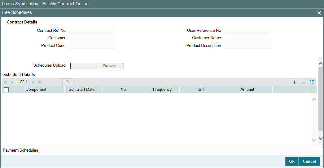

You can capture the fee schedules for a contract in the respective contract screen
For a facility
For a borrower facility, you can specify schedules for fee components through the ‘Fee Schedules’ screen. To invoke this screen from the ‘Facility Contract Online’ screen, click the ‘Schedules’ button.
For details on this screen, refer the heading ‘Maintaining facility fee schedules’ in the ‘Loan Syndication Contracts’ chapter of this User Manual.

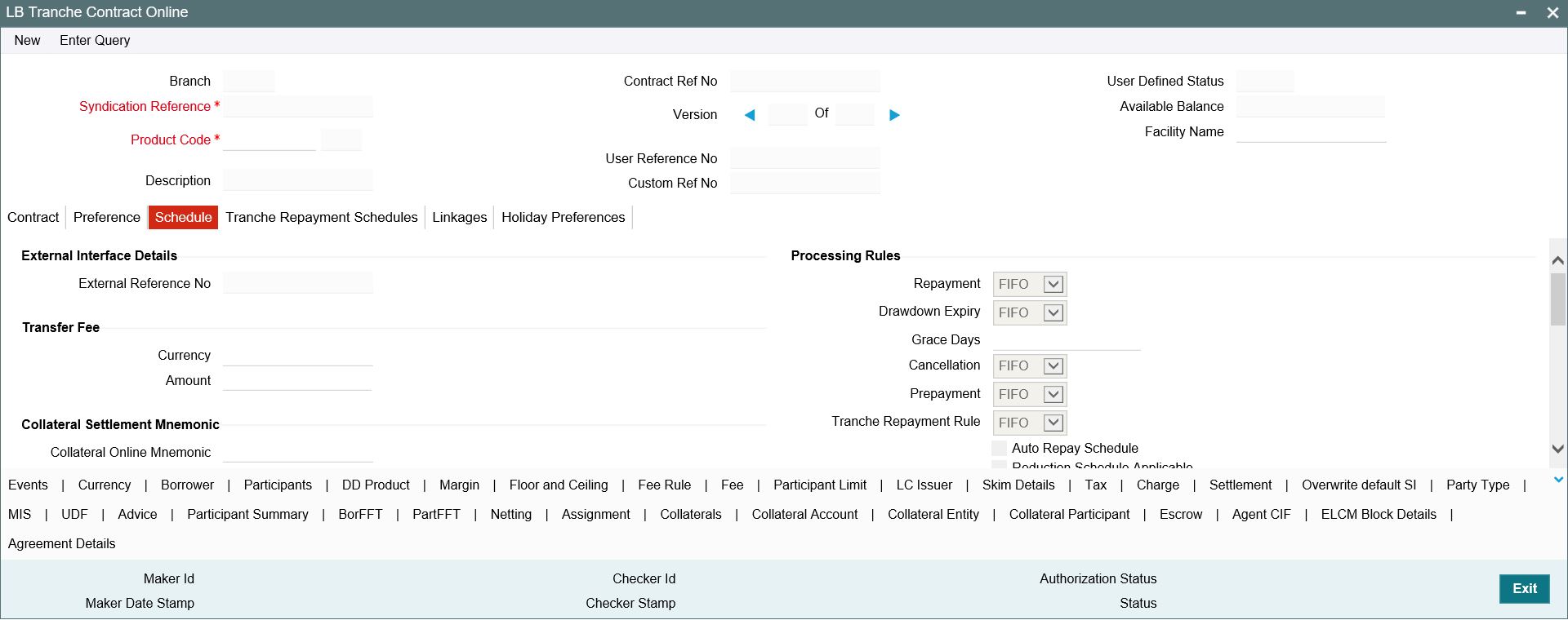

For a Tranche
For a borrower tranche, you can capture the fee schedules in the ‘Schedule Details’ section of the ‘Schedule’ tab of the ‘LB Tranche Contract Online’ screen.
Schedules are defined for fee components like ‘Advance’ and ‘Arrears’ for tranche using this screen’.
Note
For ‘Advance’ fee component, it is possible to define schedules on the value date of tranche.
For details on this, refer the heading titled ‘Specifying schedule details’ in the ‘Loan Syndication Contracts’ chapter of this User Manual.

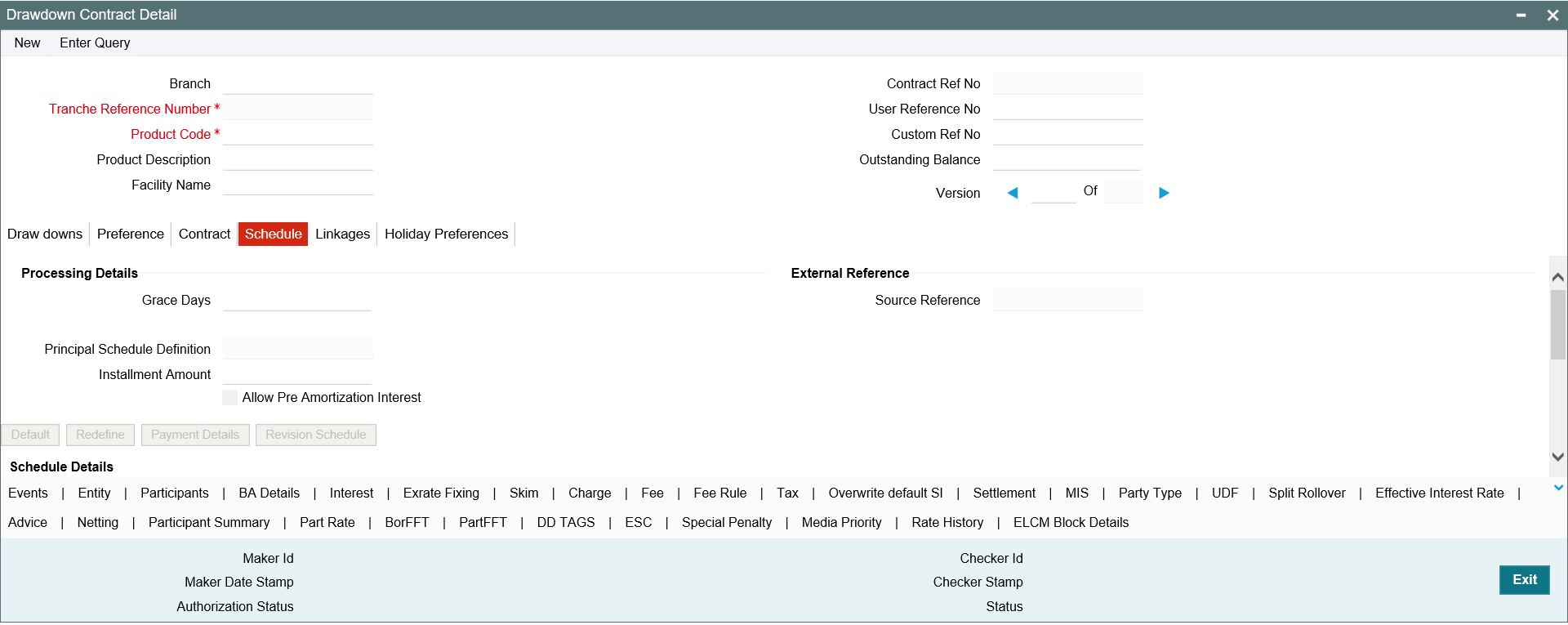

For a Drawdown
For a borrower drawdown, you can capture the fee schedules in the ‘Schedule Details’ section of the ‘SCHEDULE’ tab of the ‘Drawdown Contract Online’ screen.
For details on this, refer the heading titled ‘Specifying repayment schedule details’ in the ‘Loan Syndication Contracts’ chapter of this User Manual.

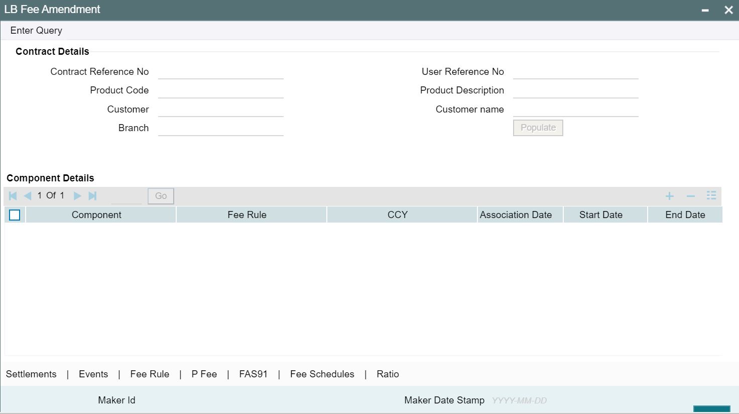

You may want to amend certain details of a fee component or reverse the fee of a component for a syndication contract (facility, tranche or drawdown). This can be done through the ‘Fee Amendment’ screen. For a fee component which has not been liquidated, is active and future dated, you can:
You can invoke the ‘Fee Amendment’ screen by typing ‘LBDFEAMD’ in the field at the top right corner of the Application tool bar and clicking the adjoining arrow button.
This screen displays the fee component details associated with the selected contract. The following details are displayed:
Note
For the fee components having basis amount as UTILIZED or UNUTILIZED,if there is a change in UTILIZED or UNUTILIZED amount due to Value dated amendment (VAMI), creation or liquidation of Drawdowns, then the unpaid schedules are recalculated and reflected in the future fee schedules. The recalculation for the unpaid fee schedules happens during the VAMI, If the change in basis amount happens during the fee calculation period of the Advance fee component's latest paid schedule, then the recalculation happens during the EOD on the date of amendment, and the calculated amount for that schedule is the sum of the calculated amount before amendment and after amendment.To make an amendment, you have to unlock the contract. To do this, click the ‘Unlock’ option from the menu.
Note
You can amend the fee for FAS91 fee components by clicking ‘FAS91’ in the ‘Fee Amendment’ screen. However, this is applicable only if the ‘Pass FAS91 Accounting Entry’ check box was not checked at the time of booking a contract.
For more details on FAS91 computation, refer the section ‘Computing FAS91 fee details’ in the Loan Syndication Contracts chapter.
In the Fee Amendment screen, you can also change the settlement account of the borrower by clicking the ‘Settlements’ tab.

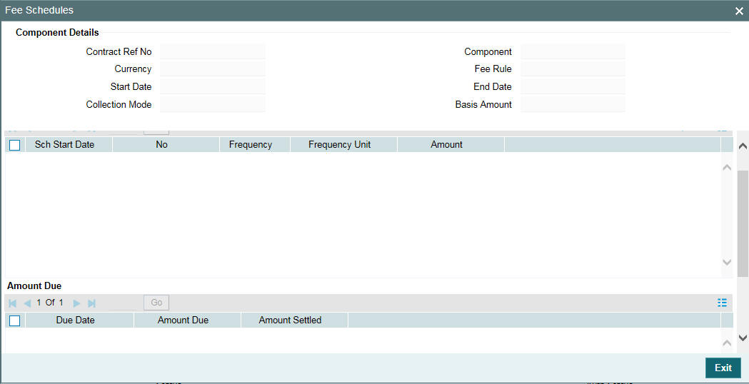

To amend the fee schedules defined for a component, select the component
and then click the ‘Fees Schedules’
button in the ‘Fee Amendment’ screen. The schedules maintained
for the selected component is displayed in the ‘Fee Schedules’
screen.
The following details will default to the ‘Component Details’ section of the screen:
In the ‘Schedule Details’ section of the screen, you can amend the following for an ‘Active’ component:
In the ‘Amount Due’ section of the screen, the system displays the ‘Due Date’ and the ‘Amount Due’ for each schedule.
After making the required amendments, click the ‘ok’ button to save and exit the screen.
Similarly, select the next component and change the schedule details, if required.

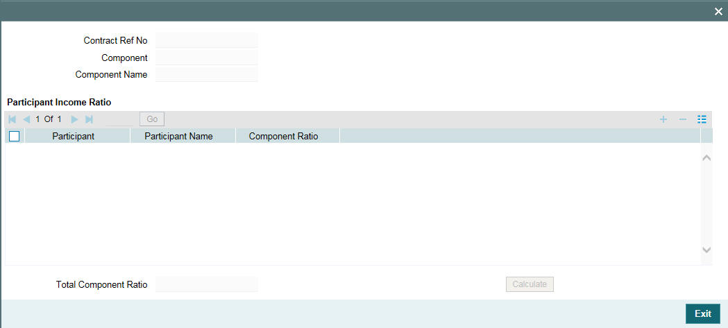

You can view the ratio in which a fee component is shared among the participants of the contract. To do this, select the fee component and then click the ‘Ratio’ tab.
The ‘Fee Component Sharing Ratio’ screen is displayed, as shown below:
In this screen, you can view the following:

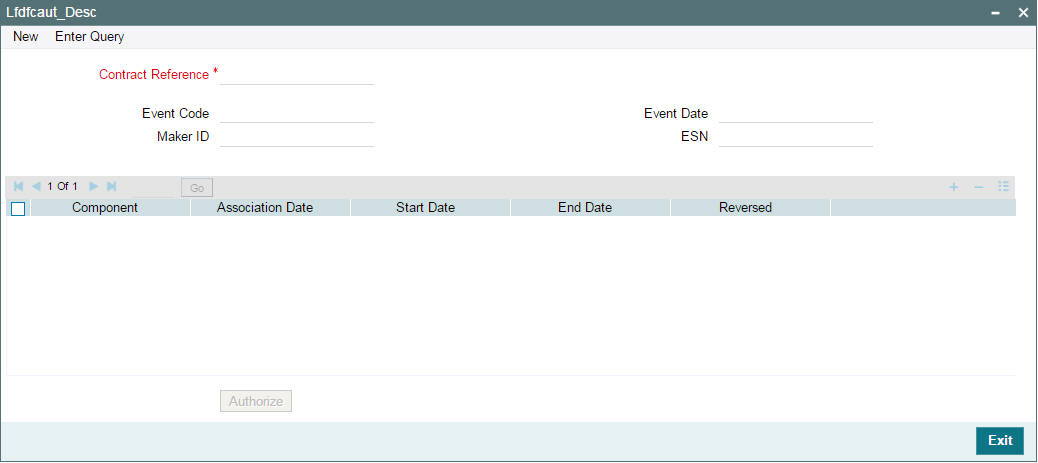

You can view the events triggered for the contract only after you save the amendment.
The CAMD event will be triggered for the contract. To view the event details, click the ‘Events’ tab in the ‘Fee Amendment’ screen.
The ‘Events’ screen is displayed, as shown below:
For more details on this screen, refer the section titled ‘Viewing events for the facility’ in the ‘Loan Syndication Contracts’ chapter of this User Manual.

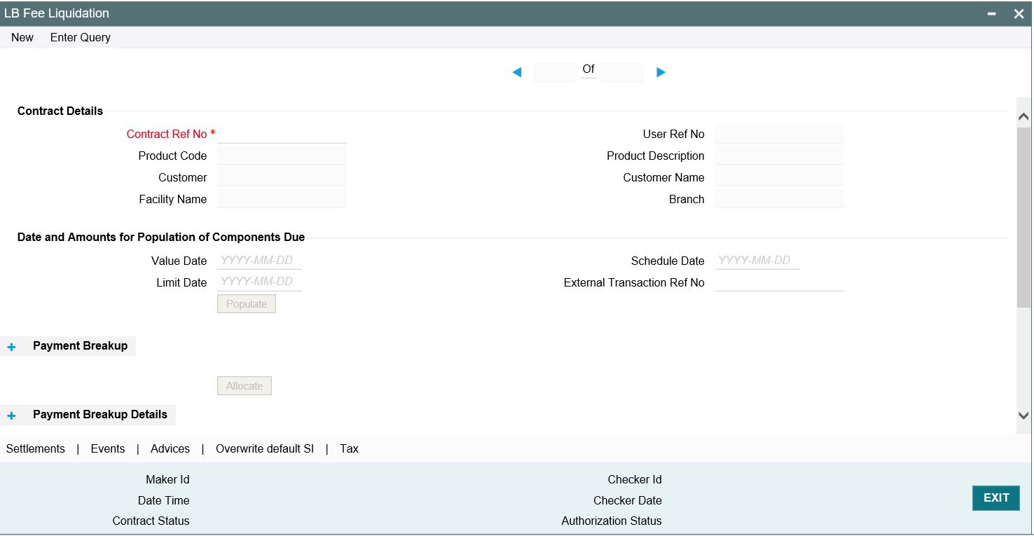

You can manually liquidate the fee schedules defined for fee components in the ‘Fee Liquidation’ screen. You can liquidate even future dated schedules through this screen. You can invoke the ‘Fee Liquidation’ screen by typing ‘LBDFEELQ’ in the field at the top right corner of the Application tool bar and clicking the adjoining arrow button.
To liquidate a fee component schedule, do the following:
Note
Click the ‘Save’ from the menu.
You can perform selective liquidation of the fee components as the payment happens, if required. For this, you need to specify the amount in the Amount Paid field for the fee component which needs to be liquidated. The System liquidates only those components for which Amount Paid value is the same as Amount Due. You cannot perform partial payments here.
For those components which are not part of the current fee liquidation, you need to specify the Amount Paid as zero.

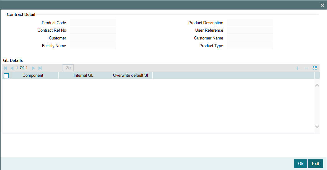

You can maintain settlement instructions for various components such as fees, charges, tax, principal, interest, and so on, using the ‘Overwrite Settlement Instruction Details’ screen. Using this screen, you can post liquidation entries into an Internal GL account instead of the customer account at the time of rollover. Click ‘Overwrite SI’ in the Fee Liquidation screen to invoke the following:
Enter the details specified below:
Component
This screen displays all the components displayed in the Settlement Message Details screen.
Internal GL
Specify the Internal GL accounts into which you want to post the liquidation entries for the components.
Overwrite default settlement instruction
Check the ‘Overwrite default settlement instruction’ box to confirm that the liquidation entries should be posted into the Internal GL account. System will post the entries to the Internal GLs only if you check this box. Otherwise, system will post the entries as per the settlement instructions specified for the component of the contract.
You can also view the settlement account details for the fee component in the ‘Settlement Message Details’ screen. Click the ‘Settlements’ tab to view the details.

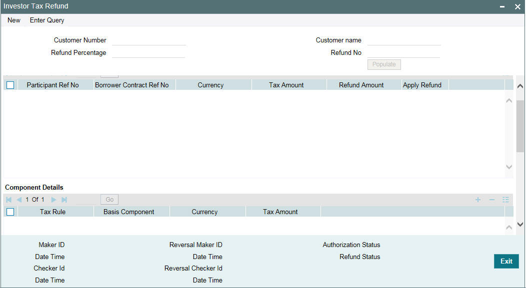

Oracle FLEXCUBE enables you to refund tax for a specific investor for all contracts or specific contract using ‘Investor Tax Refund’ screen. You can invoke the ‘Investor Tax Refund’ screen by typing ‘LBDTXRFC’ in the field at the top right corner of the Application tool bar and clicking the adjoining arrow button.
You can specify the following details here:
Customer No
Select the customer for whom you want to refund the tax from the investor list provided.
The name of the customer gets displayed in the adjacent field. The investor refund generates a unique refund number for the investor.
Note
Tax refund can be processed only for those contracts for which the ‘Tax Remittance’ is yet to be processed.
Refund Percentage
Specify the percentage of tax refund for the withheld Tax Amount. This percentage gets applied on the tax amount eligible for refund and displays the refundable amount from all the contracts of the investor.
Apply Refund
Select this check box to specify tax refund for the displayed contract of the investor.
Note
You cannot amend the refund amount, component and the tax schedules.
You can do the reversal of refund against each refund number. To query a specific refund record of an investor you have to provide the customer number and refund number. The two events which are triggered for Investor Tax Refund and Investor Tax Refund Reversal are:
