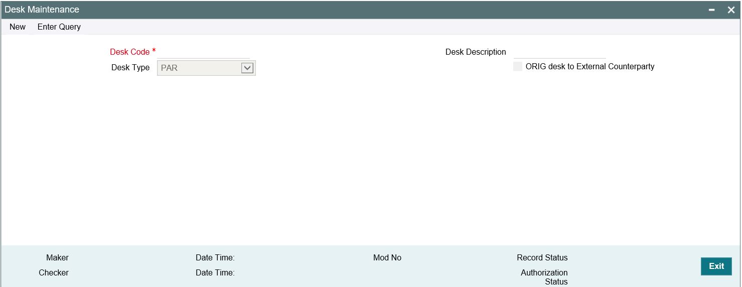

You can maintain different types of desks (loan desk, credit desk, and so on) used in your bank in the ‘Desk Code Maintenance’ screen. You can invoke the ‘Desk Maintenance’ summary screen by typing ‘LBDDKMNT’ in the field at the top right corner of the Application tool bar and clicking the adjoining arrow button.
For each desk type, you can capture the following information:
Desk Code
Specify a unique code to identify the desk in the system. You can use a maximum of 12 alphanumeric characters to define a code. You also have to capture a brief description of the desk in the adjacent box. The description can comprise of a maximum of 30-alphanumeric characters. Both, the code and description are mandatory information.
Desk Type
You can select the type of desk being maintained. The available options are:
Note
For STP, you have to specify the desk type as ‘Origination’.
In order to process transfer of portfolio from HFI to HFS, you need to maintain a desk of the type ‘ORIGINATION-HFS.’
The ‘ORIGINATIONS-PRM’ is used to identify the fronted or un-fronted portfolios which are involved in primary trade.

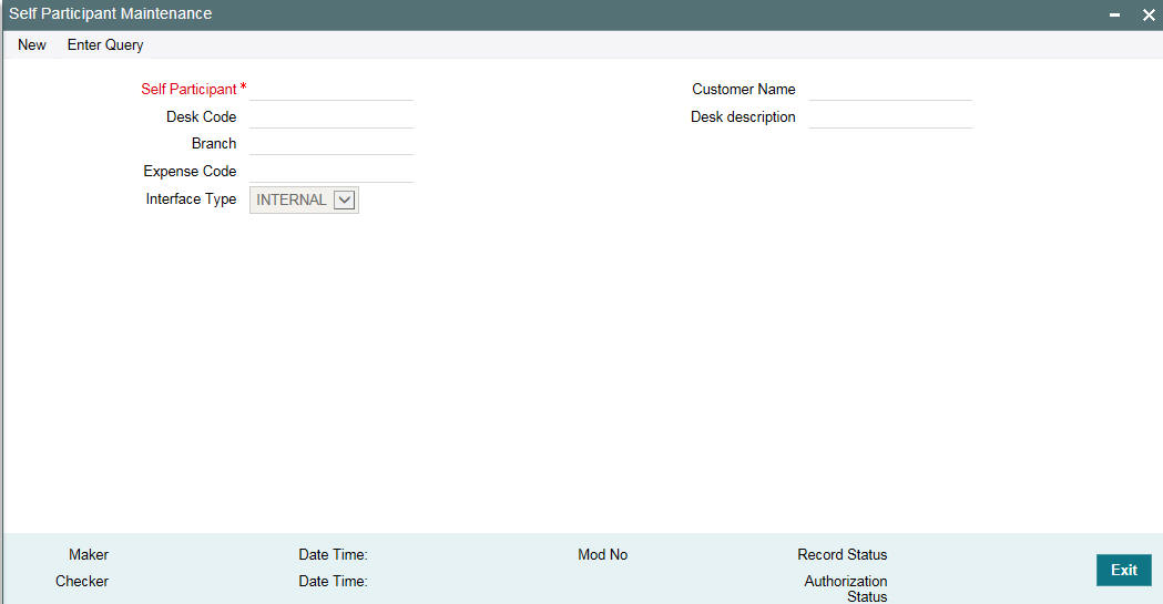

To identify bank participation in a syndicated loan, you have to define it as a self participant. Prior to this, you have to maintain the entity as a customer in Oracle FLEXCUBE (in the ‘Customer Information Maintenance’ screen).
For details on ‘Customer Information Maintenance’ screen, refer the ‘Maintaining Customer Information File’ chapter of the Core Entities (CE) User Manual.
After defining the entity as a customer in Oracle FLEXCUBE, you identify it as a self participant in the ‘Self Participant Maintenance’ screen.You can invoke the ‘Self Participant Maintenance’ summary screen by typing ‘LPDSPMNT’ in the field at the top right corner of the Application tool bar and clicking the adjoining arrow button.
You have to capture the following details in this screen:
Self Participant
Select the code of the self participant from the option list available. The codes of all valid customers (maintained in the ‘Customer Information Maintenance’ screen) are available in this list. Upon selection of the code, the participant’s name is also displayed in the adjacent box.
Branch
Select the branch, applicable for the self participant, from the option list available. All valid branch codes maintained in Oracle FLEXCUBE are available in the option list provided. The branch selected here is designated as the transaction branch for the participant that is, the system creates the corresponding commitment/loan contract in this branch.
Desk Code
Select the desk code applicable for the self participant. The option list displays the desk codes maintained through the ‘Desk Code Maintenance’ screen. Upon selection of the code, the associated description is also displayed in the adjacent box.
Expense Code
Select the expense code applicable for the self participant. The option list displays the expense codes maintained through the ‘MIS Cost Codes’ screen. The system tracks the expenses pertaining to the self participant against the expense code you select here. It also uses this code in the MIS reports generated for the participant.
For details on maintaining cost codes, refer the MIS User Manual.
Note
All the fields are mandatory to save the record.
Interface
Select the type of interface for STP from LB to OL. The available options are:
You can view the mapping between the self participant, branch code, desk code, and expense code in the ‘Participant Ratio Details’ sub-screen of the following screens:
The screen shot below shows the mapping in the ‘Participant Ratio Details’ sub-screen (see bottom left hand corner) of the ‘LS Tranche Contract Online’ screen.

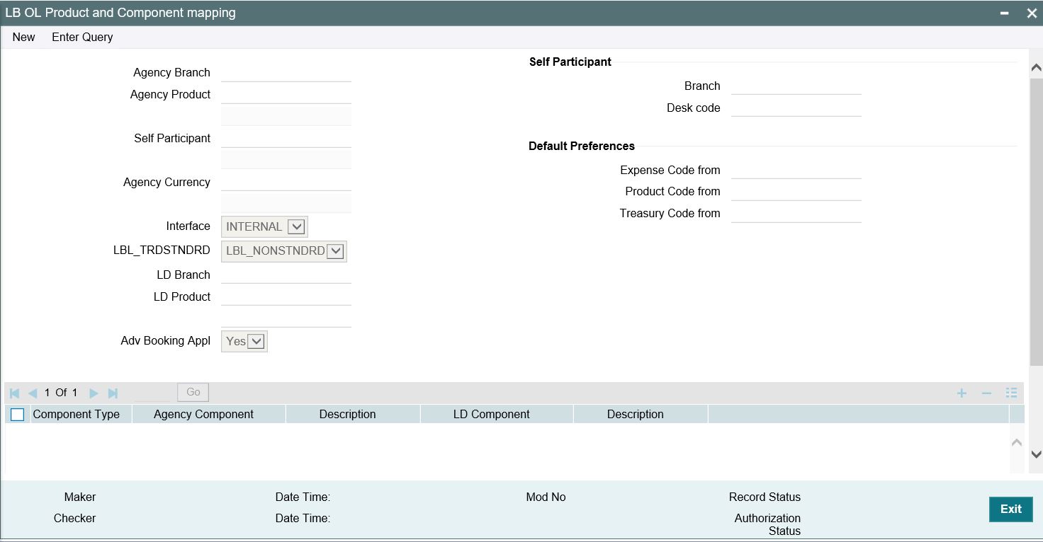

In order to facilitate the creation of the corresponding commitment/loan contract for a tranche/drawdown, you have to map the LB products and their components to the relevant OL products. You can do this mapping in the ‘LB OL Product and Component Mapping’ screen. You can invoke the ‘LB OL Product and Component mapping’ summary screen by typing ‘LBDPCMAP’ in the field at the top right corner of the Application tool bar and clicking the adjoining arrow button.
You have to specify the following details as part of product and component mapping:
Agency Branch
Select the transaction branch for initiating the LS contract on the agency side. All valid branch codes are displayed in the option list provided.
Agency Product
Select the LS product to be used for creating the LS contract. All valid drawdown products defined in the system are displayed in the option list provided. When you select the DD product, the system displays the description of the product in the adjacent box.
Self Participant
Select the self participant for the combination of agency branch and agency product selected in the previous fields. All self participants maintained in the ‘Self Participant Maintenance’ screen are displayed in the option list. Upon selection of the code, the system displays the name in the adjacent box.
In addition, the system also displays the branch code and desk code associated with the selected self participant (as per your mapping in the ‘Self Participant Maintenance’ screen).
Note
If you select the self participant as ‘ALL’, the system displays ‘ALL’ in the Branch Code and Desk Code fields also (in the ‘Self Participant details’ section of the screen).
In case of STP, you can choose the appropriate expense code for the commitment created from RAPID before it is being mapped to a Position Identifier while creating a new Tranche. The system does not perform any validations in this regard.
Expense Code From
For loans that are booked through STP, the system defaults the expense code from the commitment. But for the FCY loans you can choose to default the expense code from the following options:
Product Code From
For loans that are booked through STP, the system defaults the product code from the commitment. But for the FCY loans you can choose to default the product code from the following options:
The system does not perform any cross validations to enforce the same expense code for the SLT and Origination contracts for the given CUSIP and position Identifier combinations.
Treasury Code From
For loans that are booked through STP, the system defaults the treasury code from the commitment.
Interface
Trade Standard
The following are the list of values in the ‘Trade Standard’ drop-down list.
The ‘OL Product’ LOV display only the loan products where the ‘LMA Participation’ check box is selected when you select the value of the field ‘Trade Standard’ as ‘LMA’ in this screen. The system displays all loan products when the trade standard value is selected as ‘LSTA’ or ‘Non-Standard’.
Note
You are allowed to create a default maintenance with the key values as ‘All’, except for the fields ‘Agency Product’, ‘LD Branch’ and ‘LD Product’ for mapping the OL product which has the ‘LMA Participation’ check box selected.
LB Branch
If the interface type is ‘Internal’, the system displays the branch code of the selected self participant (as per your mapping in the ‘Self Participant Maintenance’ screen).
For an ‘External’ type of Interface, you have to key-in the branch code.
LB Product
Similarly, for an ‘Internal’ type of interface, you can select the applicable loan product from the available option list. The system displays all loan products applicable for creating agency contracts on the originations side (in the ‘Loans – Product Preferences’ screen, the ‘Agency Contract’ box is checked for such products). Upon selection of the product, the system also displays the associated description in the adjacent box.
For an ‘External’ type of Interface, you have to key-in both the product code and the description for the same.
Adv Booking Appl
Select ‘YES’ to if you wish to process the corresponding commitment/loan contract in advance for future dated drawdowns. The default value is ‘YES’. However, you can change it. If you select ‘No’, the system creates the commitment/loan contract only after the INIT (Initiation) event is triggered for the corresponding drawdown.
When you tab out of this field, the system takes you to the component mapping section of the screen. To modify the fields explained above, click ‘Up arrow’ icon. You can then select the value you want to amend.
New check box
Select this check box to indicate if you wish to copy all the details for LB OL Product and Component mapping with only the self-participant being different.
Note
You can map the components of the selected LB and OL products in the component section of the screen.
As part of mapping, you have to specify the following:
Component Type
Select the type of component for the mapping. The available options are:
Agency Component
The components associated with the selected ‘Agency Product’ are displayed in the option list. When you select the code of the component, the system also displays the associated description in the adjacent field.
LD Component
Likewise, the system displays the components associated with the selected ‘LD Product’ in the option list provided. When you select the code of the component, the system also displays the associated description in the adjacent field.
For an ‘External’ type of interface, you have to key-in both the component code and the description for the same.

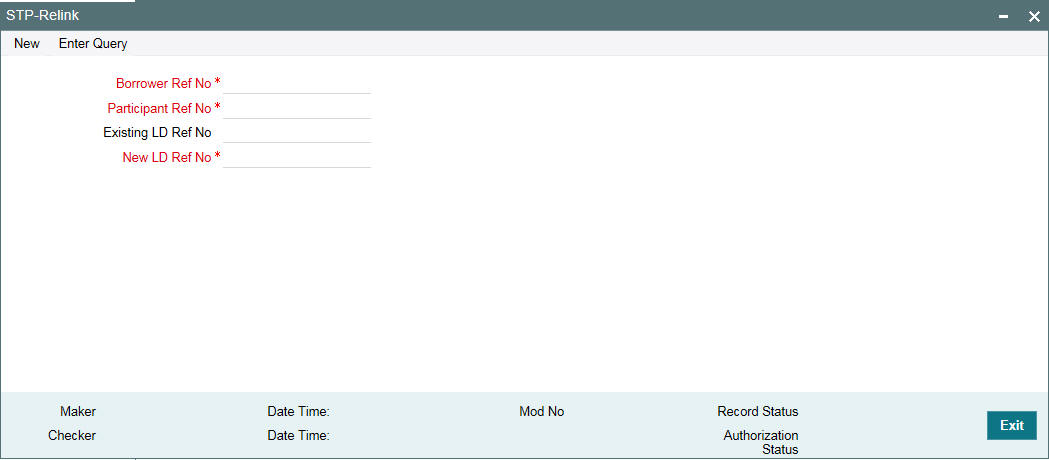

You can manually map LB to OL contract details while booking the tranche level contract by clicking the COMM link button at the tranche level. Once tranche contract is authorized, linking commitment contracts to the tranche is done by using the STP - Relink screen.
You can invoke the ‘STP-Relink’ screen by typing ‘OLDRLINK’ in the field at the top right corner of the Application tool bar and clicking the adjoining arrow button.
Specify the following details:
Borrower Ref No
Specify the borrower reference number. The adjoining option list displays all the borrower reference numbers maintained in the system.
Participant Ref No
Specify the participant reference number. The adjoining option list displays all the participant reference numbers maintained in the system.
Existing OL Ref No
Specify the existing OL reference number here.
New OL Ref No
Specify the new OL reference number here.

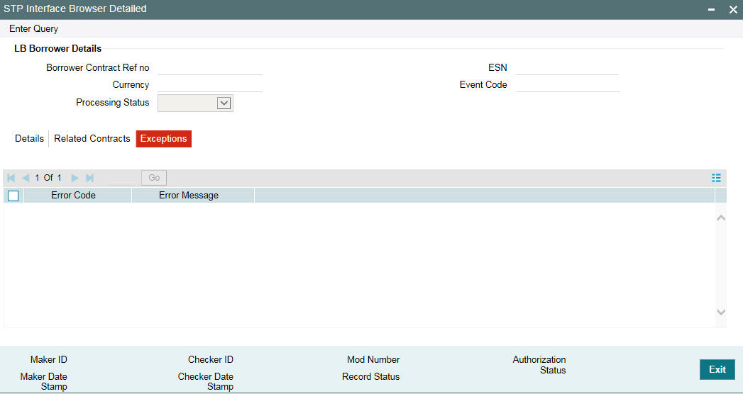

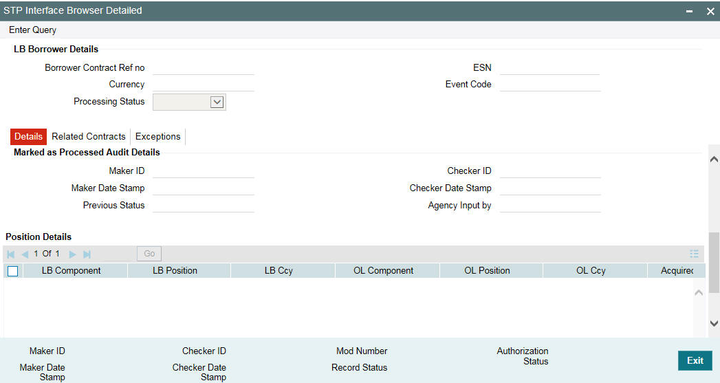

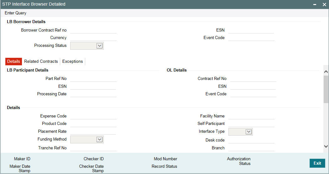

You can view the records in the ‘Straight Through Processing Interface Browser’ available in the Application Browser. You can invoke the ‘STP Interface Browser Detailed’ screen by typing ‘LBDSTPIB’ in the field at the top right corner of the Application tool bar and clicking the adjoining arrow button.
You can view the ‘Processing Status’ and other associated details of the record in the above browser. The following statuses are applicable for the records:
Note
If the interface type is ‘External’, you have to unlock the record, key-in the commitment/loan details and then save and authorize the record.
Note
While processing the specific event, the negative base rate or margin rate is considered during interest calculation on loan contracts if base rate or margin rate is in negative at the drawdown level.
You can unlock a record by clicking a specific record. And you cannot navigate to other records until the record is saved.
You can also authorize the record by clicking specific record. And manually mark the process status as ‘Processed’, if the process status of the record is in ‘Enrich’. The system does not validate the position during the transaction.
Prior to processing the contract in the OL module, the system ensures the following:
You can view the outstanding position of each LS contract and that of the corresponding commitment/loan contract in the ‘Position Details’ section. Scroll down in the ‘STP Interface Browser Detailed’, to view component-wise position
The system displays the following details for both LS and the corresponding loan contract in this screen:
Note
If the interface type is ‘External’, the system displays the position of the LS contract only.
After successful validations, the system triggers the events for the commitment/loan contract. The borrower and the agency (identified by the ‘Agency ID’ selected in the Facility Contract Online’ screen) of the LS contract becomes the customer and the settlement party, respectively, of the generated loan contract. Further, the system updates the ‘Processing Status’ of the events to ‘Processed’ and displays the loan details in the browser.
You can view the loan in the ‘OL Contract Online’ screen.The system checks the ‘Agency Contract’ box to distinguish between a normal contract and the contract created as a result of STP. If required, you can unlock the record and uncheck this box. If you uncheck, the contract becomes a normal loan contract. Further, the system stops tracking bank (playing the role of the self participant) share in the syndication.
The straight through processing may fail due to the following reasons:
If the processing fails, the record moves to the ‘Failed’ status. You can view the reason of failure in the ‘Exception Log’ screen. Click ‘Exceptions’ tab in the ‘STP Interface Browser Detailed’ to view the exceptions.

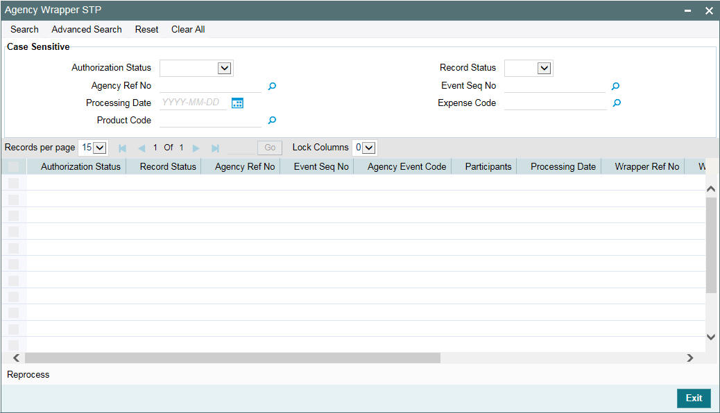

You can reprocess the STP handoff data in case of failure in the OL module also. The details are updated in the ‘Origination Interface Browser’ screen.
You can also invoke this screen by typing ‘LBSAGYIB’ in the field at the top right corner of the Application tool bar and clicking on the adjoining arrow button.
Processing Status
Choose ‘Reprocess’ from the option list to change the processing status to reprocess in case of failure.

LB-OL STP Product and Component mapping maintenance should be done for the same kind of LB and OL ‘Amort’ products matching the attributes like ‘Allow userinput installment’, ‘Allow re-amortization’.
The system picks up the mapping origination borrower for the Tranche/Drawdown borrower from the syndication-origination customer mapping maintenance, while booking the origination commitment and populates the same. Agent CIF field at the originations gets displayed with the Agent CIF and settlements are picked up for the Agent CIF mnemonic maintenance. In the absence of maintenance, the system continue to book the origination contract without Agent CIF and mnemonic is picked by the normal settlement logic based on the settlement maintenance available for the origination commitment/loan customer.
System checks for the syndication to origination customer mapping only as part of STP process while booking the new loan/commitment. If the loan/commitment is manually created, then linked to agency does not validates the syndication to origination customer mapping.
