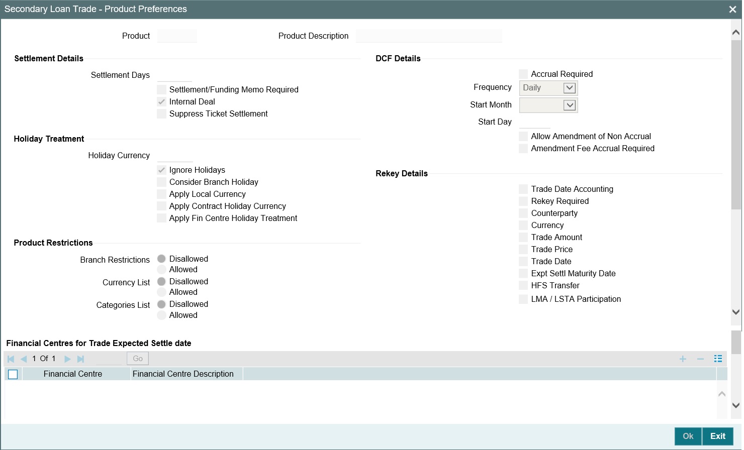

Preferences are the options available for defining the attributes of a product. You can specify the preferences associated with an SLT product in ‘Secondary Loan Trade – Product Preferences’ screen. To invoke this screen, click ‘Preferences’ in the Product Definition screen.
You can specify the following details in this screen:
Settlement Days
Specify the number of days after the trade, within which settlement should happen.
Settlement/Funding Memo Required
Select this check box to indicate that a settlement or a funding memo needs to be sent to the trade counterparty.
Internal Deal
Select this check box to indicate that the trade deal involved is an inter company deal.
Note
You need to deselect ‘Settlement/Funding Memo Required’ for internal deals.
Suppress Ticket Settlement
The ‘Suppress Ticket Settlement’ check box is cleared by default. You can select this check box as part of product amendment.
You are not allowed to select ‘Suppress Ticket Settlement’ check if the ‘Automate Ticket Settlement’ check box is not selected and authorized in the 'Loans Parameters' screen.
Note
The system does not validate if the ‘Automate Ticket Settlement’ check box is not selected in the 'Loans Parameters' screen when the ‘Suppress Ticket Settlement’ is selected and authorized in the 'Secondary Loan Trade- Product Definition’ screen.
The system does not validate if the ‘Suppress Ticket Settlement’ check box is not selected in the 'Secondary Loan Trade- Product Definition’ screen when the new flag ‘Automate Ticket Settlement’ is checked/unchecked in the 'Loans Parameters' screen.
If the ‘Suppress Ticket Settlement’ check box is selected, the trades booked under the product are excluded from systematic settlement even if the ‘Automate Ticket Settlement’ check box is selected in the 'Loans Parameters' screen.
If the ‘Suppress Ticket Settlement’ check box is not selected, the trades are settled systematically if the ‘Automate Ticket Settlement’ check box is selected in the 'Loans Parameters' screen.
If you copy an existing product with the ‘Suppress Ticket Settlement’ check box selected, the check box value is not copied.

You can indicate your preferences for holiday treatment, here.
Holiday Ccy
Select the currency associated with a trade deal, for which you want to specify the holiday preferences.
Ignore Holidays
Select this check box to indicate that the settlement date is fixed without taking the holidays into account.
Consider Branch Holiday
Select this check box to indicate that the settlement date is fixed taking into consideration the holidays specified for the branch.
Apply Local Holiday Currency
Select this check box to indicate that local currency holidays need to taken into consideration while fixing the settlement date.
Apply Contract Holiday Currency
Select this check box to indicate that the contract currency holidays need to taken into consideration while fixing the settlement date.
Apply Fin Centre Holiday Currency
This check box allows you to enable financial centre holiday treatment and add the financial centres for the holiday treatment.
For more information about maintaining financial centre for holiday treatment refer to Products User Manual.
Delayed compensation fee is associated with trades for which the trade settlement date exceeds the expected settlement date. You can specify the following preferences related to DCF here:
Accrual Required
Select this check box to indicate that you need to accrue the delayed compensation fee component at specific intervals.
Frequency
Select the frequency at which you would like to accrue the delayed compensation fee, from the options provided in the drop-down list. The following options are available:
Start Month
Select the month in which the accrual of the fee component has to begin, from the drop-down list provided.
This is applicable if you specify any accrual frequency other than daily or monthly.
Start Day
Specify the date on which the accrual should be done during the month. For example, if you specify the date as ‘20’, accrual is carried out on that day of the month, depending on the accrual frequency.
Allow Amendment of Non Accrual
Select this check box to indicate that the system allows you to change the preference maintained for the box ‘Stop DCF Accrual’ at Position contract level.
Trade Date Accounting
Select this check box to indicate that the trade date accounting functionality is applicable for the following products maintained for CFPI trading:
If this check box is deselected for any product, then system does not post trade date accounting entries for the contract associated with the product. This results in position break in control accounts.
Note
You cannot amend this check box once the product is authorized.
Rekey Required
Select this check box to indicate that certain important details related an SLT need to be rekeyed, at the time of authorization. You can specify any or all of the following as rekey fields:
HFS Transfer
Select this check box to indicate that trades under this product should be considered as HFS transfer transactions. Note that you can select this check box only if the check box ‘HFS transfer and Sale’ is selected in the ‘Loan Parameters’ screen.
Once the product is authorized, you cannot deselect this check box.
LMA/LSTA Participation
The ‘LMA / LSTA Participation’ (Loan Market Association /Loan Syndications and Trading Association, Inc.) check box is not selected by default. This check box is enabled only for ‘Trade’ products. Even after authorization, you can edit this check box.
However, the change in the value of check box impacts only the new trades booked under the product. Existing trade contracts are not impacted. The value of the check box is copied when you copy an existing trade product with the check box selected.
Product Restrictions
When you create a product, you can provide product restrictions. That is, you can specify the branches of your bank that can offer this product, the currencies that are allowed or disallowed and the customers who can avail the product.
You can set preferences in this screen and the same is defaulted to 'Bilateral Loan and Commitment Restrictions' screen.

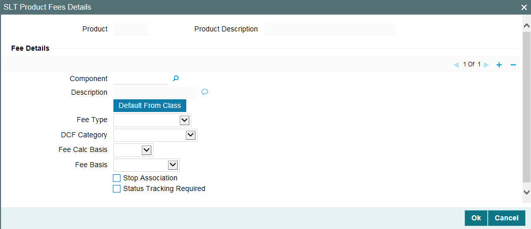

You can specify the details regarding the fee associated with an SLT in ‘SLT Product Fees Details’ screen. To invoke this screen, click ‘Fees’ in the ‘Secondary Loan -Product Definition’ screen.
You can specify the following details regarding fee, in this screen:
Component
Specify the name of the fee component for which you are maintaining the details.
Description
Specify a suitable description for the fee component.
Fee Type
Select the type of the fee from the drop-down list. The following options are provided:
DCF Category
Select the sub category associated with the delayed compensation fee from the drop-down list. The following options are provided:
DCF category is enabled only if you select the fee type as ‘DCF’.
The formula to calculate COC is given below;
The computation is done based on the method ‘Rule of 25’ and will continue until the actual settlement date. The derivation of ‘Rule 25 on T+20 and T+21’ is mentioned below:
[(Fund*Price– (Unfunded + Commitment Reduction)*(1–Price)] as of T+20 (Expected Settlement Date)
Rule-25-factor on T+20 = -----------------------------------------------------------------------------------
[(Fund*Price– (Unfunded + Commitment Reduction.)*(1–Price)] as of Trade Date
[(Fund*Price– (Unfunded + Commitment Reduction.)*(1–Price)] as of T+21
Rule-25-factor on T+21 = -----------------------------------------------------------------------------------
Note
For the trade currency,
For the other funded currencies,
Fee Calc Basis
Select the source for deriving the ‘Fee Basis’ for calculating the fee amount, from the drop-down list. The following options are provided:
This is enabled if you select the fee type as ‘DCF’ or ‘Break-fund Fee’.
Fee Basis
The Fee Basis indicates the method in which a given fee amount has to be calculated. The values in the drop-down list are:
This is enabled if you select the fee type as ‘DCF’ or ‘Break-fund Fee’. If you specify the Fee Calc Basis as ‘Agency’, this will get disabled.
Stop Association
Select this check box to indicate the fee component should not be associated with the product henceforth.
Note
There are no fee components associated with internal deal type of products.
Status Tracking Required
Select this check box to allow the system to start and restart accrual of DCF components.
Note
You can select this check box only for the following type of DCF components:
