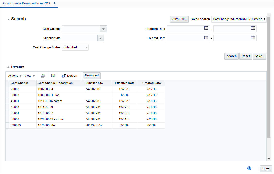

Download from Merchandising
Similarly data can be downloaded from Merchandising. Cost change data is typically downloaded for purposes of updates such as effective date changes, workflow changes or reporting considerations.
Cost Change Download from Merchandinsing
In addition to downloading cost change data, you can also download blank templates, in a specified template format, that carry just the worksheets and column headers without any data. Such templates are generally used for creating new cost changes manually. Blank Templates can be downloaded from by navigating to Foundation Data > Data Loading > Download Blank Template. You need to select the Type as Cost Change and one of the Templates from the list available before opting to download the template. For more detail on using Blank Templates see ”Download Blank Templates” in the Oracle Retail Merchandising Do the Basics User Guide.

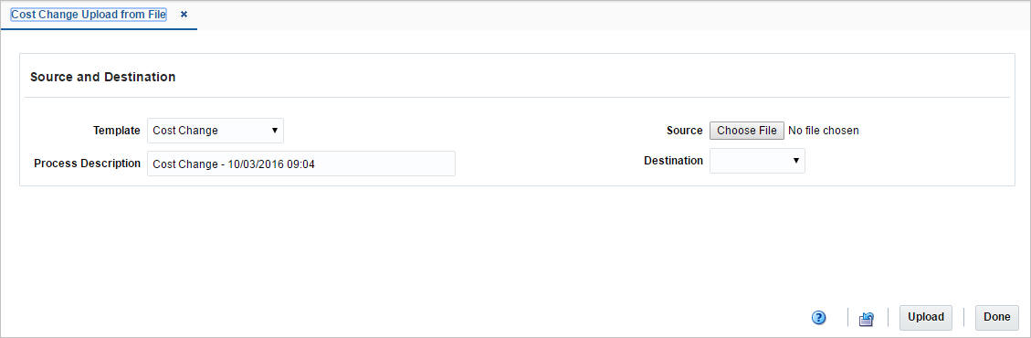

Upload from a File
Once updates have been carried out to downloaded data, you can upload the spreadsheet to have your updates applied in Merchandising or to update the staged cost change data.
Cost Change Upload from File
