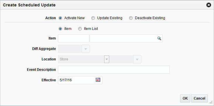

The Create Scheduled Update window allows you to create a new scheduled replenishment and scheduled event to activate a new replenishment attribute, or to update, or deactivate an existing attribute.
To create a scheduled update, follow the steps below.
From the Tasks menu, select Replenishment > Create Scheduled Update. The Create Scheduled Update window appears.
In the Action section, select if you want to activate a new, update or deactivate an existing replenishment attribute.
Select, if the scheduled update is to be created by using item or item list.
In the Item/Item List field, enter, select or search for the item/item list.
In the Diff Aggregate field, enter, select or search for the differentiator associated with the selected item.
In the Location field, select the location type from the list. Then, enter, select or search for the location.
In the Event Description field, enter a description.
In the Effective field, enter the date the update takes place or use the Calendar icon to select an effective date.
Then choose one of the following options.
Click OK to create the scheduled update.
If you select the action Activate New or Update Existing, the Replenishment Attribute window appears, allowing you to enter additional information.Click Cancel to reject all entries and close the window.
