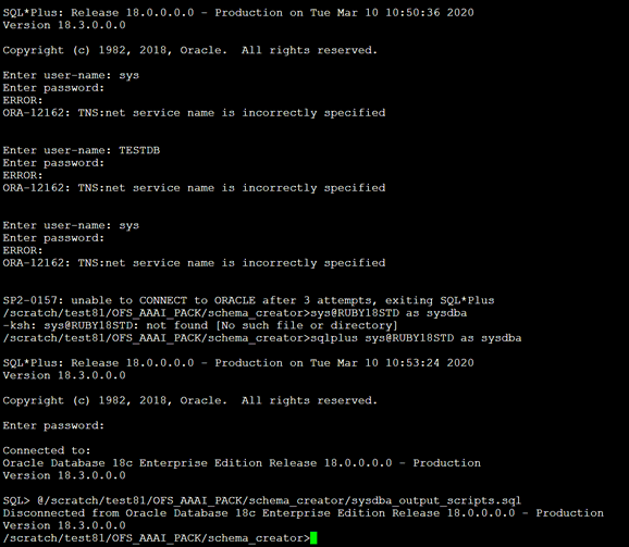

10.  Log in to the database using credentials with SYSDBA privileges.
Figure 12: Schema Creation in Offline Mode – Execute sysdba_output_scripts.sql
11.  Execute the sysdba_output_scripts.sql file using the following command:
SQL>@sysdba_output_scripts.sql
Alternatively, you can copy the sysdba_output_scripts.sql file and SQLScripts directory to a remote server and execute the sysdba_output_scripts.sql file, after providing appropriate execute permissions.
