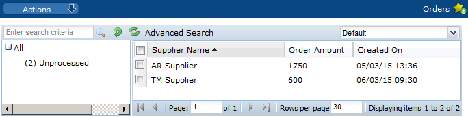

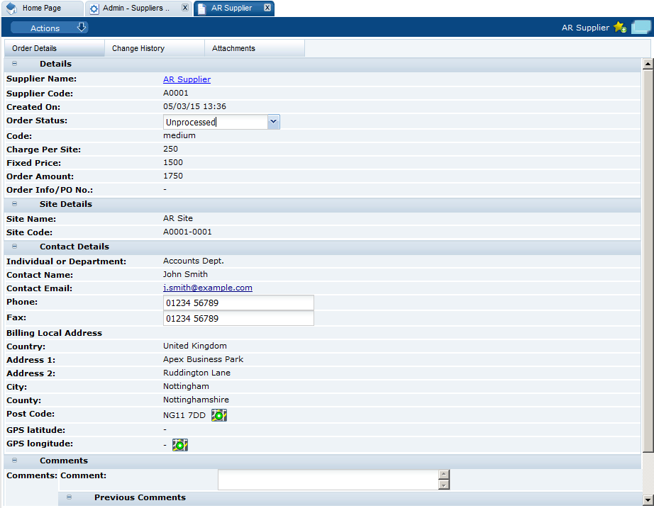

Order Requests
This option is used to manage registration order requests.
To work with orders:
  1. Select Order Requests. The list of orders appears. It is sorted into processed and unprocessed orders.
    Figure 7-3 Orders Page
    Surrounding text describes Figure 7-3 .
  2. To see the details for an order, select the order and then select the View action. A new tab opens with the order details in read-only mode. For an example of the content, see Figure 7-4.
  3. To edit an order, select the order an then select the Edit actions. A new tab opens with the order record in edit mode.
    Figure 7-4 Order Details Page
    Surrounding text describes Figure 7-4 .
    • Order status: Choose the status from the drop-down list. The status can be updated to Processed once the supplier has been billed.
    • Contact Details: The Phone and Fax fields can be updated.
    • Comments: Enter any comments.

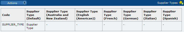

Supplier Types
This option is used to define the types of suppliers that can be created.
Figure 7-9 Supplier Types Page
Surrounding text describes Figure 7-9 .
To edit the list of supplier types, select the Edit action. The table opens in edit mode. For existing supplier types, only the translated descriptions that do not already exist can be edited. To add a supplier type, click Add. A new row is added to the table. Enter the new supplier type and description in the default language. Enter any translations. Select the Save action.

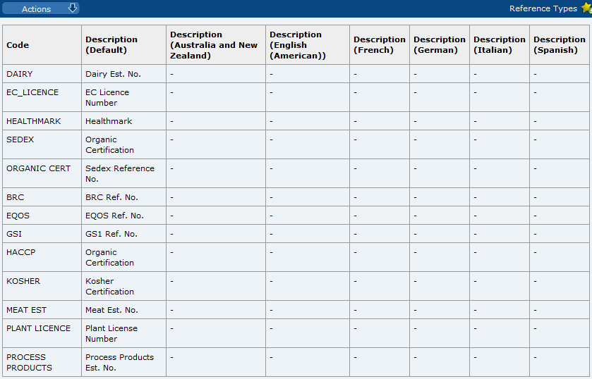

Reference Types
This option is used to define the reference types, or certificate types, that can be associated with a supplier.
Figure 7-10 Reference Types Page
Surrounding text describes Figure 7-10 .
To edit the list of reference types, select the Edit action. The table opens in edit mode. For existing types, only the translated descriptions that do not already exist can be edited. To add a new type, click Add. A new row is added to the table. Enter the new type code and description in the default language. Enter any translations. Select the Save action.

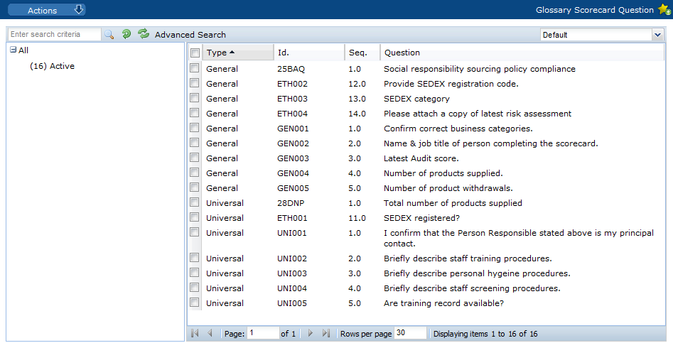

Scorecard Questions
Each scorecard template is comprised of a series of questions which may be selected from this glossary.
Figure 7-19 Glossary Scorecard Question Page
Surrounding text describes Figure 7-19 .
To edit a question, select the question and then select the Edit action. A tab opens with the record in edit mode.

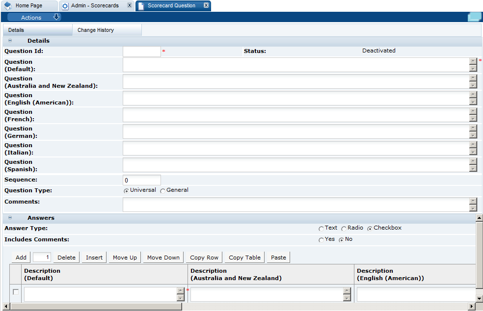

To create a new scorecard question:
  1. Select the New Question action. The Scorecard Question tab opens.
    Figure 7-20 New Scorecard Question Page
    Surrounding text describes Figure 7-20 .
  2. In the Details section:
    • Question Id: Enter the ID for this question. The ID must be between 3 and 10 characters and unique. The value cannot be changed once the question has been created. This field is mandatory.
    • Status: The status is set to Deactivated.
    • Question: Enter the question in the default language. This field is mandatory.
    • Sequence: Enter the sequence number for this question. The sequence number is used to set the default order of questions within the scorecard template.
    • Question Type: Select the type of question:
      • Universal questions are automatically added to a scorecard template. These questions may be removed and individually re-added as required (if configured in System Parameters to allow removal).
      • General questions are manually added to a scorecard template from the questions glossary.
    • Comments: Enter any comments. This field is not mandatory.
  3. In the Answers section:
    • Answer Type: Select the type of answers allowed for this question.
    • Includes Comments: If set to Yes, a text field is included in the questionnaire to enable the user to enter any comments.
    • To add an answer choice, click Add. Enter the answer in the default language. This is a mandatory field. Enter any translations.
  4. Select the Save action.

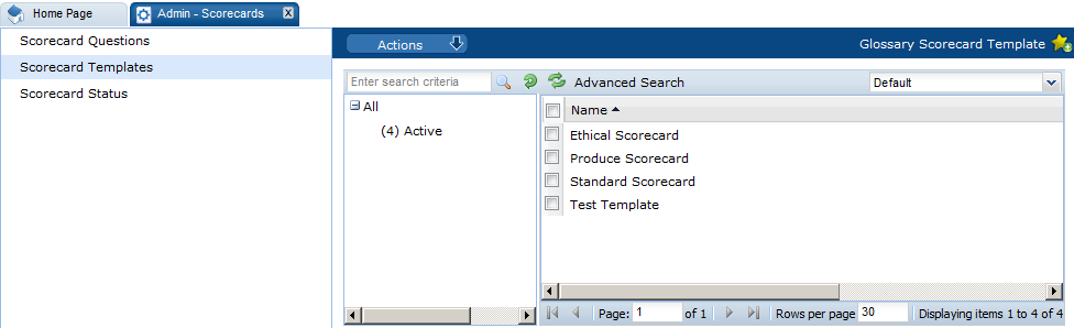

Scorecard Templates
Scorecards provide a means for the retailer to assess their suppliers on an on-going (or ad hoc) basis against a set of predefined criteria. Scorecards are made up of a series of questions which may be answered by the suppler as a self-assessment or completed by the retailer.
Any number of types of scorecard can be configured, with the option to use weighted scoring for the overall grading of suppliers' responses. On completion of a scorecard, the next one can be automatically scheduled based on a predefined periodic or quarterly frequency.
Scorecard templates define the rules that control the behavior of the different types of scorecards. Every scorecard is created from a template which defines the rules for how it behaves within the system, that is, the set of questions and permitted answers, the setting of basic default values, and whether certain fields are used or hidden.
Figure 7-21 Glossary Scorecard Templates Page
Surrounding text describes Figure 7-21 .
To edit a template, select the entry and then select the Edit action. A tab opens in edit mode to enable you to edit the template. For an example of the content, see Figure 7-22.
To create a new template:

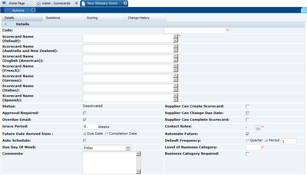

  1. Select the New Scorecard Template action. The New Scorecard Template tab opens.
    Figure 7-22 New Scorecard Template Page
    Surrounding text describes Figure 7-22 .
    Table 7-1 describes the fields in the Details section.
    Table 7-1 New Scorecard Template Fields
    Field Description
    Code
    Enter a unique code for this template. This field is mandatory.
    Scorecard Name
    Enter the name for the template in the default language. This field is mandatory. Enter the translations.
    Status
    Supplier Can Create Scorecard
    If checked, the supplier user can choose to create this type of scorecard. The default is unchecked.
    Supplier Can Change Due Date
    If the supplier can create this type of scorecard and this field is checked, the supplier user may also change the due date of this type of scorecard. The default is unchecked.
    Supplier Can Complete Scorecard
    If checked, the supplier user may choose to complete this type of scorecard. The default is unchecked.
    Approval Required
    If the supplier can complete this type of scorecard and if this field is checked, the retailer user is required to approve this scorecard before the supplier can complete it. The default is unchecked.
    Grace Period
    Enter the number of days or weeks after the scorecard's due date when it becomes overdue.
    Overdue Email
    If checked, an email is automatically generated to the supplier if the supplier has not completed the scorecard by the time it becomes overdue.
    Contact Roles
    Select the roles for which supplier users receive the notifications if the scorecard becomes overdue. The field is mandatory.
    Future Date Derived From
    These fields are used to control the rules for automatically scheduling subsequent scorecards of this type, and when a scorecard becomes overdue.
    Automate Future
    Auto Schedule
    Default Frequency
    Due Day Of Week
    Level of Business Category
    Enter the number of levels of business category to be recorded for this type of scorecard. Set to zero if none are required. This is a mandatory field.
    Business Category Required
    If checked, the business category becomes mandatory when the scorecard is completed.
    Comments
    Enter a comment regarding this template.
  2. Set the questions for this type of scorecard in the Questions tab using the tables of questions for Universal, General, and Ad Hoc Questions:
    • Universal questions are automatically added.
    • General Questions are selected from the glossary of Scorecard Questions.
    • Ad Hoc questions can be entered specifically for this type of scorecard.
    Once the questions have been added, the Refresh Preview action can be used to show the scorecard as it will be presented to the supplier.
  3. Select any scoring rules for this type of scorecard in the Scoring subtab.

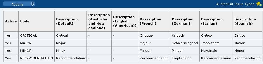

Audit/Visit Issue Types
Audit/visit issue types define the types or levels of non-conformance that can be raised against an audit. An audit/visit template may not be edited once it has been made active; to make any changes it must first be deactivated. The Audit/Visit Issue Types page has the following columns:
  • Set to Yes if the issue type is active.
  • Code for the issue type.
  • Description for the issue type in the default language.
  • Descriptions for each supported language.
Figure 7-27 Audit/Visit Issue Types Page
Surrounding text describes Figure 7-27 .
To edit the list of issue types, select the Edit action. The table opens in edit mode. Only the translated descriptions can be edited.
To add a new issue type, click Add. If the issue type should be set active, check the box in the Active column. The code and description in the default language are mandatory fields.

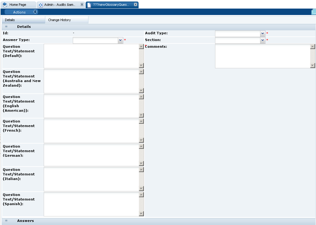

To add a checklist question:
  1. Select the New Checklist Question action. The New Glossary/Question tab opens.
    Figure 7-35 New Checklist Question Page
    Surrounding text describes Figure 7-35 .
    • Id: This is a unique identifier of each question. It is automatically assigned as an incrementing sequence number.
    • Audit Type: Select the type of audit associated with this question from the drop-down list. This field is mandatory.
    • Answer Type: Select the type of answer associated with this question from the drop-down list. This field is mandatory.
    • Section: Select the section of the questionnaire from the drop-down list. This field is mandatory.
    • Question/Text Statement: Enter the question in the default language. This field is mandatory. Enter any translations.
    • Comments: Use this field to enter a comment regarding this checklist question glossary entry.
  3. In the Answers section: The table of Answers is automatically built based on the selected answer type. The table is only applicable for Single Choice and Multi Choice answer types. For more information, see "Checklist Answers."

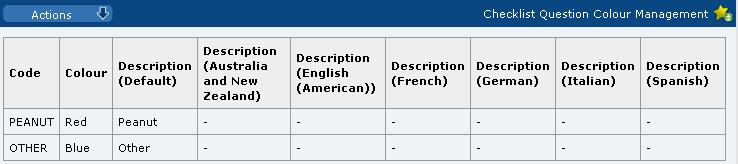

Checklist Question Colour Management
This option is used to define the rules for color-coding within checklists. The system uses this table to apply to present the text in the specific color if it encountered as part of a checklist question.
To edit the list of colors, select the Edit action. The table opens in edit mode. The color and descriptions can be edited.
To add a new color, click Add. A row is added to the table. Enter the code, color, and description in the default language. Enter any translations.
Figure 7-36 Checklist Question Colour Management
Surrounding text describes Figure 7-36 .

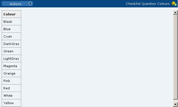

Checklist Question Colours
This option is used to build the list of colors available for use when defining the color-coding rules.
To edit the list of colors, select the Edit action. The table opens in edit mode. To add a new color, click Add.
Figure 7-37 Checklist Question Colours
Surrounding text describes Figure 7-37 .
