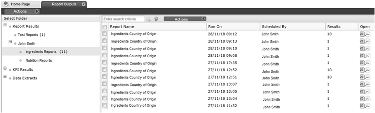

To access the Report Outputs, select the Report Outputs option in the Reports navigation menu.
The report outputs are stored in a library of folders, which can be nested within a hierarchy. The folder is specified when the report is scheduled to run. The folder structure has separate areas for reports, KPIs, and data extracts. The number of entries within each folder is indicated.
Locate a report by navigating through the folder hierarchy, or using the search box. The columns can be sorted in ascending or descending sequence.
Selecting a folder in the left-hand pane shows its report outputs in the right-hand pane with columns for the report name, date and time the report ran, the name of the user who scheduled the report, the number of rows that appear in the report, and links to the actual reports.
The list is filtered to just show reports that the user is permitted to access.
For KPI results, the list shows the schedule description, the run date and time, who scheduled it, and the actual calculated value. All the KPI information is shown in the list, so for KPIs there is no Report Output record to open.

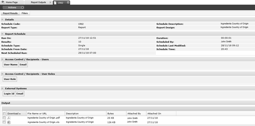

To see the details for a report, double-click the row. A tab opens with the details. You can also open the actual report by clicking the icon in the Open column, then choosing to open or save the file. The page is read-only.

Table 6-1 Report Output Details Page
| Details | Description |
Schedule Code |
The code that uniquely identifies the report's schedule record. |
Schedule Description |
The name of the report's schedule record. |
Report Type |
Whether a report or a KPI. |
Report Design |
The report design that the report is based on. |
Ran On |
The date and time the report ran. |
Duration |
The length of time it took to generate the report. |
Scheduled By |
The name of the user who scheduled the report. |
Schedule Type |
Whether a Single, Recurring, or Periodic schedule. |
Schedule Last Modified |
The date and time the report's schedule record was last modified. |
Schedule From Date |
The first date the report was scheduled to run on. |
Schedule To Date |
The last date the report is scheduled to run on (if any). |
Schedule Time |
The time the report is scheduled to run at. |
Next Scheduled Run |
The next date and time the report is scheduled to run. |
Access Control/Recipients - Users |
A list of any individuals that have been designated recipients (in addition to the user who scheduled the report), showing name and email address. |
A list of any job roles that have been designated recipients (in addition to the user who scheduled the report). All users with the roles will become a recipient of the report (subject to them being a reporting user). |
External Systems |
A list of any external systems that have are permitted to access to the report using the Report Attachment API. |
Output |
A list of the actual report files, held as attachments, with columns showing an icon of the file format, the file name, the report description, the size of the file in bytes, the name of the user who scheduled the report, and the date it was created. |

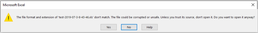

If opening a report in Excel, it may be necessary to manually adjust the columns, rows, and wrapping to suit the layout.Tabular reports are best viewed using Excel, form reports are less suited to the Excel format.
If opening a report in Excel issues a warning message as shown in Figure 6-4, it can be avoided by choosing the MS Excel (xslx) option.
