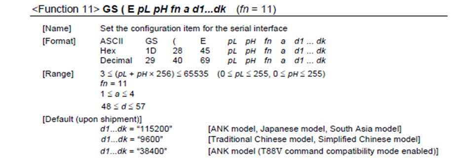

Function 11
This figure shows the function 11 details.
Function 11 — Descriptions
  • Sets the configuration item for the serial interface specified by a to the values specified by d.
a Configuration Item
1
Transmission speed
2
Parity
3
Handshaking
4
Bit length
  • Transmission speed settings (a = 1)
d1...dk Transmission Speed
“2400”
2400 bps
“4800”
4800 bps
“9600”
9600 bps
“19200”
19200 bps
“38400”
38400 bps
“57600”
57600 bps
“115200”
115200 bps
  • Parity settings (a =2)
d1 Parity
48
None
49
Odd
50
Even
  • Handshaking settings (a = 3)
d1 Handshaking
48
DTR/DSR control
49
XON/XOFF control
  • Bit length settings (a = 4)
d1 Bit Length
55
7 bits
56
8 bits
