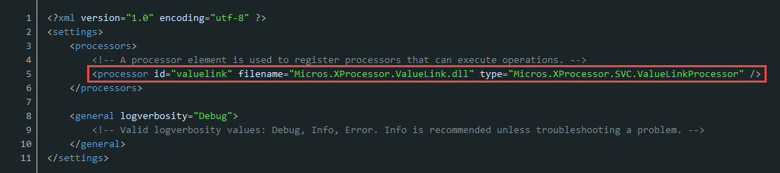

  3. Locate the processor id=”valuelink” entry. The file includes an entry for the ValueLink Processor as shown in the following figure:
    Figure 48-17 XProcessorConfiguration Entry for ValueLink
    This figure shows the XProcessorConfiguration processor id entry for ValueLink, indicated with a red oval surrounding the code.
    If you are using only the ValueLink Processor for gift card service, delete the other entries or use comment marks around them.
