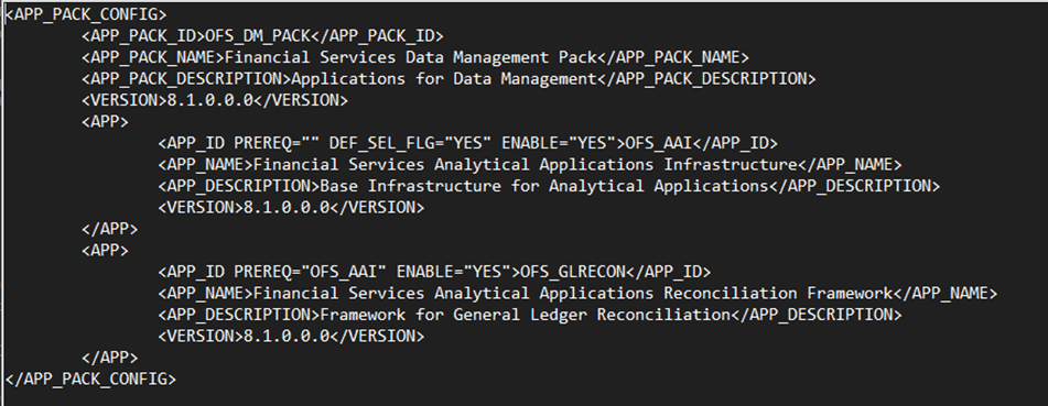

To configure the OFS_DM_PACK.xml file, follow these steps:
1. Navigate to the OFS_DM_PACK/conf directory.
2. Open the OFS_DM_PACK.xml file in a text editor.
3. Configure the OFS_DM_PACK.xml file as mentioned in the following table.
NOTE:
In case of HIVE, rename the following files and then proceed.
· OFS_DM_PACK.xml to OFS_DM_PACK.xml.bkp.
· OFS_DM_PACK.xml.HYBRID.template to OFS_DM_PACK.xml.
Figure 4: Sample OFS_DM_PACK.xml File

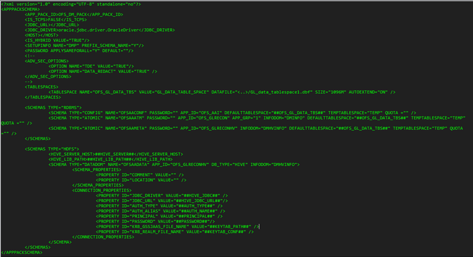

The OFS_DM_SCHEMA_IN.xml file contains details of the various application schemas. Update the values of the various tags and parameters available in this file before executing the Schema Creator Utility.
NOTE:
· This file must be configured if the database is RDBMS.
· If using Hive, rename OFS_DM_SCHEMA_IN.xml to OFS_DM_SCHEMA_IN.xml.bkp and then rename OFS_DM_SCHEMA_BIGDATA_IN.xml.HYBRID.template to OFS_DM_SCHEMA_BIGDATA_IN.xml
· This file need not be configured for an HDFS ONLY installation.
To configure the OFS_DM_SCHEMA_IN.xml file, follow these steps:
1. Log in to the system as a non-root user.
2. Navigate to the OFS_DM_PACK/schema_creator/conf directory.
3. Edit the OFS_DM_SCHEMA_IN.xml file using a text editor and configure the values as mentioned in the following table.
4. Save the file.
Figure 5: Sample OFS_DM_SCHEMA_IN.xml File

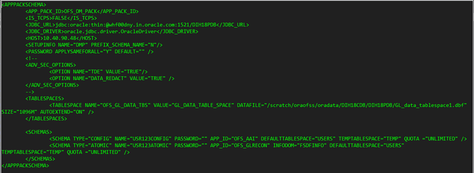

<ADV_SEC_OPTIONS>
<OPTION NAME="TDE" VALUE="FALSE"/>
<OPTION NAME="DATA_REDACT" VALUE="FALSE" />
</ADV_SEC_OPTIONS>
<TABLESPACES>
<TABLESPACE NAME="OFS_AAI_TBSP_1" VALUE="TS_USERS1" DATAFILE="/scratch/ora19c/app/oracle/oradata/OFSPQA19CDB/ts_users1.dbf" SIZE="500M" AUTOEXTEND="ON" ENCRYPT="ON" />
<TABLESPACE NAME="OFS_AAI_TBSP_2" VALUE="TS_USERS2" DATAFILE="/scratch/ora19c/app/oracle/oradata/OFSPQA19CDB/ts_users2.dbf" SIZE="500M" AUTOEXTEND="ON" ENCRYPT="ON" />
</TABLESPACES>
<SCHEMAS>
<SCHEMA TYPE="CONFIG" NAME="ofsaaconf" PASSWORD="" APP_ID="OFS_AAI" DEFAULTTABLESPACE="##OFS_AAI_TBSP_1##" TEMPTABLESPACE="TEMP" QUOTA="unlimited"/>
<SCHEMA TYPE="ATOMIC" NAME="ofsaaatm" PASSWORD="" APP_ID="OFS_AAAI" DEFAULTTABLESPACE="##OFS_AAI_TBSP_2##" TEMPTABLESPACE="TEMP" QUOTA="unlimited" INFODOM="OFSAAAIINFO"/>
</SCHEMAS>
For configuring Schema Creator Utility for OFS Reconciliation Framework on Hive, navigate to /OFS_DM_PACK/schema_creator/conf and rename the following files (for Hive based installation use only the HYBRID template):
· OFS_DM_SCHEMA_IN.xml to OFS_DM_SCHEMA_IN.xml.bkp
· OFS_DM_CFG.dat to OFS_DM_CFG.dat.bkp
· OFS_DM_SCHEMA_BIGDATA_IN.xml.HYBRID.template to OFS_DM_SCHEMA_BIGDATA_IN.xml
· OFS_DM_CFG.dat.HYBRID.template to OFS_DM_CFG.dat
Fill the pack specific schema details in the OFS_DM_SCHEMA_BIGDATA_IN.xml file before executing the utility.
For more information on the XML file, see the Configure the OFS DM_SCHEMA_BIGDATA_IN.xml file.
You can configure the following types of schemas:
· CONFIG: This schema holds the entities and other objects required for OFSAA setup configuration information.
NOTE:
There can be only one CONFIG schema per OFSAA instance. This schema is created only in RDBMS.
· METADOM: This schema holds the OFSAA Reconciliation Framework metadata information. One METADOM schema is attached to one information domain.
NOTE:
There can be multiple METADOM schemas per OFSAA Instance. This schema is created only in RDBMS. It has only platform entities that hold the metadata details. However, it does not hold the data model entities.
· DATADOM: This schema holds data model entities. One DATADOM schema is attached to one information domain.
NOTE:
There can be multiple DATADOM schemas per OFSAA Instance.
Configure this file only if installing OFS Analytical Applications Reconciliation Framework Pack for HDFS-ONLY target.
This file need not be configured for an RDBMS-ONLY target installation.
The OFS_DM_SCHEMA_BIGDATA_IN.xml file contains details of the various application schemas. Update the values of the various tags and parameters available in this file before executing the Schema Creator Utility.
To configure the OFS_DM_SCHEMA_BIGDATA_IN.xml file, follow these steps:
3. Rename the OFS_DM_SCHEMA_BIGDATA_IN.xml.HYBRID.template file to OFS_DM_SCHEMA_BIGDATA_IN.xml.
4. Edit the OFS_DM_SCHEMA_BIGDATA_IN.xml file using a text editor and configure the values as mentioned in the following table.
5. Save the file.
NOTE:
On successful execution of the utility, the passwords entered in the OFS_DM_SCHEMA_IN.xml file are nullified.
NOTE:
If there are any errors during the script execution, reconfigure the OFS_DM_SCHEMA_IN.xml file and execute the utility. This regenerates the scripts with the updated information.
NOTE:
For Java 8, edit the VerInfo.txt file in the path /OFS_DM_PACK/OFS_AAI/bin/ to modify the value for property JAVA_VERSION to 1.8 and save the changes.
Figure 6: Sample OFS_DM_SCHEMA_BIGDATA_IN.xml File

1. Edit the file /OFS_DM_PACK/schema_creator/conf/OFS_DM_SCHEMA_IN.xml in a text editor. See the Configure the OFS_DM_SCHEMA_IN.xml File section for values to modify in the XML file.
2. Execute the utility with the -s option. Example: ./osc.sh s -o

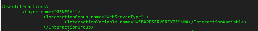

<Layer name="GENERAL"> |
InteractionGroup name="WebServerType" |
WEBAPPSERVERTYPE (Mandatory) |
Identifies the web application server on which the OFSAA Infrastructure web components would be deployed. Set the following numeric value depending on the type: · Apache Tomcat = 1 · IBM WebSphere Application Server = 2 · Oracle WebLogic Server = 3 For example, <InteractionVariable name="WEBAPPSERVERTYPE">3</InteractionVariable> |

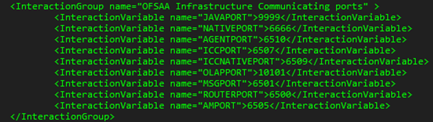

InteractionGroup name="OFSAA Infrastructure Communicating ports" |
Note: These ports are used internally by the various OFSAA Infrastructure services. The default values mentioned are set in the installation. To specify a different value, update the parameter value accordingly, and ensure the port value is in the range of 1025 to 65535 and the respective port is enabled. |
JAVAPORT (Mandatory) |
9999 |
NATIVEPORT (Mandatory) |
6666 |
AGENTPORT (Mandatory) |
6510 |
ICCPORT (Mandatory) |
6507 |
ICCNATIVEPORT (Mandatory) |
6509 |
OLAPPORT (Mandatory) |
10101 |
MSGPORT (Mandatory) |
6501 |
ROUTERPORT (Mandatory) |
6500 |
AMPORT (Mandatory) |
6505 |

a. RDBMS: Edit the OFS_DM_SCHEMA_IN.xml to set the appropriate attribute values. Optionally, you can include INFODOM = <Infodom Name> in the OFS_DM_SCHEMA_IN.xml file. If not specified, a default INFODOM name is generated. See Configure the OFS_DM_SCHEMA_IN.xml File for more details.
b. Hive-Hybrid: Rename the OFS_DM_SCHEMA_IN.xml to OFS_DM_SCHEMA_IN.xml.bkp and then rename OFS_DM_SCHEMA_BIGDATA_IN.xml.HYBRID.template to OFS_DM_SCHEMA_BIGDATA_IN.xml. Edit the OFS_DM_SCHEMA_BIGDATA_IN.xml to set the appropriate attribute values. See Configure the OFS DM_SCHEMA_BIGDATA_IN.xml file for more details.

a. RDBMS: Edit the OFS_DM_PACK.xml to enable product licenses. Set the attribute ENABLE=YES of <APP_ID> tag to license the app.
b. Hive-Hybrid: In case of Hive-Hybrid based installation for OFSAA Reconciliation Framework, rename the OFS_DM_PACK.xml to OFS_DM_PACK.xml.bkp and then rename OFS_DM_PACK.xml.HYBRID.template to OFS_DM_PACK.xml. Now edit the OFS_DM_PACK.xml to enable the product licenses. Update the attribute ENABLE=YES/NO for licensing the app in the pack.
c. If any application mentions OFS_AAAI as PREREQ in the <APP_ID> tag, set the attribute ENABLE=YES for OFS_AAAI.
