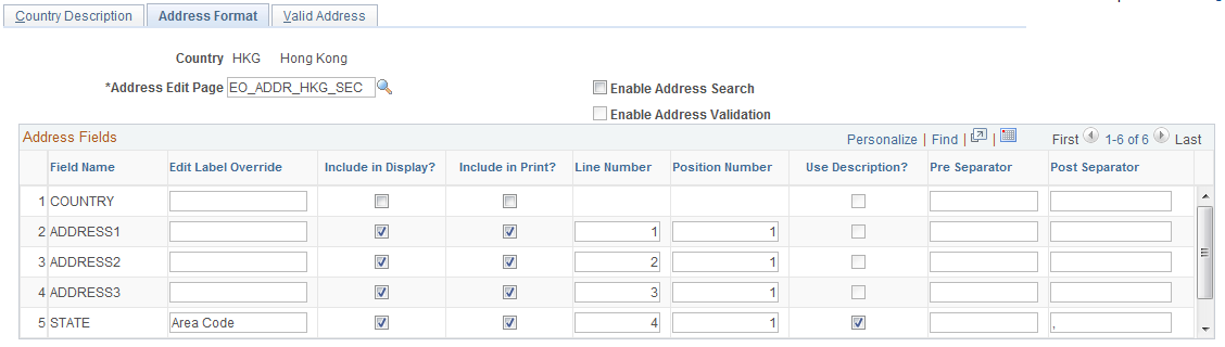

Image: Address Format page
This example illustrates the fields and controls on the Address Format page. You can find definitions for the fields and controls later on this page.
Address Format page
Use this page to set up the three main aspects of the address: editing, displaying, and printing.

Address Edit Page
Displays the secondary page used for editing the address. You can create a new secondary page using Application Designer. On the new address secondary page you create, use page fields from the DERIVED_ADDRESS record definition. You then need to add a secondary page control to ADDRESS_SBP pointing to your new secondary page. Once you complete these steps, the secondary page is accessible in this field.
Enable Address Search
Select to enable users to search for a valid value. Selecting this check box enables the Used in Search column and the Valid Address page.
The system default is to leave this check box clear.
Enable Address Validation
Available only when Enable Address Search is selected. Select to ensure validation of all values selected. When selected, users must select a value from the search list. If this check box is clear, users can select from the search list or enter a new value.
Search Limit
Enter a numeric value to limit the number of search results.
This option enables you to limit the search results retrieved during Address Search.
Field Name
Displays the field options available for the address page.
Edit Label Override
(Optional) Enter an alternative label for the field. The new label is used when prompting for the field. You can customize address formats so that they conform to the address requirements of each location. For instance, for a U.S. address, you would change the Postal field to read ZIP Code.
Keep in mind the distinctions between county and state:
  • County: The tertiary geopolitical region within a state; the level after country and state. In the UK, the level of state is called a county; you would enter such counties in the State field.
  • State: The secondary geopolitical region within a country; a state in the U.S., a province in Canada, a county in the UK, and a department in France.
Used in Search
Available only when you select the Enable Address Search check box. Select the fields you want users to be able to search on.
Include in Display
Select to have the PeopleSoft system include this field when an address appears in read-only mode. Clear this check box for specific fields if your organization wants to display addresses in a format that is different than the appearance of the address during data entry.
Include in Print
Select to print the field when printing.
Line Number and Position Number
Enter the physical location of the fields for displaying and printing. The line number and position number control the field order in the Address Edit page.
The Line Number field specifies the line in which the address field should appear on the page. If there are more than two fields on the same line, then the Position Number field is used to resolve the conflict.
Use Description
Select to display the description for the field value. For example, for addresses in Japan, select this option to display the description of the state rather than the state code, since the code is numeric.
Pre Separator and Post Separator
Enter characters to be used surrounding the address field. For example, in the United States, a comma generally follows the city name, such as in San Francisco, CA. In India, there are parentheses around the postal code, for example (123).
