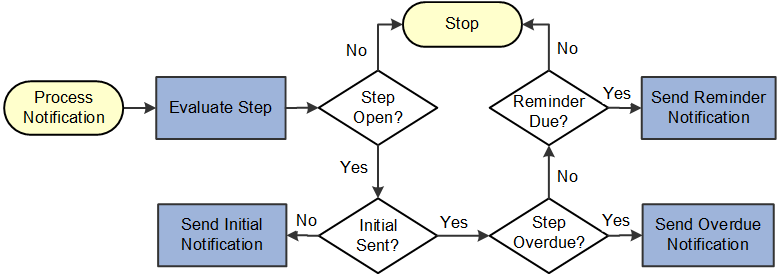

Initial Notification Priority and Considerations
When you set the category to use Initial as the priority notification, the system will process notifications in this order:
  1. Initial
  2. Overdue
  3. Reminder
Image: Process flow when Initial notifications are set as the priority
When an activity guide is initiated or a batch process for notification is run, the system will first evaluate the steps to see which are open.
  • When an activity guide is first initiated, the system checks to see if steps are open and, if so, sends the initial notification.
  • When a process notification is run, the system first checks for open steps and then checks to see if an initial notification has been sent. If it has not been sent, the initial notification is sent to the assignee. If an initial notification has already been sent, then the system checks to see if there are overdue steps. If the step is overdue, the overdue notification is sent. If it is not overdue, then the system checks to see if it is time to send a reminder notification, as specified on the template Activity Guide Composer - Notifications Page.
Keep the following in mind when setting up notifications when you select Initial as the first priority:
  • The system will not send an initial notification to the initiator of the instance. Initial notifications are sent only to assignees who are not the initiators of the instance and sent when their step is open and ready for them to complete.
  • Initial notification is sent only once for each assignee.
  • If the steps are overdue and the initial notification was not sent, the system will first send the initial notification.
  • If initial notification has been sent and the step is not overdue but is due for a reminder, the system will send a reminder notification.
  • If the steps are overdue and initial notification was sent, then the system will send an overdue notification.
  • The system will not send duplicate notifications to an assignee on the same day for the same instance of an activity guide template.

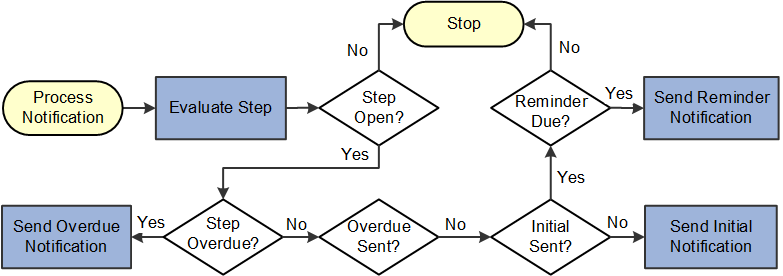

Overdue Notification Priority and Considerations
When you set the category to use Overdue as the priority notification, the system will process notifications in this order:
  1. Overdue
  2. Initial
  3. Reminder
Image: Process flow when Overdue notifications are set as the priority
  • When an activity guide is first initiated, the system checks to see if steps are open and, if so, then check to see if a step is overdue. If it’s not overdue, it sends the initial notification.
  • When a notification process is run, the system first checks for open steps and then checks to see if any are overdue. If the step is overdue, and the notification hasn’t been sent, the overdue notification is sent at this time. If it is not overdue, the system will then check to see if the initial notification was sent to the assignee and sends it if it hasn’t already. If an initial notification has already been sent, then the system checks to see if it is time to send a reminder notification, as specified on the template Activity Guide Composer - Notifications Page.
Keep the following in mind when setting up notifications when you select Overdue as the first priority:
  • The system will not send an initial notification to the initiator of the instance. Initial notifications are sent only to assignees who are not the initiators of the instance and send when their step is ready for them to complete.
  • If no overdue steps are found the first time for an assignee, then the initial notification is sent. Initial notification is sent only once for each assignee.
  • If the steps are overdue when they become open, the system will send the overdue notification. Initial notification only be sent if the step is not overdue.
  • Once the overdue notification is sent, the system will check if the step is due for reminder.

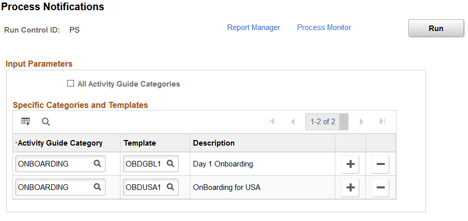

Use the Process Notifications page (AGC_PRCS_NOTIF_RC) to process a batch or individual template notifications.
Image: Process Notifications Page
This example illustrates the fields and controls on the Define Notifications page.
Processes should be run on a regular basis to capture any new or upcoming notifications that need to be sent.
Field or Control
Definition
All Activity Guide Categories
Select to indicate that the system should run and process notifications for all templates. By selecting this check box, the remaining fields on the page become unavailable.
Activity Guide Category
Select the categories for templates for which you want to run and process notifications.
Template
Enter the templates for which you want to run and process notifications. If you do not enter a template, notifications will be generated for all templates within the category specified.
