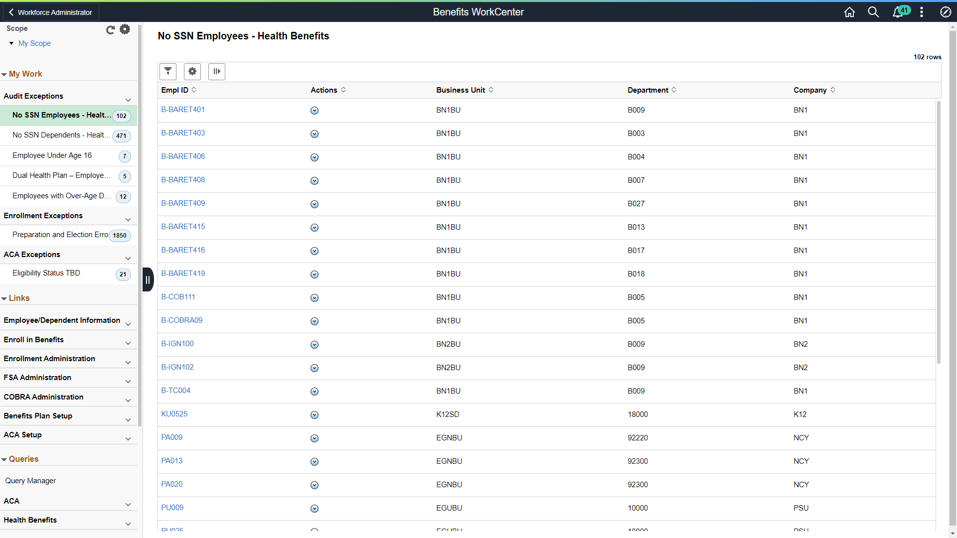

The WorkCenter page is divided into two areas: the navigation panel on the left and the transaction panel on the right.
Left Panel
The navigational panel on the left contains group boxes with links to specific transactions, menu components and other content. These group boxes are:
  • My Work: This group box contains three collapsible sections, Audit Exceptions, Enrollment Exceptions and ACA Exceptions. For more information, see Understanding the My Work Group Box.
  • Links: For more information, see Understanding the Links Group Box.
  • Queries: For more information, see Understanding the Queries Group Box.
  • Reports/Processes: For more information, see Understanding the Reports/Processes Group Box.

Right Panel
The transaction panel on the right is where the selected transaction result or component (work item) is displayed.
By default, the No SSN Employees–Health Benefits page appears when you first access the WorkCenter. You can change this default setting of the WorkCenter on the Personalize Page (Fluid).
You can also filter and personalize the output based on your requirements. Use the Refine Filter Criteria Page to select one or more criteria to narrow the search result. The Filter icon appears green when filters have been applied to your search. Use the Personalized Output Page to modify the position of columns and to select the columns to be displayed as default for each work item. For more information, see Setting Up and Personalizing PeopleSoft Fluid WorkCenters.
You can download grid data to .xls file.

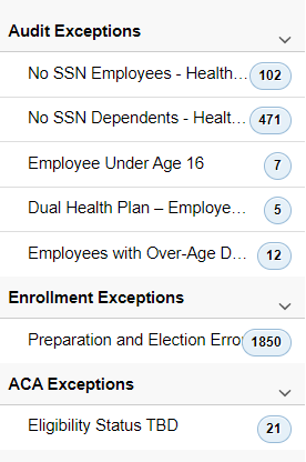

The My Work group box provides Benefits work item links for exceptions in these group sections:
  • Audit Exceptions
  • Enrollment Exceptions
  • ACA Exceptions
PeopleSoft provides these sample exceptions which you can use, modify or clone to suit your organization's business needs.
Image: My Work Group Box
This example illustrates the fields and controls on the My Work Group Box.
Benefits WorkCenter - My Work Group Box
Note: Work item links are grayed out if no data is available for display.
Audit Exceptions
The PeopleSoft-delivered Audit Exceptions link provides reports of exceptions similar to what is provided in BEN733.SQR. These include:
  • No SSN Employees–Health Benefits
  • No SSN Dependents–Health Benefits
  • Employees Under Age 16
  • Dual Health Plan–Employee/Dependent
  • Employees with Over-Age Dependents

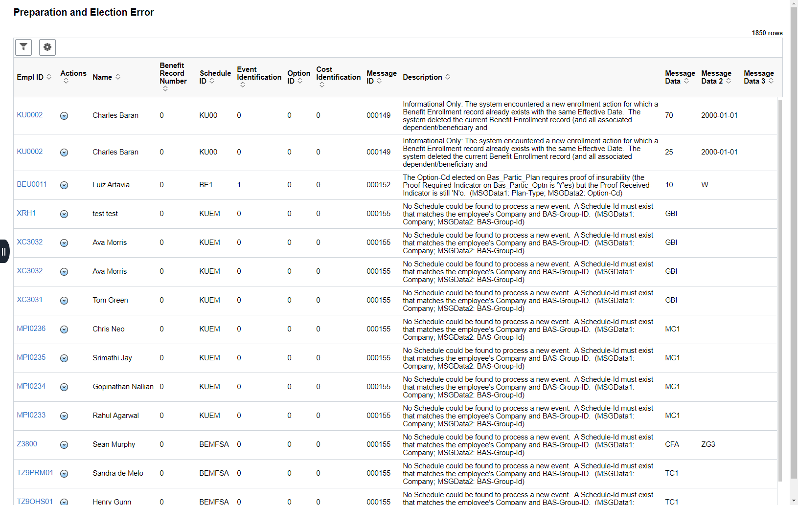

The PeopleSoft-delivered Enrollment Exceptions link provides a report (Preparation and Election Error) to fetch all processing messages similar to what is in the Benefits Administration Processing messages.
ACA Exceptions

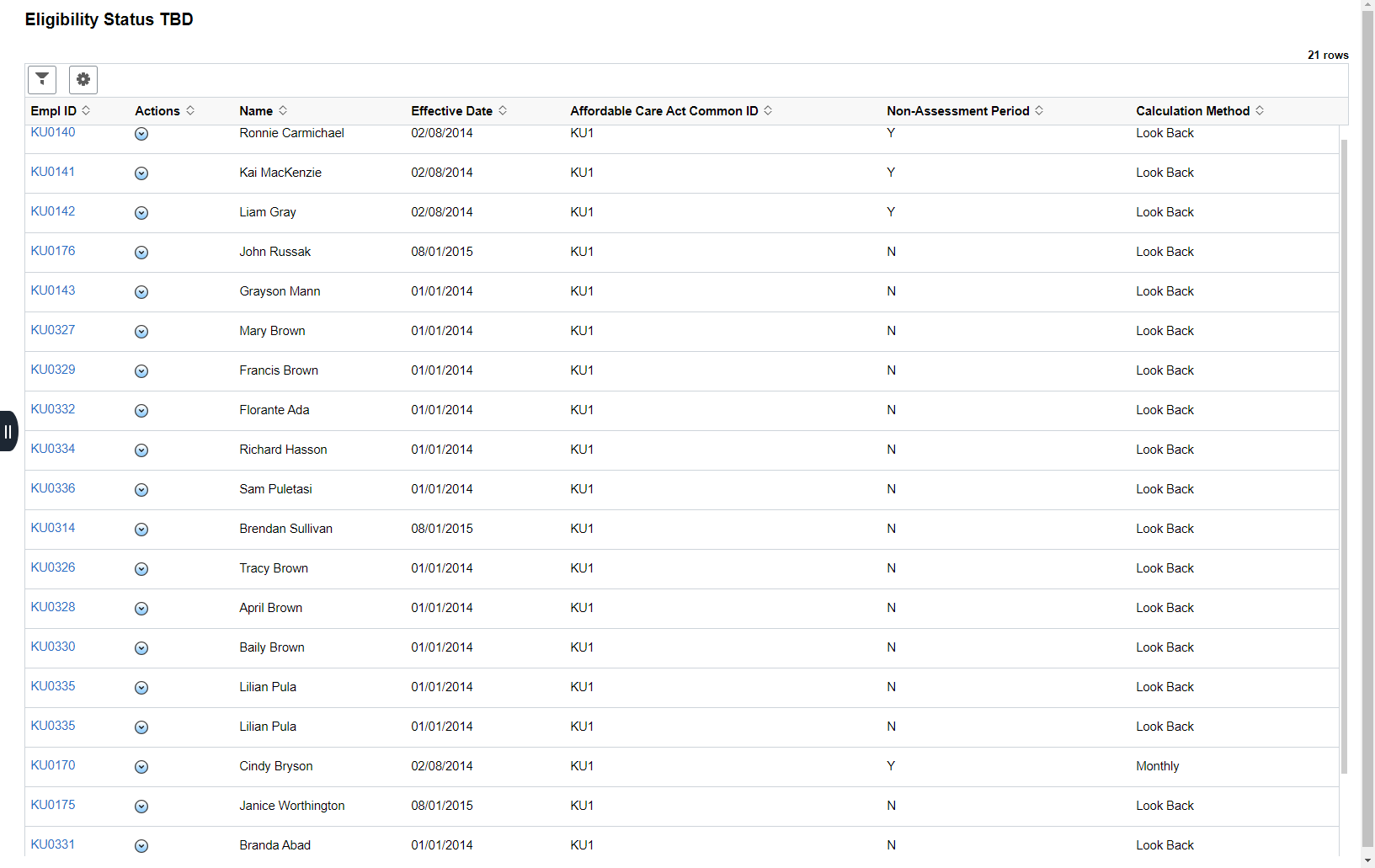

The PeopleSoft-delivered ACA Exceptions link provides an audit report (Eligibility Status TBD) that fetches any ACA Employee who does not have an ACA Eligibility Status defined.

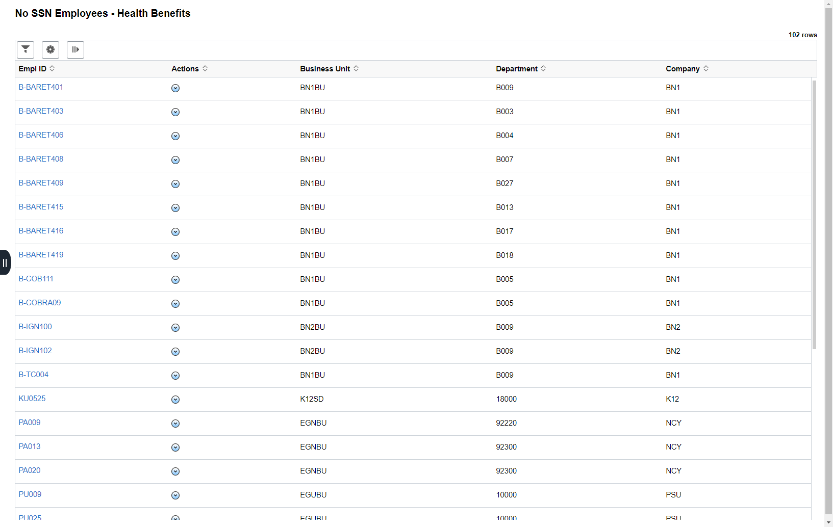

Use the No SSN Employees–Health Benefits page to get a report of health benefits of the U.S. employees with missing National IDs.
Image: No SSN Employees–Health Benefits Page
This example illustrates the fields and controls on the No SSN Employees–Health Benefits Page.
No SSN Employees - Health Benefits
Field or Control
Definition
Empl ID
Select the Empl ID link to access the Modify a Person page, to change the Social Security Number (SSN).
Actions
Select Actions to access the related Actions menu, to modify personal information and benefits summary.

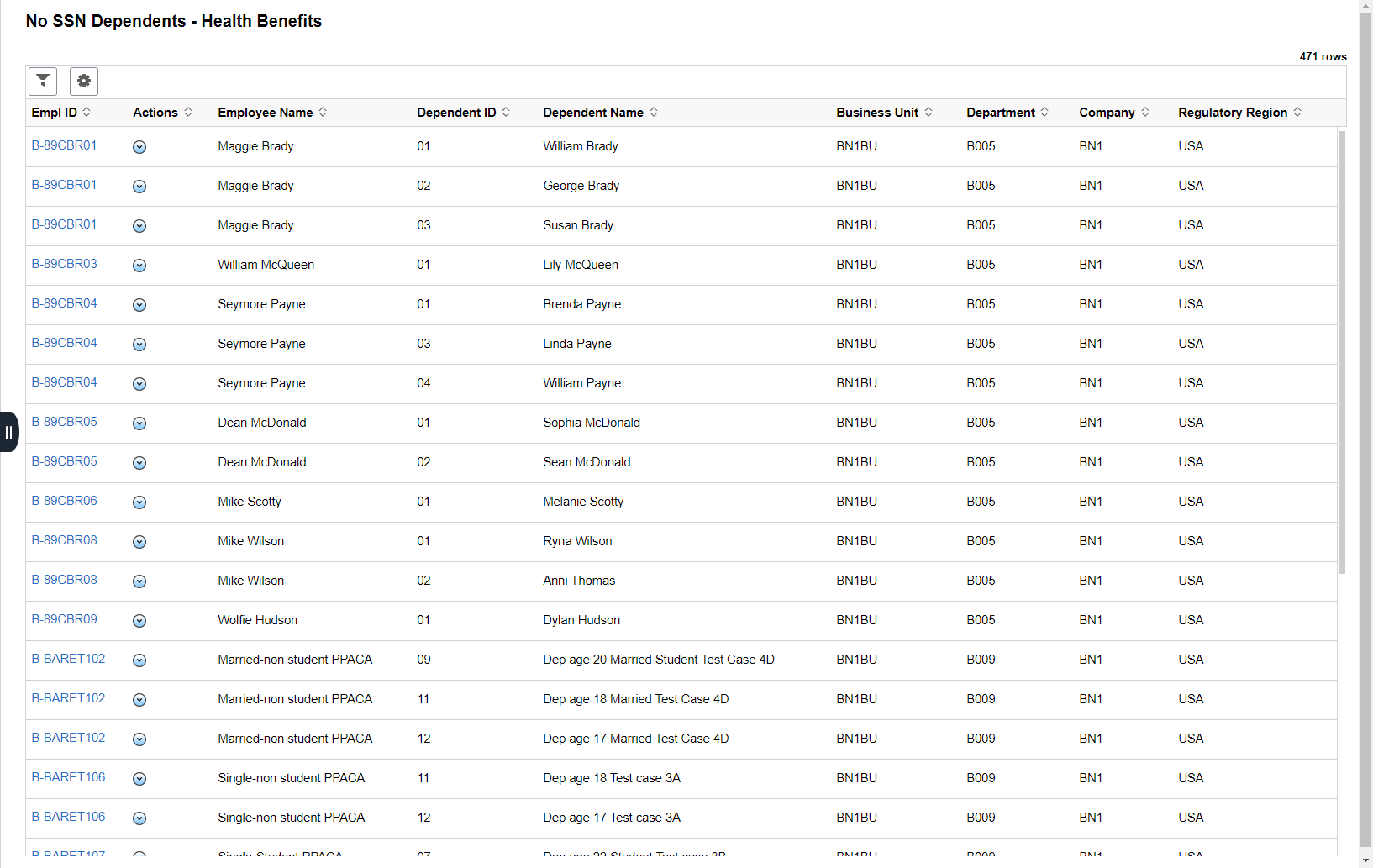

Use the No SSN Dependents–Health Benefits page to get a report of the U.S. health benefits dependents with missing National IDs.
Image: No SSN Dependents–Health Benefits Page
This example illustrates the fields and controls on the No SSN Dependents–Health Benefits Page.
No SSN Dependents - Health Benefits

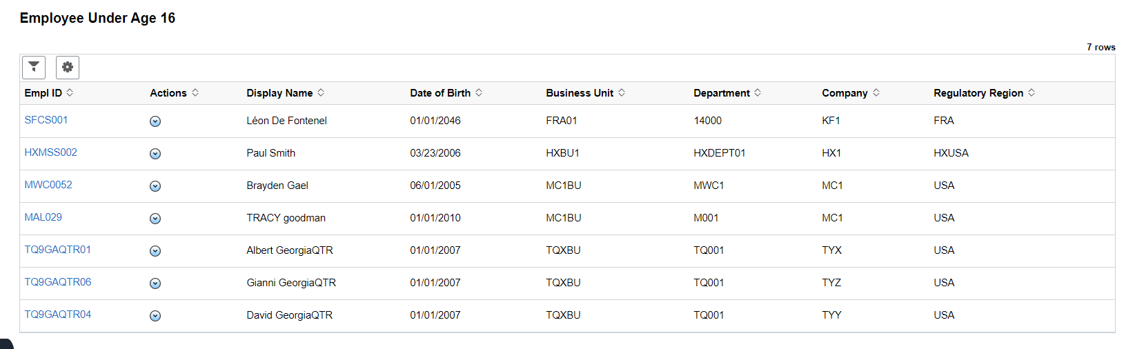

Use the Employee Under Age 16 page to get a report of employees, like interns, under the age of 16, or to pull up incorrect records where date of births were entered wrong.
Image: Employee Under Age 16 Page
This example illustrates the fields and controls on the Employee Under Age 16 Page.

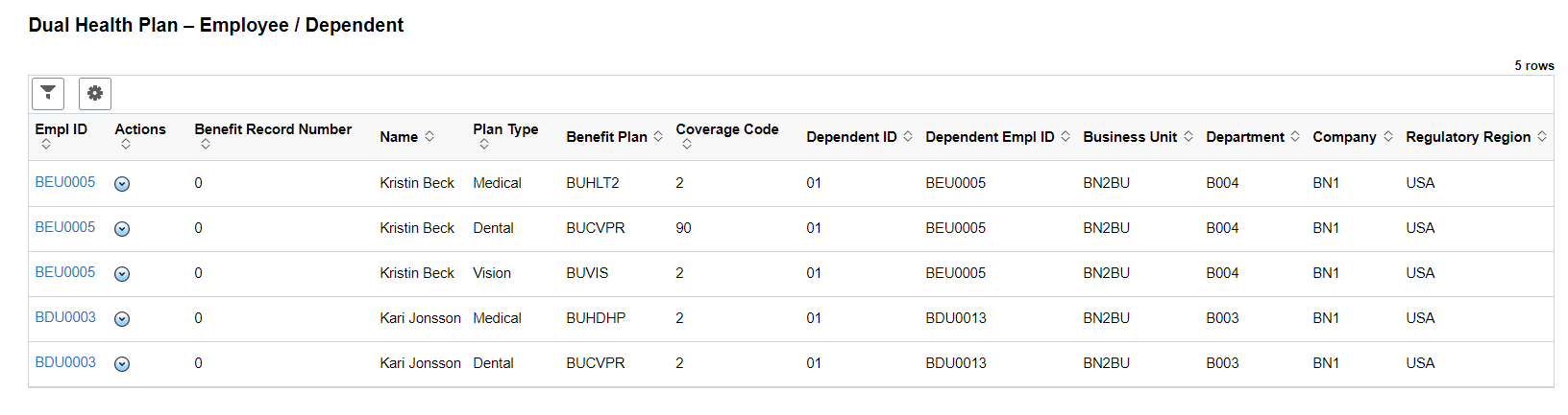

Use the Dual Health Plan–Employee/Dependent page to fetch a report to find out if the employee and spouse or dependent work in the same company and if both are enrolled in health plans.
Image: Dual Health Plan–Employee/Dependent Page
This example illustrates the fields and controls on the Dual Health Plan–Employee/Dependent Page.
Dual Health Plan - Employee Dependent

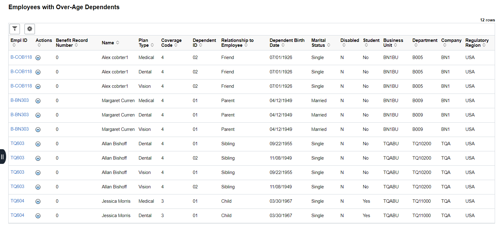

Use the Employees with Over-Age Dependents page to get a list of dependents of employees who are over the age as based on the Dependent Rules Table Page.
Image: Employees with Over-Age Dependents Page
This example illustrates the fields and controls on the Employees with Over-Age Dependents Page.
Use the Preparation and Election page to get reports on errors appearing during preparation and election of benefit plans.
Image: Preparation and Election Error Page
This example illustrates the fields and controls on the Preparation and Election Error Page.
Use the Eligibility Status TBD page to get a report on the employees with the ACA eligibility status as “To be Determined”.
Image: Eligibility Status TBD Page
This example illustrates the fields and controls on the Eligibility Status TBD Page.
