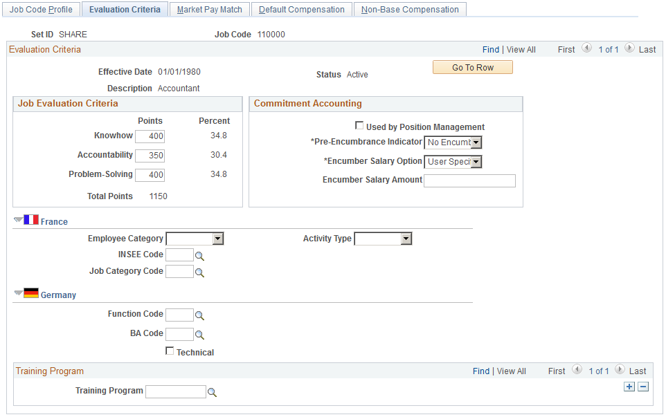

Evaluation Criteria Page
JOBCODE_TBL2_GBL
Assign points to certain job evaluation criteria. You can use this information to rank job codes in your company and to assess salary grades, steps, and exempt and nonexempt categories for personnel.

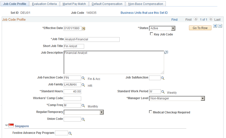

Use the Job Code Profile page (JOBCODE_TBL1_GBL) to add new job codes to the system and define job family, compensation, and regulatory information for each job code.
Image: Job Code Profile page (1 of 5)
This example illustrates the fields and controls on the Job Code Profile page (1 of 5). You can find definitions for the fields and controls later on this page.
Image: Job Code Profile page (2 of 5)
This example illustrates the fields and controls on the Job Code Profile page (2 of 5). You can find definitions for the fields and controls later on this page.

Field or Control
Definition
Job Code
A unique code that you associate with a specific job in your organization.
Key Job Code
Select this check box if it is a key job for your organization's succession planning.
(USF) Occupation Series, Official Posn Title Code (official position title code), and Organization Posn Title Cd (organization position title code)
Select from the list. This fields are available on the federalized database for users authorized to view federal information.
Job Function Code
Select the code that best categorizes the job by function, such as administrative, legal, or management.
Job Subfunction
Select the code that best categorizes the job's subfunction.
Job Family
Select a job family to categorize a job code into a more general grouping. For example, you might group a trust analyst and an operations analyst into a job family called Analyst.
Standard Hours
Enter the default number of hours in a standard work period for this job. The Standard Hours value that you enter on this page becomes the default for all workers who are associated with this job code. You can modify the standard hours for an worker on the worker's Job Data pages (JOB_DATA).
The value that you assign for Standard Hours must fall between the minimum standard hours and the maximum standard hours defined in the Primary Permission List Preferences table. If no minimum standard hours and maximum standard hours are defined on the Primary Permission List Preferences table, the system uses the values on the Installation table.
Standard Work Period
Select the time period in which workers must complete the standard hours. Maintain these values in the Frequency Table page (FREQUENCY_TBL).
The system uses the annualization factor of the standard work period in combination with the standard hours to calculate FTE (full-time equivalency).
See PeopleSoft: Enterprise Components.
Workers' Comp Code (Workers' Compensation code)
Enter a code to specify the workers' compensation plan to which this job code belongs.
Manager Level
Select the level of management associated with the employee.
Comp Freq (compensation frequency)
Select the frequency in which the compensation is quoted. The default value is the frequency that you specified on the Installation table
Medical Checkup Required
Select if this job code requires a onetime medical checkup when the worker is hired into the job.
Note: If you're tracking a German workforce, also indicate whether the job requires ongoing medical surveillance in the Job Code Profile section for local German functionality, especially if the worker comes into contact with hazardous conditions or materials on the job.
Union Code
If you're defining a job code that is associated with a union, select a union code. Define union codes as a part of the Manage Labor Relations business process in PeopleSoft Human Resources.
Updated On
Last updated timestamp for this jobcode.
Updated By
Last updated by user information
(SGP) Singapore
Field or Control
Definition
Festive Advance Pay Program
If you set up one or more festive advance pay programs that each cover all the festive holiday types (using the Festive Advance Pay Program page), associate a default festive advance pay program with a specific job code here.
The program details for each festive holiday can be the same or different from each other. One pay program can have many festive holiday types and can be associated with many combinations of earnings elements, deduction elements, and probation periods.
This job code, in conjunction with the ethnic group and religion, are responsible for the defaults on the FA Employee Details (SGP/MYS) page.

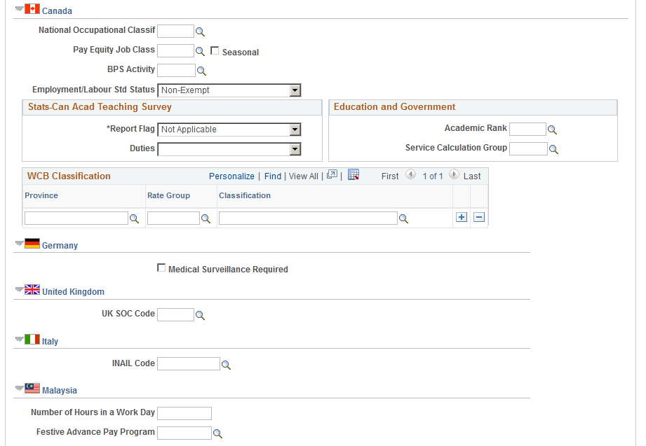

(CAN) Canada
Field or Control
Definition
National Occupational Classif (National Occupational Classification)
Select a Canadian National Occupation classification code.
Seasonal
Select if the job is seasonal.
BPS Activity (Business Payrolls Survey activity)
If you are participating in the Statistics Canada Business Payrolls Survey, select the job code's business activity.
Employment/Labour Std Status (employment and labour standards status)
Choose whether this job is Exempt or Non-Exempt according to the provincial Employment Standards Act or Labour Standards Act. This value becomes the default for the Employment/Labour Std Status field on positions that are associated with this job code and on worker job records that are associated with this job code.
Report Flag
Select the Both Surveys, Full-Time Survey, Part-Time Survey, or Not Applicable to indicate whether the job code is to be reported in one of the Statistics Canada Academic Teaching Surveys.
This field is for Canadian higher education degree-granting institutions only.
Duties
Indicate whether the duties of the job code consist of Research, Teaching Only, or Teaching & Othr Responsibility (teaching and other responsibilities). This field is required if you selected an option other than Not Applicable in the Report Flag field.
Academic Rank
Select the academic rank that is associated with this job code. Set up values for this field on the Academic Rank Page.
Province
Enter the province that you report to when you perform WCB (Workers' Compensation Board) reporting for this job code. WCB reporting in Canada is always done at the provincial level; there is no national WCB level.
Rate Group
Select a rate group for this job code. Each industry is assigned a rate group for assessment purposes, based on the type of industry and the accident/injury level in that industry in that province.
Classification
Select a WCB classification for this job code. The classification indicates the industry that applies to this job code.
Note: The rate groups and classifications can be obtained from your provincial WCB. The rates and rate codes may vary from province to province.
(DEU) Germany
Field or Control
Definition
Medical Surveillance Required
Select if ongoing medical surveillance is required for this job code. For instance, some jobs require workers to be in contact with hazardous materials, and health and safety regulations require that workers receive periodic medical checkups as long as they are in that job.
(GBR) United Kingdom
Field or Control
Definition
UK SOC Code (United Kingdom Standard Occupational Classification code)
Enter the appropriate UK Standard Occupational Classification code. This code is required for Northern Ireland Fair Employment reporting.
(ITA) Italy
Field or Control
Definition
INAIL Code
Select the job code's INAIL code from the list of options. This code classifies jobs according to the level of risk that is associated with the job and the related insurance that is required by the employer.
(MYS) Malaysia
Field or Control
Definition
Number of Hours in a Work Day
Enter the standard workday hours that are used for payroll and leave calculations.

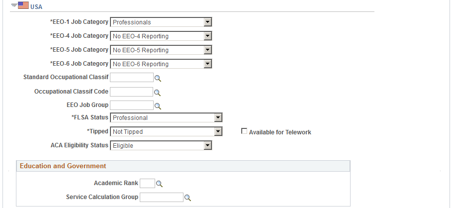

(USA) USA
Field or Control
Definition
EEO Job Categories
Select a job category. The EEO-1 code is also the Federal Occupation Category (FOC).
To retrieve valid job codes for EEO-1 reporting, select a EEO-1 job category that is not equal to No EEO-1 Reporting.
Standard Occupational Classif (Standard Occupational Classification)
If your company has operations in Alaska, you can enter a Standard Occupational Classification (SOC) code for use in unemployment insurance reporting. You enter U.S. SOC codes in the U.S. Standard Occupational Classification Table.
EEO Job Group
To further classify the job categories, enter the EEO job group to which this job belongs.
FLSA Status (Fair Labor Standards Act status)
Enter a code to indicate whether this job is exempt or nonexempt according to the FLSA. This value becomes the default for the FLSA status on all worker job records that are associated with this job code. Example values are Administrative, Executive, Nonexempt, and Professional.
Available for Telework
Select if this location allows workers to work remotely.
ACA Eligibility
Enter the default ACA eligibility for this job code. This value will be provided by default to the employee’s record, where it can then be overwritten, if needed. Valid values are:
  • Always Eligible: For example, a salaried full-time employee who is always eligible for benefits.
  • Eligible: An employee whose average hours is equal to or above the minimum hours/week or hours/month so that the employee is considered Benefits Full Time. The employee is eligible for benefits
  • Excluded: For example, volunteer employees, student employees, members of religious orders.
  • Ineligible: An employee whose average hours is below the minimum hours/week or hours/month so that the employee is considered Benefits Part Time. The employee is not eligible for benefits.
  • To be determined: Unable to determine whether the employee is Benefits Part-Time or Full-Time. Human Resources needs to review and determine the employee’s ACA Eligibility status.
Note: When a new hire is entered in the system, the value that is set in the respective Job Code record is passed to Benefits. Therefore, you should analyze all Job Code table data for your organization and set the appropriate value for this field.

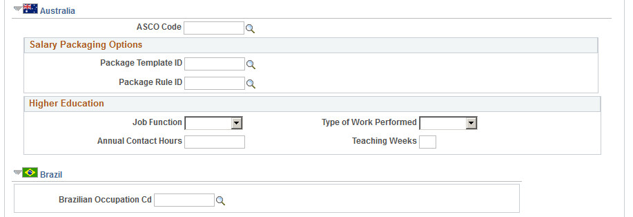

(AUS) Australia
Field or Control
Definition
ANZSCO Code (Australian and New Zealand standard classification of occupation code)
Select the ANZSCO code.
Package Template ID and Package Rule ID
Use these fields to associate this job code with the package rules and templates you set up as part of salary packaging for Australia. These IDs act as defaults for this job in employee salary packaging modeling. These fields are also available on the Position Table; the Position Table fields take precedence over the fields here.
By associating templates and rules with job codes, package components are automatically assigned to workers during the package modeling process. Using templates can save time by ensuring that you use the correct template and rule when modeling.
Note: You set up package templates on the Package Template page. You set up package rules on the Package Rule page.
(AUS) Higher Education
These fields are available when you select the Australian Public Service box on the Country Specific page of the Installation component.
Field or Control
Definition
Job Function
Select the default job function for the organization.
Type of Work Performed
Select the default type of work performed for the organization.
Annual Contact Hours
Enter the number of contact hours. This depends on the type of work performed. See "Determining Contact Hours" to calculate this value.
Teaching Weeks
Enter the default number of teaching weeks.
(BRA) Brazil
Field or Control
Definition
Brazilian Occupation Cd (Brazilian occupation code)
Enter the appropriate Brazilian Code of Occupation (CBO - Código Brasileiro de Ocupações) from the official table. If this job code is created for the Brazilian country extension, you must specify a Brazilian occupation code in this field.
Brazilian occupation codes are defined on the CBO Codes BRA Page.

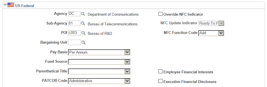

(USF) US Federal
These fields are available when you work in a federalized (U.S. Federal) database:
Image: Job Code Profile page – US Federal 1 of 2
This example illustrates the fields and controls on the Job Code Profile page – US Federal 1 of 2. You can find definitions for the fields and controls later on this page.
Job Code Profile page - US Federal section (1 of 2)
Image: Job Code Profile page – US Federal 2 of 2
This example illustrates the fields and controls on the Job Code Profile page – US Federal 2 of 2. You can find definitions for the fields and controls later on this page.

Field or Control
Definition
Override NFC Indicator
Select this check box to override the value in the NFC Update Indicator field.
Status of the transaction in relation to NFC, as maintained by the user or system. Options in this field include:
  • In Process – This Jobcode has been run through the export program and will be sent to NFC.
  • Not Ready – User intends to exclude this Jobcode from export to NFC.
  • Other – Status maintained by system user.
  • Ready – User intends to include this Jobcode in the next NFC export.
  • SINQ – This Jobcode has not successfully passed NFC's PINE Edits and needs correction.
NFC Function Code
Identifies the task to be performed by NFC on a master record. Options in this field include Add, Change, Delete, Inactivate, and Reactivate.
Bargaining Unit
If the job code is associated with a union, select a bargaining unit.
Pay Basis
Enter the pay basis for which you quote salaries for this job code; for example, Per Annum, Per Hour.
Classification Factors
The system displays the classification authority and the classification factors that are associated with the classification standard.
Target Grade
Enter the target grade of the job, if applicable.
Official Title Prefix
NFC-defined list of title prefixes.
Factor Level
Enter a classification factor level for each classification factor that is associated with this classification standard.
Points, Grade Points, and Total Points
The system displays the points that are associated with the classification standard.
Weight (%)
The system displays the weight percentage of the points that are associated with the classification standard.
OPM Certification Nbr (office of personnel management certification number)
Enter the OPM certification number that is associated with this job code.
Position Classification Stds (position classification standards)
Enter the position classification standards that are used.
Use the Evaluation Criteria page (JOBCODE_TBL2_GBL) to assign points to certain job evaluation criteria.
Image: Evaluation Criteria page
This example illustrates the fields and controls on the Evaluation Criteria page . You can find definitions for the fields and controls later on this page.
Field or Control
Definition
Knowhow
Enter points that represent the worker's knowledge required to perform the job.
Accountability
Enter points that represent the worker's ability to do the assigned job.
Problem-Solving
Enter points that represent the worker's ability to work out solutions despite obstacles.
Total Points
You determine the points by comparing each of these factors to every other job in your company. The greater the know-how, accountability, and problem solving for this job, the higher the points. For example, you would probably assign more accountability points to a controller than to a secretary because the controller has more responsibility.
The system calculates Total Points and the Percent, or relative importance, of each factor. For example, if Knowhow receives 33.2 percent of the total points, Accountability receives 33.7 percent, and Problem-Solving receives 33.1 percent, then all three factors are almost equally important.
However, if Knowhow receives 54.4 percent of the total points, Accountability receives 9.2 percent, and Problem-Solving receives 36.4 percent, then Knowhow is of greater importance than Accountability or Problem-Solving, and Accountability is of little significance.
Used by Position Management
Select if this job code is used by a position. If you specified full or partial position management on the Installation Table, this check box is selected by default. A selected check box tells the system that you're budgeting for the job code at the position level.
In Education and Government systems, deselecting this check box prevents you from attaching the job code to a position.
In commercial and U.S. Federal systems, deselecting this check box does not restrict your ability to attach positions to a job code. That is, even if this check box is deselected, you can still set up a position with the job code.
When you deselect this check box, the Pre-Encumbrance Indicator and Encumber Salary Option fields appear.
Indicate if and when to pre-encumber for this job code by selecting one of these values: Encumber Immediately, Encumber on Requisition, or No Encumbrance.
If you are using Commitment Accounting to encumber salaries, the system uses the option that you select to determine the salary amount when it encumbers the salaries of vacant positions.
Encumber Salary Amount
If you select User Specified Amount as the Encumber Salary Option, enter the salary amount to encumber.
