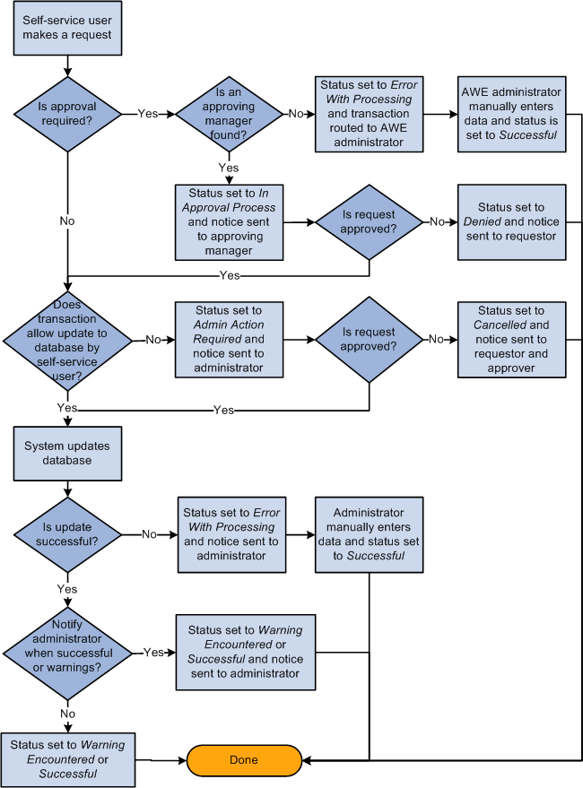

Overview of the Self-Service Processing
Image: Process flow for transactions using Process Configuration
This diagram maps out the process a self-service transaction takes when the transaction is set up to follow the configuration rules:
Note: If the transaction uses the Approval Framework and an appropriate user is not found, the system automatically routes the transaction to the Approval Framework (AWE) administrator for review and approval. If an appropriate user is not found for a transaction that does not use Approval Framework for workflow, the system sends an error notification to the administrator who can view the error using the Self-Service Inquiry page. In these cases, the administrator is required to manually enter data and set the status to Successful.

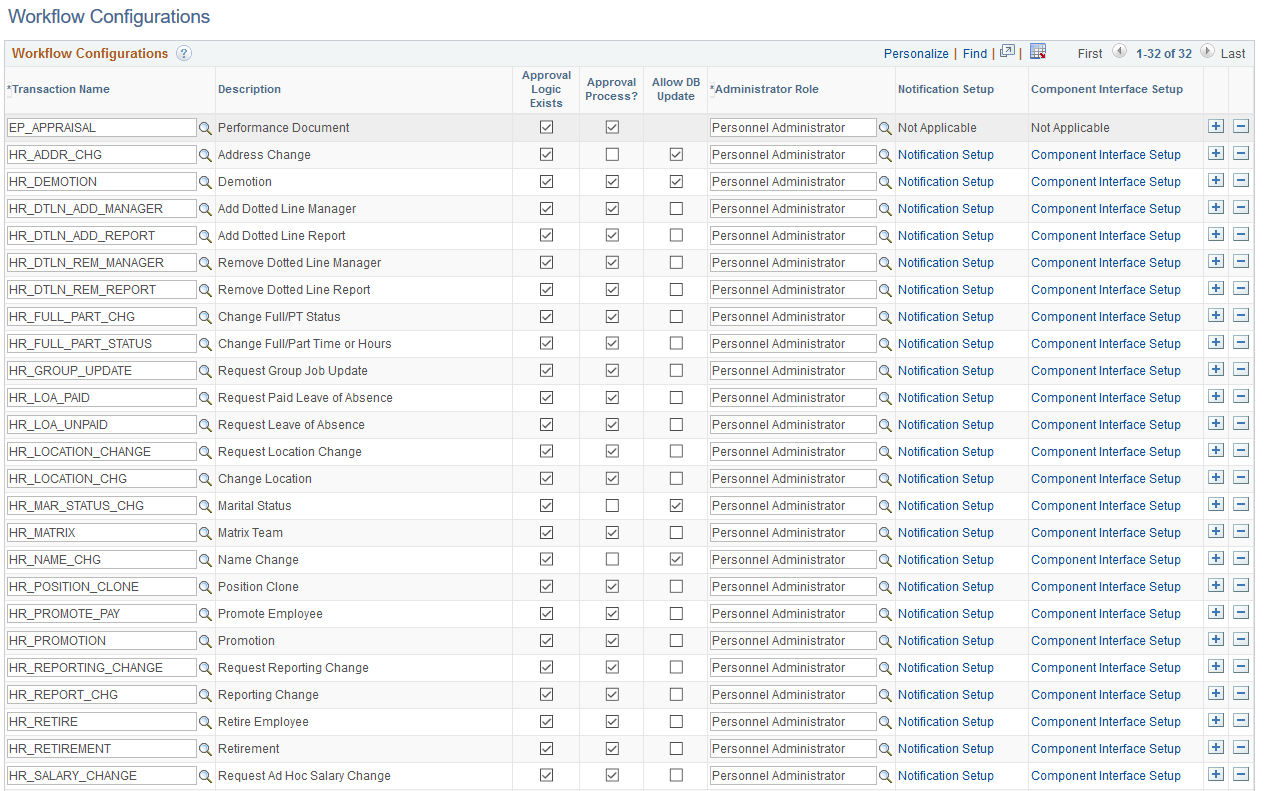

Use the Workflow Configurations page (WF_CO_CONFIG) to determine whether transactions should follow an approval process, update the database automatically, and identify who handles errors and manual updates to database.
Navigation
Image: Workflow Configurations page
This example illustrates the fields and controls on the Workflow Configurations page. You can find definitions for the fields and controls later on this page.
Note: (USF) This page is not used for U.S. federal self-service transactions, which never update the HR tables directly. Instead, federal transactions go through intermediate Personnel Action Request (PAR) tables, where an HR administrator completes a final approval outside of the standard approval process.
Field or Control |
Definition |
| Transaction Name |
Specifies the name of the transaction to define if it should follow an approval process, update the database automatically, and identify who handles errors and manual updates to database. |
| Description |
Lists the self-service transaction delivered with the system that is designed to work with the Process Configuration process. |
| Approval Logic Exists |
If selected, this check box indicates that an approval process has been configured in AWE for this transaction. |
| Approval Process? |
This check box is only available to those transactions designed to use an approval process. If selected, the system requires Manager level approval. If not selected, manager level approval is not required. Note: Transactions that use the Approval Framework require additional approval configuration. |
| Allow DB Update (allow database updates) |
If selected, this check box allows the transaction to update the database. If not selected, an administrator will be notified of the change and need to complete the process request. Administrators can complete the request on the Workflow Inquiry page or in the Self-Service transaction pages. |
| Administrator Role |
Identifies the role of the person who is responsible for reviewing the results of the transaction if errors occur. If Notify on Success or Notify on Warnings is selected on the Admin Notification Setup page, this role receives notifications when processing is successful or warnings are encountered. |
| Notification Setup |
Click this link to access the Admin Notification Setup page. |
| Component Interface Setup |
Click this link to access the SS Component Interface Setup page. |
For more information, see the product documentation for PeopleTools: Security Administration.

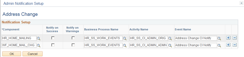

Use the Admin Notification Setup page (WF_HR_TRANS_NOT) to define if an administrator should receive email notification when automatic update was successful or there were warning messages issued during the update.
Navigation
Click the Notification Setup link on the Workflow Configurations page.
Image: Admin Notification Setup page
This example illustrates the fields and controls on the Admin Notification Setup page. You can find definitions for the fields and controls later on this page.
Field or Control |
Definition |
| Component |
The name of the transaction. |
| Notify on Success |
Applicable only if Allow DB Update is selected on the Workflow Configuration page. Select to have the role selected on the Workflow Configuration page receive an email when automatic updates are successful. |
| Notify on Warnings |
Select to have the role selected on the Workflow Configuration page receive an email when warning messages are generated during a successful HR database update. |
| Business Process Name, Activity Name, and Event Name |
This is predefined system data that can be changed if you want to use a different business process. |
