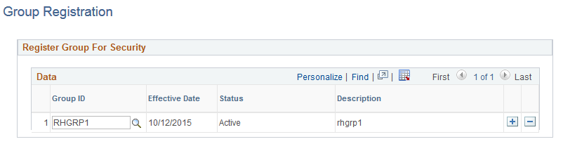

Group Registration Page
SCRTY_GB_REGISTER
Register groups from the Group Build feature that you want to use for row level security.

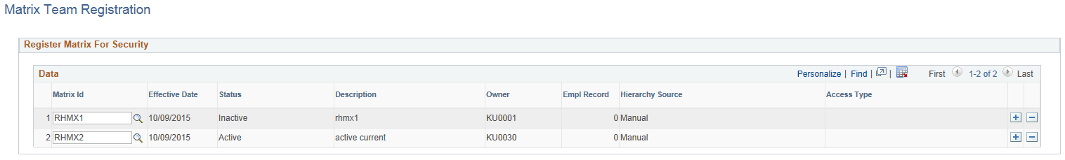

Matrix Team Registration Page
SCRTY_MX_REGISTER
Register a matrix team that you want to use for row level security.

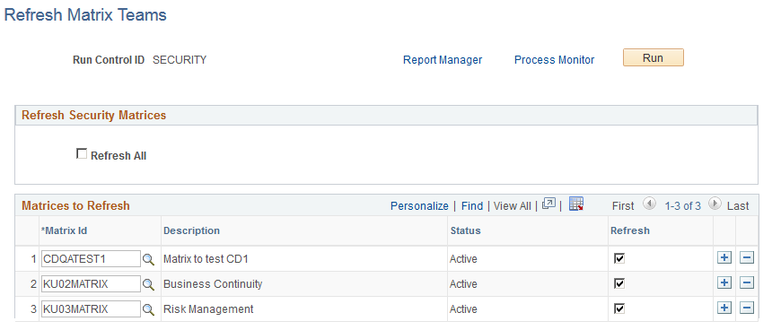

Refresh Matrix Teams Page
SCRTY_MX_REFRESH
Refresh security-related matrix teams.

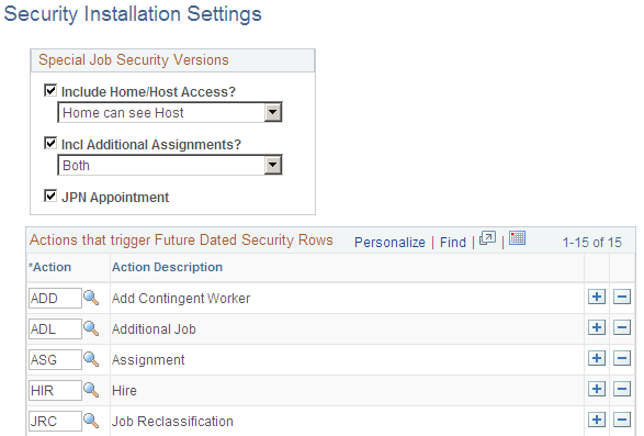

Use the Security Installation Settings page (SCRTY_INSTALL) to choose the HCM security settings for your installation.
Image: Security Installation Settings page
This example illustrates the fields and controls on the Security Installation Settings page. You can find definitions for the fields and controls later on this page.
Special Job Security Versions
The options you select here will be available for your installation but will not be enabled unless you select them again for the security access types you are using. This enables you to use the security versions for some security access types and not others.
Field or Control
Definition
Include Home/Host Access?
This option is for tracking global assignments. When an employee is on assignment they have a host record and a home record. Select one of the following options:
  • Home can see Host: Select to enable a person with data permission that enables them to view the home record to also view the employee's host record. A person with just data permission to the host record will not be able to see the employee's home record.
  • Host can see Home: Select to enable a person with data permission that enables them to view the host record to also view the employee's home record. A person with just data permission to the home record will not be able to view the host record.
  • Both: Select to enable a person with data permission to the home record to view the host record and a person with data permission to the host record to view the home record.
If you do not select Include Home/Host Access? then regular data permission rules apply.
See Understanding Global Assignment Tracking.
Incl. Additional Assignments?
This option is for workers with additional assignments added using the Job Data Concurrent component (JOB_DATA_CONCUR).
When a worker has an additional assignment, they have a controlling employee or contingent worker instance with an active job data record and an additional assignment job data record. Select one of the following options:
  • Assignment can see Instance: Select to enable a person with data permission that enables them to view the assignment job data record to also view the person's controlling instance job record. A person with data permission to the controlling instance job data record will not be able to see the worker's assignment job data record.
  • Instance can see Assignment: Select to enable a person with data permission that enables them to view the controlling instance job record to also view the person's assignment job data record . A person with data permission to the assignment job data record will not be able to see the worker's controlling instance job data record.
  • Both: Select to enable a person with data permission that enables them to view the controlling instance job record to also view the assignment job data record and a person with data permission that enables them to view the assignment job data record to also view the controlling instance job record.
  • None: Select to make additional assignments job data records available to all users.
If you do not select Incl. Additional Assignments? then regular data permission rules apply.
See Adding Additional Assignments.
JPN Appointment
(JPN) Select so that users who have access to the additional appointment of a worker can access the main appointment record for that worker.
The system assigns some additional assignments (Kenmu) to a particular EmplID and record called a main appointment, the job you can access through the Job Data pages.
If you do not select JPN Appointment? then regular data permission rules apply.
See Setting Up Security for Tracking Additional Appointments.
Actions that trigger Future-Dated Security Rows
Select the actions that will trigger the SavePostChange PeopleCode in the components using the JOB record to create a future-dated security row in SJT_PERSON when they are used in a future-dated row in the Job Data pages. The system will not create security rows for future-dated rows with actions other than those listed here.
To create future-dated rows, you need to select the Include Future Dates check box on the Security Type Table. This enables you to use future-dated security for some security access types and not others.

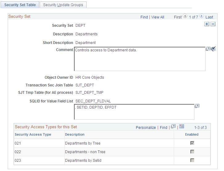

Use the Security Set Table page (SCRTY_SET_TBL) to review existing security sets and the security access types you've attached to them.
Image: Security Set Table page
This example illustrates the fields and controls on the Security Set Table page. You can find definitions for the fields and controls later on this page.
Field or Control
Definition
Object Owner ID
Security sets with a PeopleSoft Object Owner ID are system data and not available for modification on this page. You can still modify the Security Update Groups of delivered security sets.
Transaction Sec Join Table
The security join table that stores the transaction data for this security set.
Note: If you are creating a new security set, you must have created this table in Application Designer before creating the security set.
Creating a new security set requires modification of the system. Please refer to the Security white paper on My Oracle Support for directions.
SJT Temp Table (for AE process)
The temporary record used for PeopleSoft Application Engine. It is a copy of the transaction security join table and also contains the Application Engine process fields. This table updates the transaction security join field using the Application Engine process.
SQLID for Value Field List
The list of fields (not including the key fields) that are in the transaction security join table.
Generate SQL
Click to generate the SQL and SQLID for the value field list.
Security Access Types for this Set
The system lists the security access types for this security set and indicates which ones are enabled. Enable or disable security access types on the Security Type Table page.
See Security Type Table Page.

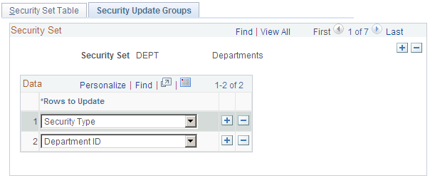

Use the Security Update Groups page (SCRTY_SJT_UPD) to define the data groups that can be updated by the SJT Refresh process.
Image: Security Update Groups page
This example illustrates the fields and controls on the Security Update Groups page. You can find definitions for the fields and controls later on this page.
Select which refresh options to make available when updating the security set using the SJT Refresh process. The system makes the options you select here available for this security set on the Refresh SJT page, enabling you to select portions of the security join table to update.
For example, you could refresh all the rows for external instructors by selecting the refresh option Person of Interest Type and the POI Type External Instructors.

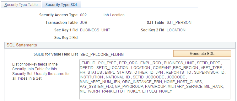

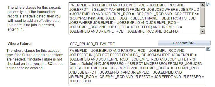

Use the Security Type SQL page (SCRTY_TYPE2_SQL) to enter the SQL statements for the new security types.
Image: Security Type SQL page (1 of 3)
This example illustrates the fields and controls on the Security Type SQL page (1 of 3). You can find definitions for the fields and controls later on this page.
Image: Security Type SQL page (2 of 3)
This example illustrates the fields and controls on the Security Type SQL page (2 of 3). You can find definitions for the fields and controls later on this page.
Image: Security Type SQL page (3 of 3)
This example illustrates the fields and controls on the Security Type SQL page (3 of 3). You can find definitions for the fields and controls later on this page.
The Application Engine uses the SQL fragments on this page to build the update and insert statements to update the transaction security join table.
You can use any SQLID but when you click the Generate SQL buttons, the system generates unique IDs based on the security set and/or type.
Warning! This page should only be used by users with a strong understanding of SQL joins and the table relationships.
Use the Group Registration page (SCRTY_GB_REGISTER) to register groups from the Group Build feature that you want to use for row level security.
Image: Group Registration page
This example illustrates the fields and controls on the Group Registration page.
Field or Control
Definition
Group ID
Select those groups that were created using the Group Build framework that you want to register as part of row level security. For more information on the Group Build feature, see Understanding Group Build.
Use the Matrix Team Registration page (SCRTY_MX_REGISTER) to register a matrix team that you want to use for row level security.
Image: Matrix Team Registration page
This example illustrates the fields and controls on the Matrix Team Registration page.
Field or Control
Definition
Matrix Id
Select those matrix teams that were created using the Matrix Team Page that you want to register as part of row level security.

Use the Refresh Security Matrix Teams page (SCRTY_MX_REFRESH) to refresh security-related matrix teams.
Image: Refresh Matrix Teams page
This example illustrates the fields and controls on the Refresh Matrix Teams page.
After a matrix team is registered, use the Refresh Matrix Teams run control page, which allows either refreshing or creating of content for all registered matrix teams (Refresh All) or for individually selected matrix teams, to run the Refresh Matrix Teams (SCRTY_MX_REF) process. This process populates the security Matrix Team Results (SCRTY_MXRES_TBL) transaction table that is used in security access. The process will also remove any inactive matrix teams that are identified on this page. Matrix Teams that are future dated will not be picked up by this process.
Note: You need to run the process from the Refresh Transaction SJT tables component to pick up the information stored in the Matrix Team Results (SCRTY_MXRES_TBL) transaction table.
Field or Control
Definition
Refresh All
Select this option to refresh or generate new content for all active registered security related matrix teams. Any inactive registered matrix teams will be removed from the security results table.
To register a team for security purposes, see the Matrix Team Registration Page.
Matrix Id
Select from those matrix teams that were registered on the Matrix Team Registration Page.
Status
Indicates if this matrix team is active or inactive. The Security Matrix Team Refresh process generates new content and updates the security Matrix Team Results table for active matrix teams and removes content for inactive matrix teams listed on this page.
Refresh
Select to refresh (add, update, or remove) specific rows of matrix team data. The process will use the selected data to update the Matrix Team Results (SCRTY_MXRES_TBL) transaction table accordingly. The system will process only those rows that are selected, unless the Refresh All option is selected and then all rows will be processed.
Note: When the Access Type Matrix Team (046) is enabled, the security sync AE program will pick up and generate entries in SJT_PERSON for all employees found in the associated matrix team table. To enable an Access Type, see Security Type Table Page.
