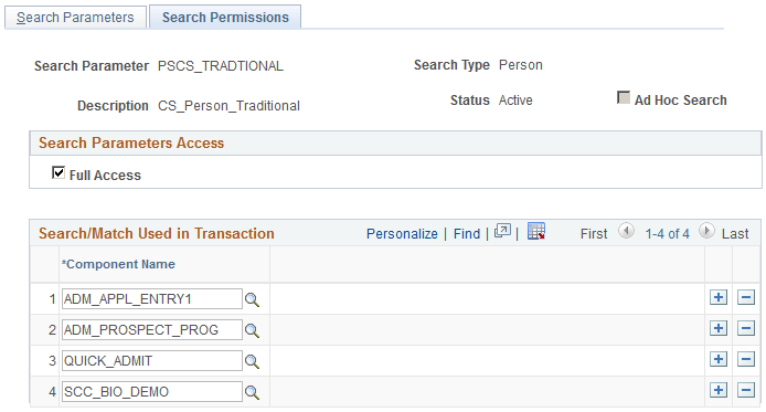

Use the Search Permissions page (HCR_SM_PERM) to identify who can use the search parameter to perform the search.
Also identify which component names, if any, should use the search parameter as part of saving a new ID in the database.
Image: Search Permissions page
This example illustrates the fields and controls on the Search Permissions page. You can find definitions for the fields and controls later on this page.
Search Parameters Access
Field or Control
Definition
Full Access
Select to enable all users to use the search parameter code.
Restricted Security Access
This area appears only when the Full Access check box is not selected.
Field or Control
Definition
Role Name and Role Description
Restrict the use of this search parameter code to users that have specific roles inside their security profile.
Search/Match Used in Transaction
Field or Control
Definition
Component Name and Component Description
If you want to enforce the use of Search/Match when adding a new ID, select the component name where adding a new ID occurs. The system will then initiate Search/Match when a user enters the data to create a new ID and saves the transaction. You can restrict the search to specific components whether you give permissions to all roles or only to specific roles.
Note: A component name can be associated with only one search parameter. However, the same search parameter can be used inside several component names. Select all components where the search parameter should be used.
Note: This field is available only when the Search Type is Person or Organization.

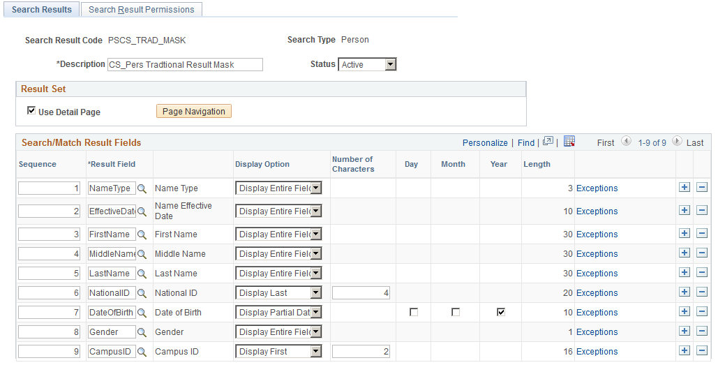

Use the Search Results page (HCR_SM_RESULT) to specify which result fields to include in the search results and control how to display their values.
Be careful not to confuse this page with the page also called Search Results with a similar object name (HCR_SM_RESULTS), which is the page on which Search/Match displays returns from a search.
Image: Search/Match Results - Search Results page
This example illustrates the fields and controls on the Search/Match Results - Search Results page. You can find definitions for the fields and controls later on this page.
Result Set
Field or Control
Definition
Use Detail Page
Select this check box to display a Detail link beside each ID returned from a search.
When you select Use Detail Page, the Page Navigation button appears.
Page Navigation
This button appears only when the Use Detail Page check box is selected.
Click to access the Search Results Detail page, on which you can define the page to which you want users to be directed to see more details about a specific ID.
Note: To be transferred to the page that you define here, the user must have security access to the page.
Search/Match Result Fields
Field or Control
Definition
Sequence
Enter the order by which the system displays results in the in the Search/Match results grid. You can reorder the result fields at any time. When you reorder the fields and save the page, the system displays the result fields in the most recent numerical sequence that you entered.
Result Field and Field Description
Select the data to return with the search results. Fields used to perform the search (search fields) can be different from the fields needed to review the results (result fields).
The result fields are defined in the Search/Match Result Fields page.
Display Option
Displays the default display control for that field. You can override this. Select Display Entire Field or Mask Entire Field to display or hide the entire field value respectively . The other options are:
Display First: Displays the first specified number of characters of the field value. When you select this, the Number of Characters field appears. You must enter the number of characters to display from the beginning of the field value.
Display Last: Displays the last specified number of characters of the field value. When you select this, the Number of Characters field appears. You must enter the number of characters to display from the end of the field value.
Display Partial Date: Displays the specified parts of a date field value. When you select this, the Day, Month, Year check boxes appear. You must select which parts of the date to display. For example if you select Year, only the year will appear.
Enter the number of first or last characters of a field value to display.
Day, Month, Year
Select the parts of the date to display for a date value.
Length
Displays the number of characters possible for the field value.
Exceptions
Click this link to access the Exceptions page, on which you can define field-level exceptions to these results.
Warning! Search/Match returns all potential matching IDs regardless of data permission security. You must use field-level security to mask or partially mask sensitive data.
See Understanding PeopleSoft Security and Understanding Data Permission Security for HCM.

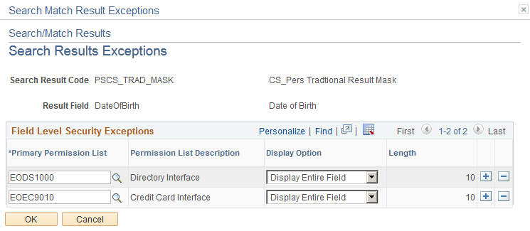

Use the Search/Match Results - Search Results Exceptions page (HCR_SM_RESULT_EXCP) to define field-level security exceptions to the data display control that is set on the Search Results Permissions page.
Image: Search/Match Results - Search Results Exceptions page
This example illustrates the fields and controls on the Search/Match Results - Search Results Exceptions page. You can find definitions for the fields and controls later on this page.
You can define exceptions to the search results that you set up on the Search Results page. For example, you might have partially masked the birth date field in your search results, but you want the entire field to appear for those who have a need to know. Using primary permission lists, you can set those exceptions here.
See PeopleTools: Security Administration
Field Level Security Exceptions
Field or Control
Definition
Primary Permission List and Permission List Description
Select the primary permission lists of the users who will be exceptions to the result field selected. When you exit the field, the system displays the permission list description.
Display Option
Select the display option to use as the exception to the display option selected on the Search Rules page.

Select this check box to enable all users to use the search result code
Enter roles to restrict the use of this search result code to users that have this role inside their security profile. These fields appears when the Full Access check box is not selected.
Component Name
This field is available only when the Search Type is Person.
If you use automatic search and want to display a warning message to alert users when potential duplicate IDs exist and you want to display the results of the automatic search, select the same component name or names that you selected on the Search Permissions page for the search parameter. You can restrict the search to specific components whether you give permissions to all roles or to only specific roles.
Note: A component name can be associated with only one search result code. However, the same search result code can be used inside several component names. Select all components where the search result code should be used. If Search/Match finds potential matching IDs that correspond to the data entered, the system returns a Search Results page showing the matching IDs that were found.
See Automatic Search.
