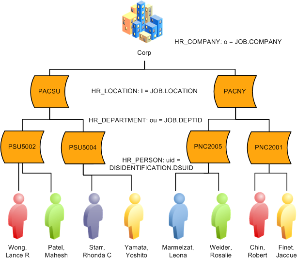

To use sample mappings that PeopleSoft delivers, establish directory IDs in the Directory Configurations component (PSDSSETUP) and add a directory ID to the mappings. The sample mappings use schema objects from a standard Novell eDirectory.
Image: Sample Directory Interface tree
We developed the sample mappings assuming that you are using the tree structure illustrated below, which is HR_PERSONs reporting to HR_DEPARTMENT, the departments are associated to the HR_LOCATION, which report to the corporate level, or HR_COMPANY:
Note: PeopleSoft delivers HR_LOCATION, HR_DEPARTMENT, and HR_PERSON as sample mappings
