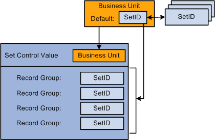

Regardless of which option you choose, when you save the business unit the system creates an entry in the Tableset Control component for that business unit and associates with each record group the default set ID you selected for the business unit. You can change the set ID assignment in the TableSet Control component.
Image: Tableset controls determine which tableset a business unit uses for which record group
This diagram shows the relationship between set IDs and business units and illustrates the information the system creates for the business unit in the TableSet Control component where you can change some or all of the set ID assignments:

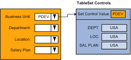

Image: Select the business unit, which determines the valid set IDs for many fields in the component
For example, in the Job Data component, select the business unit, such as PDEV as shown in this diagram. The system references the tableset controls for that business unit to determine the valid set IDs for many of the other fields on the component, such as Department, Location, and Salary Plan:
Select the business unit, which determines the valid setIDs for many fields in the component

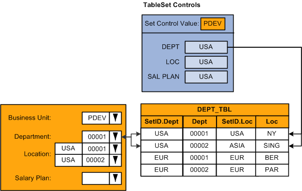

Image: The system only displays values keyed by the designated set ID identified for this field's prompt table for this business unit
When you select the Department lookup button in the Job Data component, the system references the TableSet Control table for the record group row that determines which department set ID is available for this business unit. Since USA is the designated set ID for the department record, the system only displays in the search list those departments with the USA set ID. In the diagram below this would be departments USA-00001 and USA-00002:
The system only displays values keyed by the designated setID identified for this field's prompt table for this business unit
The system also checks to see if the set ID of the location associated with the department is valid for this business unit.

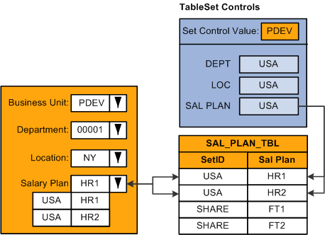

If the salary plan is associated with the location, the system checks the TableSet Control record for the business unit, in this example PDEV, to see if the set ID of the salary plan associated with this location is valid for this business unit. Since valid values for this business unit should be associated with the USA set ID, and the salary plan associated with the USA-NY location uses a salary plan set ID of SHARE, the salary plan will not be provided by default into the worker's record:
The system does not enter the default value if the value's setID is not valid for the business unit
Image: You can only view and select from values with the valid set ID as defined for the field
When you select a salary plan, the system will only retrieve those rows from the Salary Plan table that begin with set ID USA, as defined on the tableset controls for business unit PDEV:
You can only view and select from values with the valid setID as defined for the field
