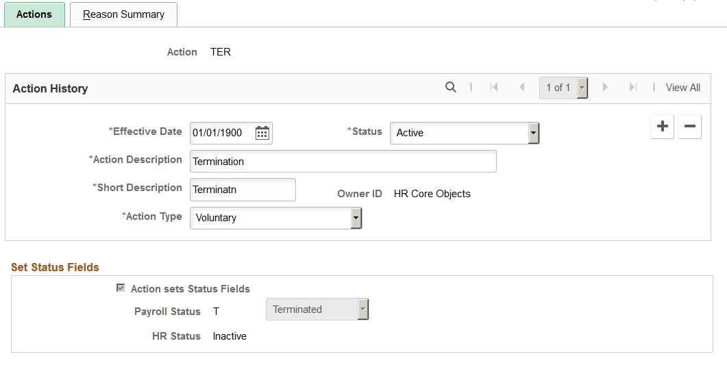

Use the Actions page (ACTION_TBL_GBL) to define or review a personnel action code and its values.

Field or Control |
Definition |
| Action Type |
Select to indicate if this is a Voluntary or Involuntary action. The Voluntary value is provided by default but you can override this value. When you create an Action Reason code on the Action Reasons Page, the value entered here for the action will be provided as the default value for the reason. |
Set Status Fields
Field or Control |
Definition |
| Action sets Status Fields |
Select this check box to identify actions that cause changes to Status and Date fields for the person receiving this action. When this check box is selected, the Set Organizational Instance Dt and Set Assignment Dates regions, as well as the other fields in the Set Status Fields region, are displayed. |
| Payroll Status |
Select the payroll status (EMPL_STATUS) of the person receiving this action. Values are: Active, Deceased, Leave With Pay, Leave of Absence, Retired, Retired With Pay, Retired-Pension Administration, Short Work Break, Suspended, Terminated, Terminated Pension Pay Out, and Terminated With Pay. |
| HR Status |
Identifies the status of the person receiving this action for HR purposes. |

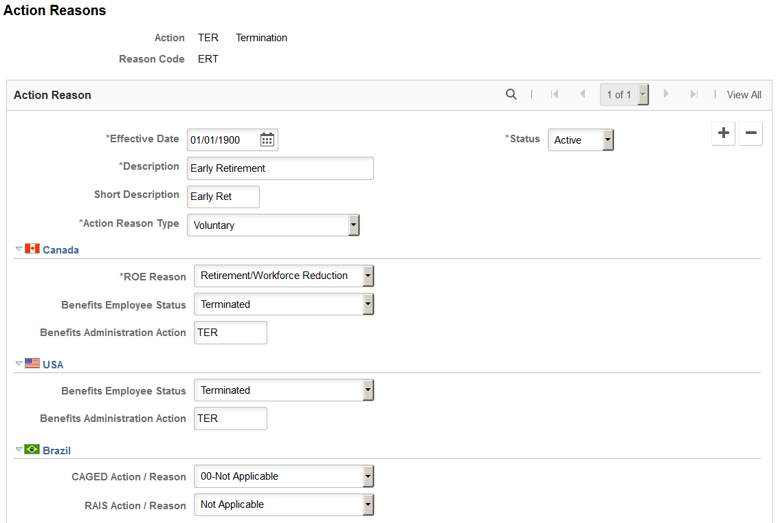

Use the Action Reasons page (ACTRSN_TBL_GBL) to define personnel action reasons or modify existing action reasons.
Navigation
Image: Action Reasons page (1 of 2)
This example illustrates the fields and controls on the Action Reasons page (1 of 2). You can find definitions for the fields and controls later on this page.
Image: Action Reasons page (2 of 2)
This example illustrates the fields and controls on the Action Reasons page (2 of 2). You can find definitions for the fields and controls later on this page.
Note: Effective-dated fields include the description and status as well as country-specific sections for Canada, USA, Brazil, and Spain. Other fields on this page, including the comments and the sections for Australia, Germany, and Mexico are not effective dated.

| Action Reason Type |
Select to indicate if this is a Voluntary or Involuntary action reason. The default value for this field is provided from the Action Type field on the Actions Page for this action, but you can override this value. |
(CAN) Canada
Field or Control |
Definition |
| Canadian ROE Reason (Canadian record of employment reason) |
Select a Canadian ROE reason, such as Return to School or Pregnancy. Valid values are defined by the Canadian government. |
| Benefits Employee Status |
Select the status associated with this action. |
| Benefits Administration Action |
If a particular action and reason code combination affects benefits in some way, enter the PeopleSoft Benefits Administration event classification for that combination in the Benefits Administration Action field. The Benefits Administration process will use this information to determine what rules to apply when evaluating eligibility for, and availability of, benefit option changes in response to this personnel action. |
(USA) United States
Field or Control |
Definition |
(BRA) Brazil
Field or Control |
Definition |
| CAGED Action / Reason (Cadastro Geral de Empregados e Desempregados action/reason) |
Enter the type of CAGED entry to report for actions with this reason. |
| RAIS Action / Reason (Relação Anual de Informações Sociais action/reason) |
Enter the type of action to report to RAIS for actions with this reason. |

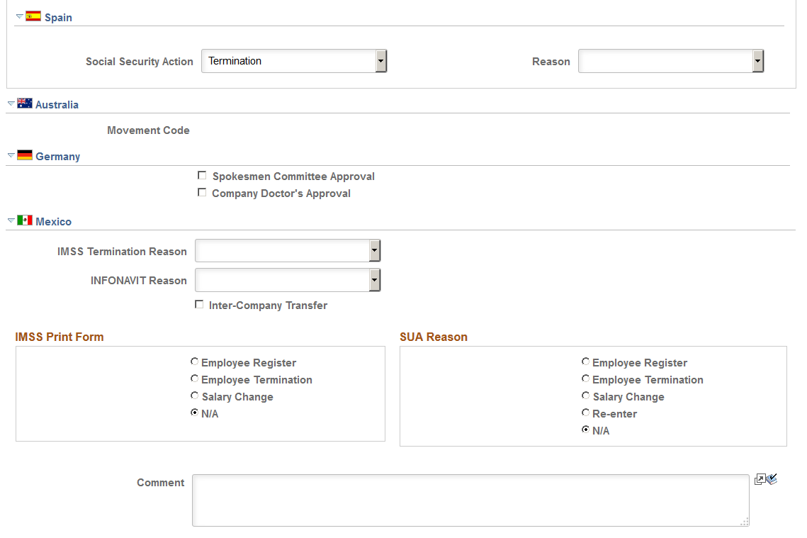

(ESP) Spain
Field or Control |
Definition |
| Social Security Action |
Select the social security action associated with this action reason. |
(AUS) Australia
Field or Control |
Definition |
| Movement Code |
Select the appropriate Public Service Merit Protection Commission (PSMPC) movement code for the employment status change. |
(DEU) Germany
Field or Control |
Definition |
| Spokesmen Committee Approval |
Select this check box as an action reason, if applicable. |
| Company Doctor's Approval |
Select this check box, if relevant, for this action reason. |
(MEX) Mexico
IMSS requires a notification for every hire, termination, and salary rate change. Once you've defined the details, these notifications are generated automatically by the system.
Field or Control |
Definition |
| IMSS Term |
Select the reason for termination. Values are: Agreement, Collective Termination, Employee Death, Employee Transfer, Inability, Lay-off, Leave, Mental or Physical Disability, N/A, Pension-Off, Retirement, Voluntary Renounce, and Work Risk Disability. |
| INFONAVIT Reason |
Select a reason to indicate to INFONAVIT why the INFONAVIT loan payments will stop. Values are: Death, Disability, Disengage, Never Work, Other, Retirement, and Transfer. |
| Maintain Variable SDI |
Select this check box to maintain variable SDI. |
| Inter-Company Transfer |
Select this check box to indicate that the action and reason code combination is valid for processing of inter-company transfers in Global Payroll for Mexico. The Inter-Company Transfer Application Engine process (GPMX_INTERC) triggers for processing only the action and reason code combinations that you indicate by selecting this check box. |
| IMSS Print Form |
Select the reason for a change in a worker's information. This is done to notify IMSS when an person is hired, rehired, terminated, or has a salary change. Values are: Employee Register, Employee Termination, Salary Change, and N/A (not applicable). |
| SUA Reason |
Select the reason that gets printed on the SUA notification. Values are: Employee Register, Employee Termination, Salary Change, Re-enter, and N/A (not applicable). |
