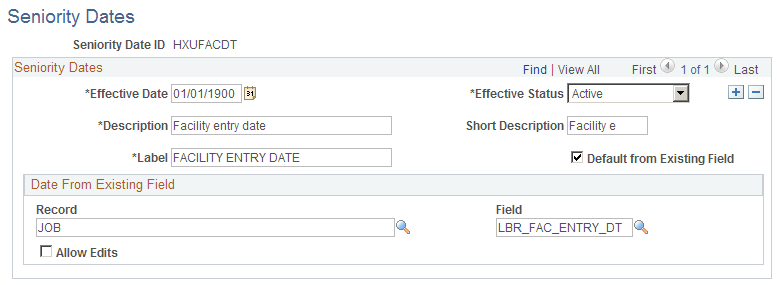

Seniority Dates Page
HR_SNR_DATE_TBL
Set up seniority dates to track a worker's seniority for labor administration purposes. You can base the seniority dates on existing system values or create new dates.
Attach the dates you create here to labor agreements.

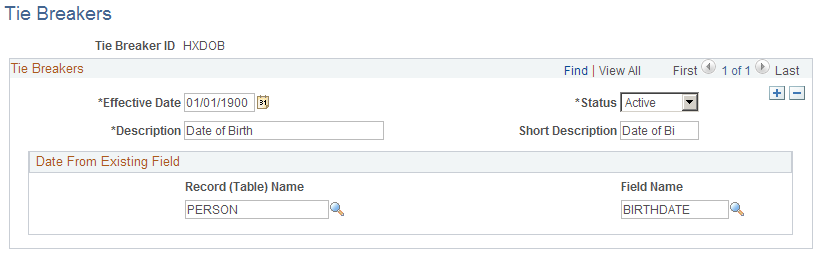

Tie Breakers Page
HR_TIEBREAK_TBL
Set up different types of ways to break ties between two workers who otherwise have equal seniority.

Tie Breakers
In the event that two workers are tied for seniority, you will need to apply a tie breaker that is in accordance with the workers' labor agreement. Define tie breaker types that are based on information in the system, such as birth date or national identification number, on the Tie Breakers page (HR_TIEBREAK_TBL) and associate them with labor agreements on the Labor Agreement component. Use tie breakers as sort criteria for the:
  • Seniority List report
  • Candidate List report
  • Reinstatement roster
  • Layoff roster
  • Recall roster
Note: For lottery-style tie breakers, where the unions decide the seniority order, you can manually change people's ranking on the roster by changing their rank number accordingly.
Use the Seniority Dates page (HR_SNR_DATE_TBL) to set up seniority dates to track a worker's seniority for labor administration purposes.
You can base the seniority dates on existing system values or create new dates. Attach the dates you create here to labor agreements.
Image: Seniority Dates page
This example illustrates the Seniority Dates page.
Field or Control
Definition
Label
Enter the label to appear next to this date field on the Job Data - Job Labor page.
Default From Existing Field
Select if this field's value defaults from an existing PeopleSoft system field. When you select this check box, the system makes the Record and Field fields available for entry.
Date From Existing Field
Field or Control
Definition
Record and Field
Select the record and field you want to use.
For example, to create a seniority date called Dept Entry that uses the Department Entry Date value from the Work Location page as a seniority date, select the JOB record and the DEPT_ENTRY_DT field. The system will display the Dept Entry seniority date on the Job Labor Workers page and automatically populate it with the date from the Department Entry Date field on the Work Location.
Allow Edits
Select to make the field available for entry on the Job Labor page, enabling you to override the default value.
Use the Tie Breakers page (HR_TIEBREAK_TBL) to set up different types of ways to break ties between two workers who otherwise have equal seniority.
Image: Tie Breakers page
This example illustrates the Tie Breakers page.
Tie Breakers page
Field or Control
Definition
Record (Table) Name and Field Name
Select the record and field value you want to use as a tie breaker. Only select records are available.
