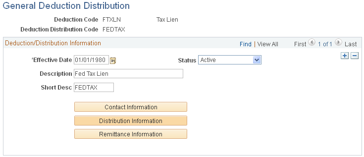

(USF) Use the General Deduction Distribution page (GVT_DED_DIST_TBL) to define general deduction distribution information to use in the US Treasury Interface.
Navigation
Image: General Deduction Distribution page
This example illustrates the fields and controls on the General Deduction Distribution page.
Field or Control |
Definition |
| Contact Information |
Select to access the Deduction Contact Information page. |
| Distribution Information |
Select to access the Deduction Distribution Information page. |
| Remittance Information |
Select to access the Deduction Remittance Information page. |
