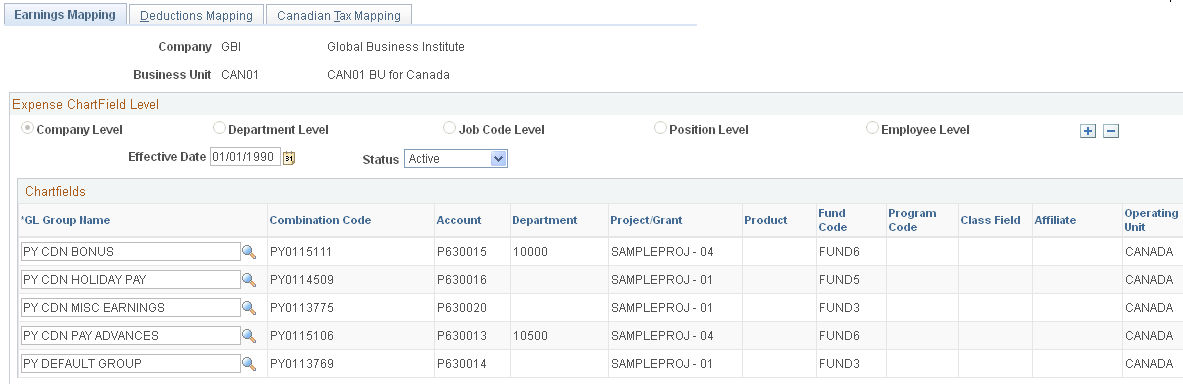

Use the Earnings Mapping page (PYGL_CO_CF_MAPERN) to specify mapping level and map earnings expense groups to ChartField combinations.
Image: Earnings Mapping page
This example illustrates the fields and controls on the Earnings Mapping page.
Note: The whole page is not shown here. The fields displayed on the page are determined by the ChartField configuration.
