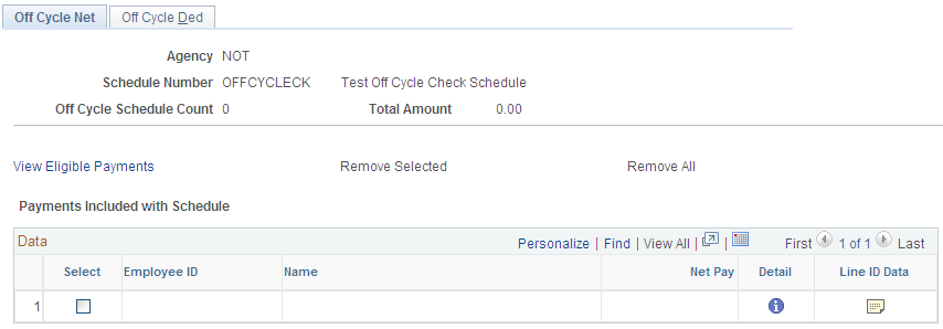

(USF) Use the Off Cycle Net page (GVT_ECS_OFF_NET) to select net payments for ECS off-cycle disbursements.
You can view data by schedule or by eligible payments.
Navigation
Image: Off Cycle Net page
This example illustrates the fields and controls on the Off Cycle Net page.
Important! PeopleSoft ECS interface process has been replaced by the Treasury Interface functionality.
Field or Control |
Definition |
| Eligible Payment Count |
(Visible only in View Eligible Payments mode). This is the total payments that are eligible to be disbursed for this schedule number. |
| View Eligible Payments |
Select to change to View Eligible Payments mode. |
| View Specific Schedule |
Select to change to View Schedule mode. |
| Remove Selected |
(Available in View Eligible Payments mode). Remove payments from the selected schedule. Select the Select check box for each payment that you're removing, then select Remove Selected. |
| Remove All |
(Available in View Schedule mode). Remove all payments from the selected schedule. |
| Add Selected |
(Available in View Eligible Payments mode). Add payments to the selected schedule. Select the Select check box for each eligible payment that you're adding then select Add Selected. |
| Add All |
(Available in View Eligible Payments mode). Add all eligible payments to the selected schedule. |
Payments Included with Schedule
Information in this group box depends on which mode you're in:
Mode |
Data Displayed |
All payments included in the schedule. |
All payments eligible to be included in the schedule. |
Field or Control |
Definition |
| Select |
Select an eligible payment to be added or removed. |
| Net Pay |
The net pay amount for each payment. |
| Detail |
Select to display the Off Cycle Net Check Summary Information page. |
| Line ID Data |
Select to display the Off Cycle Net Payment ID Information page. |
