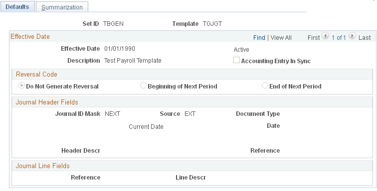

Use the Review Journal Generator Tmpl - Defaults page (JRNL_GEN_DEFAULTS) to view Journal Generator defaults.
Image: Review Journal Generator Tmpl - Defaults page
This example illustrates the fields and controls on the Review Journal Generator Tmpl - Defaults page.
PeopleSoft HCM processes use only the SetID and Template fields.
If you are not interfacing with PeopleSoft Financials, this page is editable. To set up a journal generator template enter a:
  1. Template ID.
  2. SetID.
    The setID needs to match the setID of the General Ledger business units you created on the Review GL Business Units component (BUS_UNIT_TBL_GL) for the business unit to use a journal generator template.
The remaining fields are not required, so you can enter dummy information or leave them blank.
If you are using PeopleSoft General Ledger, the system displays data in the following fields:
Field or Control
Definition
Accounting Entry In Sync
This check box is selected if a PeopleSoft application that supports the multibook feature has generated in-sync accounting entries for this template.
Reversal Code
The reversal code for this Journal Generator template.
Journal Header Fields
Field or Control
Definition
Journal ID Mask
The journal naming convention.
Journal Date
The date journals are created; for example, Accounting Date on Transaction or Process Date.
Alt. Journal Date (alternate journal date)
The journal date used for journals created outside of the open accounting periods range.
Header Descr (header description)
Descriptive information about the journal.
Source
Identifies the originating entity responsible for the journal entries.
Document Type
The default general ledger document type assigned to the journal header.
Reference
The transaction source of the journal.

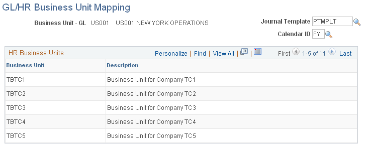

Use the GL/HR Business Unit Mapping page (BU_GL_HR_LNK) to verify that the General Ledger business unit is associated with the correct HCM business unit.
Image: GL/HR Business Unit Mapping page
This example illustrates the fields and controls on the GL/HR Business Unit Mapping page.
Associate a journal template with each General Ledger business unit.
Field or Control
Definition
Business Unit - GL
The PeopleSoft General Ledger business unit and description.
Journal Template
Select the journal template to associate with this PeopleSoft General Ledger business unit from the list of available options. Journal templates are used during the Actuals and Encumbrances processes (PAYGL02 and PAYGL03).
Calendar ID
If you use commitment accounting, select a calendar ID to associate with this PeopleSoft General Ledger business unit. The system uses calendar IDs to distribute actuals over accounting periods. Review calendars on the Detail Calendar page (DETAIL_CALENDAR1).
See Reviewing Detail Calendars and Budget Periods.
HR Business Units
The HR Business Units scroll area displays the PeopleSoft HCM business units and descriptions currently associated with the PeopleSoft General Ledger business unit.
If the PeopleSoft HCM and PeopleSoft General Ledger business units aren't correctly mapped, correctly associate them on the Business Unit Reference page. After mapping PeopleSoft HCM business units to the appropriate General Ledger business units, return to the GL/HR Business Unit Mapping page to associate a journal template and calendar ID with each General Ledger business unit.
