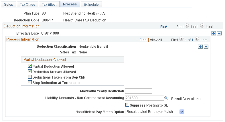

Deduction Table - Process Page
DEDUCTION_TABLE4
Establish parameters for partial deductions and arrears.

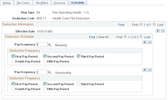

Deduction Table - Schedule Page
DEDUCTION_TABLE5
Specify which pay periods the deduction should be taken for the pay frequencies that you want to override.

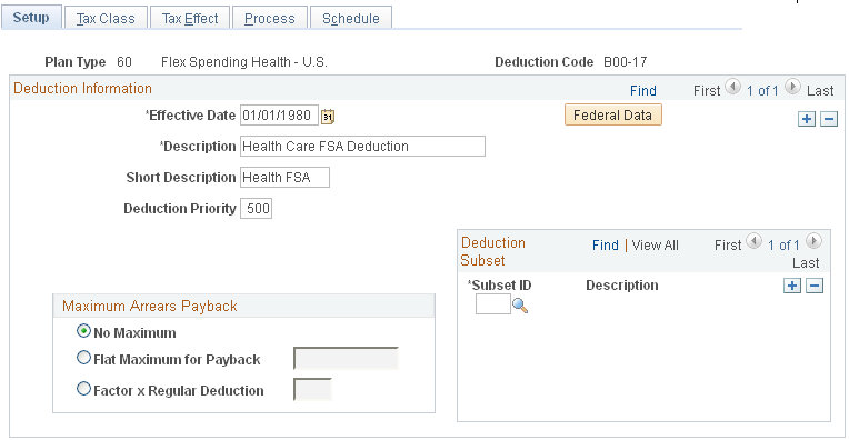

Use the Deduction Table - Setup page (DEDUCTION_TABLE1) to specify the deduction priority, subset ID, and other parameters for arrears payments and garnishments.
Image: Deduction Table - Setup page
This example illustrates the fields and controls on the Deduction Table - Setup page.
Deduction Information
Field or Control
Definition
Federal Data
(USF) Select this button to access the Federal Distribution Destinations page where you can further define the deduction and the interface in which it should be included.
Short Description
Enter a short description of the deduction. The short description that you enter here appears on the paycheck stubs by the check printing processes.
Deduction Priority
Enter a deduction priority number for the deduction code. The order in which the system takes deductions during pay calculation is based on the deduction priority number and the deduction classification. You define deduction classifications on the Deduction Table - Tax Class page. The lower the deduction priority number, the higher the priority of that deduction. For example, a deduction with a priority number of 20 is taken before a deduction with a priority number of 40.
PeopleSoft recommends that you give each deduction a unique deduction priority number, particularly with before-tax deductions. A possible exception is instances where you may want to establish a set of related deductions with equal deduction priorities. For example, if your company offers a flexible benefits program that requires each employee to choose only one of several health plans, you may want to assign the same deduction priority to all the available health plans.
Deductions can be included in special accumulators. If you assign a deduction to a special accumulator and that special accumulator is then used to calculate another deduction, the deduction priority of the first deduction must be less than the deduction priority of the deduction using the special accumulator.
Special Processing
Select a value from this field if the deduction is for a special process:
Bond: Select if the deduction is for purchasing Canada Payroll Savings plans.
Garnishment: Select if the deduction is for garnishments. This option initiates garnishment processing during payroll calculation.
Union Dues: Select if the deduction is for union dues. When you select this option, the system automatically displays the Union Code field.
Note: When no special process is applicable, this field should be empty.
Union Code
This field appears only when you select Union Dues in the Special Processing field. Select the union code that is associated with the union for which this deduction applies. Union codes are maintained in the CAN/USA - Union table.
Maximum Arrears Payback
Use this group box to specify how the system processes the payback of arrears balances. Note that any arrears processing method that you define here can be overridden either at the employee level on the Paysheet One-Time Deductions page, or on the General Ded Code Override (general deduction code override) page for general deductions.
Field or Control
Definition
No Maximum
Select this option if you do not want a maximum amount specified for arrears payback. If you select this field, the system deducts as much money as possible from the employee's paycheck to pay back the arrears balance.
Flat Maximum for Payback
Select this option if you want the maximum arrears payback to be a flat rate. For example, if an employee has an arrears balance of 500 CAD and a flat maximum amount for payback specified at 100 CAD, only 100 CAD is deducted on each paycheck for the arrears balance until the total 500 CAD has been withheld. Note that this amount is in addition to any regular deductions.
Factor x Regular Deduction
Select this option if you want to have a percentage of a regular deduction withheld for the payback of the arrears balance. This is in addition to the withholding of the regular deduction. For example, an employee has a medical deduction of 100 CAD with an arrears balance of 500 CAD. You may want to have the system deduct the normal 100 CAD medical deduction and specify that 50 percent of that amount to apply to the arrears balance. This makes a total deduction of 150 CAD. To do this, you select this field, and enter .5 as the factor.
Note: For benefit deductions, the maximum arrears payback method that you select applies to all employees with this deduction who are in arrears. To change the arrears processing method for an individual employee, you'll use Benefit Arrears/Frequency Ovrd (benefit arrears/frequency override) page.
Deduction Subset
If you want to include the deduction in any of the deduction subsets that you've defined on the Deduction Subset Table page, select an applicable deduction subset ID. You can include a deduction in any number of deduction subsets.
Field or Control
Definition
Subset ID
Select an applicable deduction subset ID.

Use the Deduction Table - Process page (DEDUCTION_TABLE4) to establish parameters for partial deductions and arrears.
Image: Deduction Table - Process page
This example illustrates the fields and controls on the Deduction Table - Process page.
Partial Deduction Allowed
Use this group box to define parameters for deductions during deduction processing and arrears.
Field or Control
Definition
Select this check box if you want a partial deduction to be taken during deduction processing when there is insufficient pay to take the entire amount. Do not select this option for garnishment deductions.
Deduction Arrears Allowed
Select this check box to have the system transfer any uncollected amount for a deduction into an arrears balance. During subsequent payroll runs the system attempts to recover the balance in arrears from an employee's paycheck—up to the maximum controlled by the arrears payback amount on this table.
If you set up an arrears payback deduction (such as a company loan or a vacation advance) on the Earnings Table - Taxes page, this check box must be selected.
Important! If an employee is not paid during a regularly scheduled payroll and there are deductions scheduled to be withheld, those deductions are put into arrears if the Deduction Arrears Allowed check box is selected.
Important! Do not select the Deduction Arrears Allowed check box for garnishments. Late or unpaid garnishments cannot be held in arrears—these are managed by the court system and are prohibited from being placed in arrears by garnishment regulations. If you select this check box for garnishments, unexpected or incorrect pay results may occur for both U.S. and Canadian customers.
Deductions Taken From Sep Chk (deductions taken from separate check)
Select to take the deduction from any additional check that an employee might get in a single pay period. You may want to select this check box for deductions for savings plan contributions.
Stop Deduction at Termination
Select to indicate not to take the deduction from the paycheck of a terminated employee. If an employee's termination date is equal or prior to the pay period end date, the deduction will not be taken. For example, most health insurance plans are prepaid—premiums deducted for this month are used to provide coverage for next month. If employees no longer have health benefits after they are terminated, the deduction shouldn't be taken.
Maximum Yearly Deduction
Enter an amount for any deductions that have a yearly limit. For example, there is a limit on the amount of before-tax portion 401(k) contributions an employee can make. For that deduction classification, enter the maximum contribution here, so the system will automatically stop after the deduction limit has been reached.
The value that you enter here remains valid for one calendar year. It resets to zero at the start of the new year.
Liability Accounts - Non Commitment Accounting
Enter the general ledger liability account to which this deduction should be charged. At least one general ledger account must be entered for a deduction and a general ledger account is required for every deduction classification.
Note: (E&G) The Expense Accounts - Non Commitment Accounting and Liability Accounts - Non Commitment Accounting fields are not applicable to education and government users.
Suppress Posting to GL
This check box appears only when the deduction class is an employer expense: Nontaxable Benefit, Nontaxable Btax Benefit (before tax), Taxable Benefit, and QC Taxable Benefit.
Select this check box to prevent the accounting entry from being generated from the GL Interface processes for the specified deduction/deduction class combination.
Note: This check box must be selected for the Adult Child deduction code/Non-taxable before tax benefit class.
The Commitment Accounting Actuals Distribution process and PAYGL02.SQR, and the Commercial PAYGL01.SQR look at this check box, and when the check box is selected, suppresses accounting data.
The PAY705A SQR Deduction Classes report, reports the Suppress Posting to GL value for every deduction code/deduction.
Insufficient Pay Match Option
This field appears for 4x Savings and 6x FSA plans when the deduction class is Nontaxable Benefit, Nontaxable Btax Benefit (before tax), and QC Taxable Benefit.
Note: The insufficient match pay options only work with the Service Step table and Percent of Employee Investment options.
Specify how the employer matching/nonmatching contribution should be paid in situations of insufficient net pay:
  • Full Employer Match: Pay the entire employer contribution.
  • No Employer Match: Pay no employer contribution.
  • Recalculated Employer Match: Recalculate the employer contribution based upon the actual employee contribution.
    When using the service step table to base the employer match, the full or a portion of the employer contribution is made.
    Note: A recalculated match is not a prorated or partial match. The system recalculates the employer contribution based upon the effective percent of the new employee contribution considering insufficient net pay. Effective percent is calculated as: calculated employee contribution divided by employee's eligible earnings.
Use the Deduction Table - Schedule page (DEDUCTION_TABLE5) to specify which pay periods the deduction should be taken for the pay frequencies that you want to override.
Image: Deduction Table - Schedule page
This example illustrates the fields and controls on the Deduction Table - Schedule page.
By default, each deduction comes out every pay period regardless of pay frequency. If you want a deduction to be taken out on a schedule other than every pay period, you must complete the Deduction Table - Schedule page.
Deduction Schedule
Field or Control
Definition
Pay Frequency
Specify the pay frequency that you want to override for those deductions that are not deducted every pay period. Values prompt from the Frequency table: Annual, Biweekly, Daily, Monthly, Quarterly, Semimonthly, and Weekly. If you select a Weekly frequency, you can select the Fifth Pay Period option only if you have also selected the first, second, third, and fourth periods. Likewise, for a Biweekly frequency you can only select the Third Pay Period option if you have also selected the first and second. Because a deduction with a monthly frequency is always taken once a month, there is no override for that pay frequency on this page. Suppose that you have a semimonthly payroll, but health deductions should only come out of the last paycheck of the month. In this case, you would select a pay frequency of Semimonthly and take a deduction in the second pay period.
Deduction Frequency
Use this group box to specify which appropriate pay periods to take the deduction for the pay frequency selected. You must insert a new row for every pay frequency for which you have a pay group defined.
Field or Control
Definition
First Pay Period through Fifth Pay Period
Select the appropriate period check boxes that you want the deduction to be taken in.
Note: If you want the deduction code to be taken each pay period, do not alter this page when you initially create the deduction code. The default for this page is every pay period for every pay frequency.
