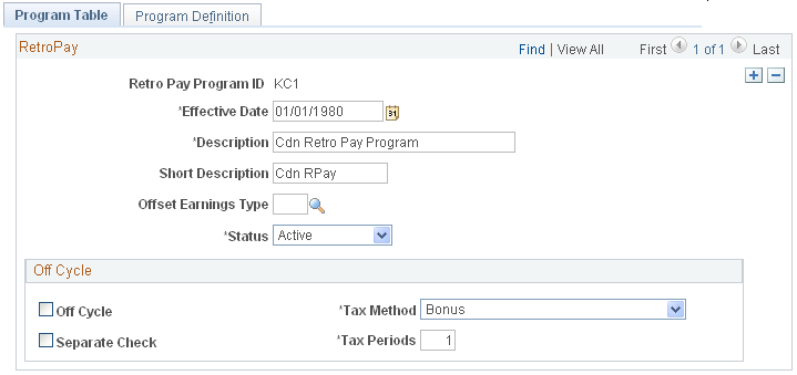

Use the Program Table page (RETROPAY_PGM_TBL) to describe a retro pay program and specify paysheet processing options.
Image: Program Table page
This example illustrates the fields and controls on the Program Table page.
Program Table page
Field or Control
Definition
Retro Pay Program ID
This ID identifies the retro pay program when you associate the program with a pay group.
Offset Earnings Type
Select an offset earnings type for any negative earnings that are generated by the retro pay calculation. To avoid negative checks, link this earnings code to a payback deduction code. The system deducts the amount from subsequent paychecks of applicable employees.
Off Cycle
Field or Control
Definition
Off Cycle
Select to create retroactive pay that is associated with this program as off-cycle earnings. If you deselect this check box, the system creates retroactive pay that is associated with this program as on-cycle earnings. After the system calculates retro pay, but before you load the retro pay to paysheets, you can change this setting on the Retro Pay Calculation Results page under Retroactive Payroll.
See Retro Pay Calculation Results Page.
Separate Check
Select to load the earnings that are associated with this program to a separate check on the paysheets.
Tax Method
Select a tax method to load to the paysheet line for the earnings in this program.
Tax Periods
Enter the number of tax periods to load to the paysheet line for the earnings in this program.

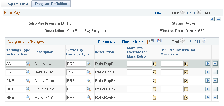

Use the Program Definition page (RETROPAY_PGM_DEF) to establish the earnings codes for which the retro pay program calculates retro pay and those used for paying retro pay earnings.
Image: Program Definition page
This example illustrates the fields and controls on the Program Definition page.
Assignments/Ranges
Create a row of data for each earnings code that is eligible for retro pay.
Field or Control
Definition
Earnings Type for Retro Pay
Select the earnings code that is eligible for retro pay.
Retro Pay Earnings Type
Enter the earnings code to use for the retro payment.

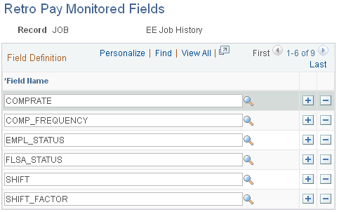

Use the Retro Pay Monitored Fields page (PY_RETROTBL_DEF) to list the job and additional pay fields that are available to use when you define the triggers that create retro requests.
Image: Retro Pay Monitored Fields page
This example illustrates the fields and controls on the Retro Pay Monitored Fields page.
Field or Control
Definition
Record
Oracle delivers definitions for the JOB record and the ADDL_PAY_DATA record. These are the only supported records for retro pay triggers.
Field Name
The fields in the Field Definition grid are the only fields that are available for use in retro triggers.
Oracle delivers field lists for both the JOB and ADDL_PAY_DATA records. You can add and delete entries to change which fields are monitored.
You cannot delete entries for fields that are used in current retro pay trigger value definitions.
Delivered JOB Fields
The delivered configuration for the JOB record includes these fields:
  • COMPRATE (compensation rate)
  • COMP_FREQUENCY (compensation frequency)
  • EMPL_STATUS (employee status)
  • FLSA_STATUS (FLSA status)
  • SHIFT (shift)
  • SHIFT_FACTOR (shift factor)
  • SHIFT_RT (shift rate)
  • STD_HOURS (standard hours)
  • STD_HRS_FREQUENCY (standard hours frequency)
Delivered ADDL_PAY_DATA Fields
The delivered configuration for the ADDL_PAY_DATA record includes these fields:
  • ADDL_PAY_SHIFT (additional pay shift)
  • COMP_RATECD (compensation rate code)
  • EARNINGS_END_DT (earnings end date)
  • GOAL_AMT (goal amount)
  • GOAL_BAL (goal balance)
  • HOURLY_RT (hourly rate)
  • OTH_HRS (other hours)
  • OTH_PAY (other pay)
  • PAY_PERIOD1, PAY_PERIOD2, PAY_PERIOD3, PAY_PERIOD4, and PAY_PERIOD5 (pay periods 1-5)

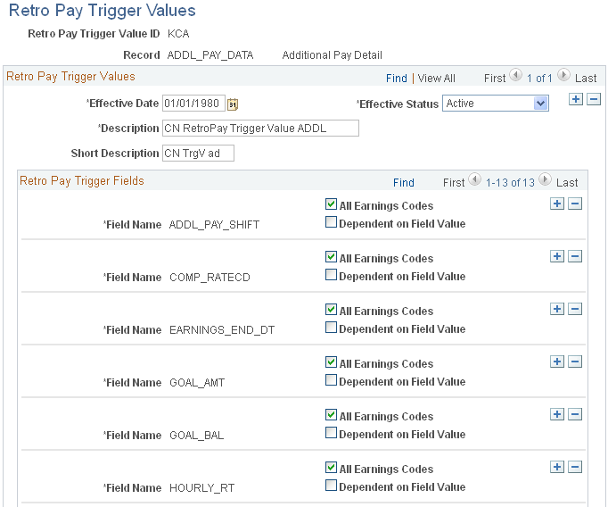

Use the Retro Pay Trigger Values page (RETRO_TRG_VALUES) to define a set of field changes that trigger retro requests. Each set can include fields from either the job record or the additional pay records.
Image: Retro Pay Trigger Values page: JOB record
This example illustrates the fields and controls on the Retro Pay Trigger Values page: JOB record.
Image: Retro Pay Trigger Values page: ADDL_PAY_DATA record
This example illustrates the fields and controls on the Retro Pay Trigger Values page: ADDL_PAY_DATA record.
Field or Control
Definition
This ID identifies the set of retro pay trigger values when you associate it with a retro pay trigger program.
Record
JOB and ADDL_PAY_DATA are the only supported records for trigger values.
Retro Pay Trigger Fields
Field or Control
Definition
Field Name
Select one of the fields that the system is monitoring for changes. These are the fields that appear on the Retro Pay Monitored Fields page for the selected record.
When you select a value, the Field Name field immediately becomes read-only. To change the value, you must delete the row and add a new one.
Earnings Code and All Earnings Codes
Note: These fields appear only for the ADDL_PAY_DATA record.
Use these fields to choose which additional pay earnings codes produce retro requests when the selected field changes.
To create retro requests for all retro-eligible earnings codes, select the All Earnings Codes check box. The system hides the Earnings Code field when the check box is selected.
To create retro requests for a single earnings code, deselect the check box and enter a value in the Earnings Code field.
To create retro requests for some, but not all, earnings codes, you can create multiple rows of data for the same field and enter different earnings codes for each row.

Dependent on Field Value
To create a retro request for any change to the selected field, leave this check box deselected.
To create a retro request only when the field changes to one or more specific values, select this check box and enter the values in the Field Values grid that appears.
Field Values
Field or Control
Definition
Set ID
If the selected field is setID-controlled, you must enter a setID before you can select specific values.
If the selected field is not setID-controlled, this field is not enterable
<Field Type> Value
Enter the values that create retro requests. For example, in the JOB record, you might create retro requests for certain employee status changes to Active or Leave of Absence, but not when it changes to any other value.
Depending on the field type, the label for the field value column is Character Value, Numeric Value, or Date Value.
