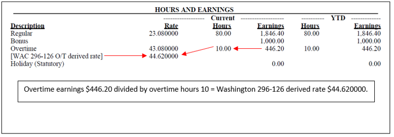

Derived Overtime Rates on Wage Statements
Several states have requirements to print the employees’ rates of pay on the wage statements. To date, the states are CA, HI, MN, NY, OR and WA.
The derived overtime rate is printed on wage statements when the wage statement is created using BI Publisher with the PDF Overflow templates, and the Overflow Statements check box is selected on the Paycheck Options Table Page.
The derived overtime rate description on the wage statements is based on the space available on the wage statement, for example:
  • If overtime is associated with current time, the wage statement displays the long description.
  • If the overtime is associated with prior time, and the pay period begin and end dates are displayed on the wage statement, the wage statement displays the short description.
This table lists the long and short descriptions of derived overtime rates by state:

Note: For CA, MN, OR and WA, the descriptions contain the section of the labor code that pertains to the wage statement requirements. For HI and NY, WTPA stands for Wage Theft Prevention Act.
The derived overtime rate is obtained by dividing the overtime earnings paid by the number of overtime hours paid. The regulations require the wage statement to display an employee’s overtime pay rate as the result of this calculation, even if this calculation does not represent how the overtime earnings were actually calculated, which can occur when the Rate Used field is set to either FLSA Rate or Alternative Rate on the Paycheck Earnings Page.
Image: Example of the derived overtime rate displayed on a Washington employee's wage statement
This example shows the derived overtime rate on a Washington employee's wage statement.

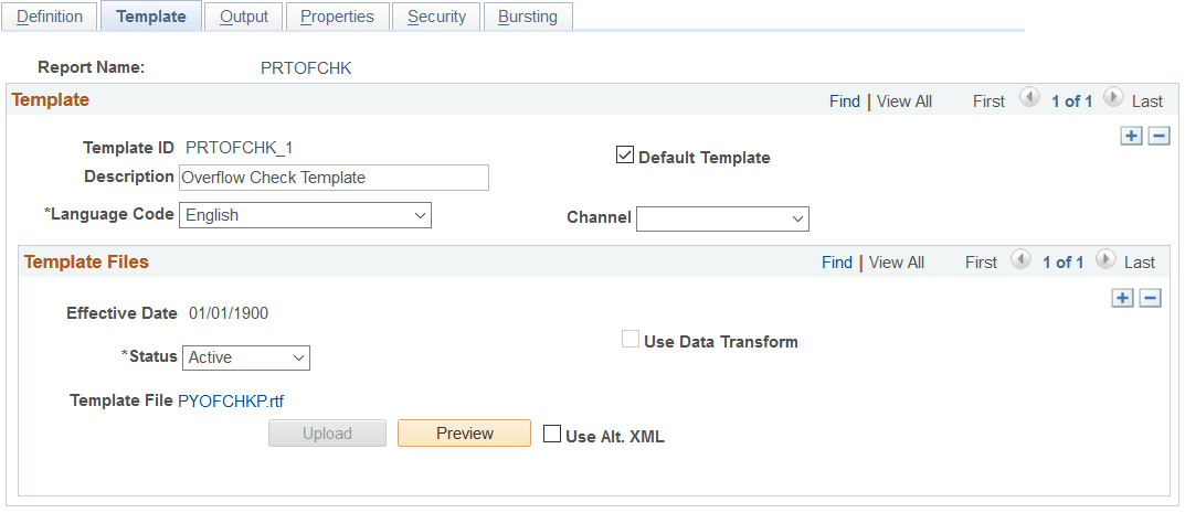

Use the Template page (PSXPRPTTMPL) to view or modify the existing template.
Image: Report Definition - Template page
This example illustrates the fields and controls on the Report Definition - Template page.

Modifying the Existing Template
To modify an existing template:
  1. Select Download on the Template page and row for the existing RTF template that you want to copy.
  2. Save a copy of the downloaded template with a new RTF file name (*.rtf).
  3. Make the desired modifications to the new template file and save.
    These are some of the changes that you might want to make:
    • Change the dummy signature image.
    • Identify the valid signature image.
    • Change the MICR font.
    For more information on how to make each change, see your PeopleTools: BI Publisher for PeopleSoft product documentation.
  4. Add a new effective dated row in the Template Files scroll area on the Template page.
  5. Update these options:
    Field or Control
    Definition
    Effective Date
    Enter the date that the system should begin to print and display paychecks with this template.
    Status
    Select the Active status for the new template.
    Note: Retain the active status of all historical template files to ensure that the correct template is applied to paychecks viewed in self service.
  6. Select Upload and select the new template file.
  7. (Optional) Select Preview to confirm your updates and verify that the template uploaded successfully.
Note: Become familiar with XML Publisher before modifying any of the delivered templates.
