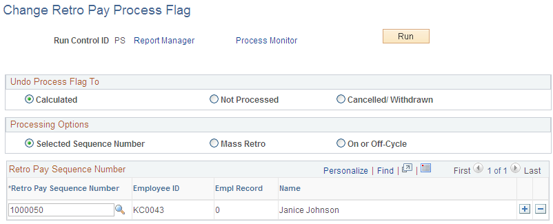

Use the Change Retro Pay Process Flag page (RUNCTL_RTROPAYUNDO) to change the process flag value in the Retro Pay Request table for retro pay requests.
Image: Change Retro Pay Process Flag page
This example illustrates the fields and controls on the Change Retro Pay Process Flag page.
Undo Process Flag To
Indicate the new process flag value to apply to the affected retro requests: Calculated, Not Processed, or Cancelled/Withdrawn.

Selected Sequence Number
Select this option if you want to select one or more specific retro requests to update. When you select this option, the Retro Pay Sequence Number grid appears so that you can enter the retro pay sequence numbers (the request IDs) for the requests that you want the system to update.

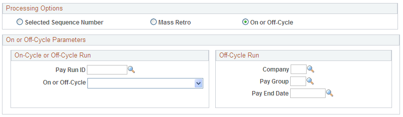

On or Off-Cycle
Select this option if you want to change the process flag for the retro pay requests of a pay run.
This group box is visible only when the process option is Selected Sequence Number.
Field or Control
Definition
Select the sequence numbers for the retro requests that you want to update. Although you enter the sequence number, you can use the field prompt to search for sequence numbers based on the EmplID, the employee name, or the current value of the retro pay process flag.
You cannot select retro requests that are already processed and closed. Retro requests in these statuses are considered closed:
Manually loaded to paysheets
Loaded to paysheets
Paycheck reversed
Confirmed
Cancelled/Withdrawn

On-Cycle or Off Cycle Parameters
This group box is visible only when the selected process option is On or Of-Cycle. Use the fields in this group box to specify which pay runs to process. The system changes the process flag of any retro request included in the pay run.
Image: The On-Cycle or Off Cycle Parameters group box appears when you choose to process on or off-cycle pay runs
This example illustrates the fields and controls on the The On-Cycle or Off Cycle Parameters group box appears when you choose to process on or off-cycle pay runs.
Field or Control
Definition
Pay Run ID
If you use this field, all fields in the Off-Cycle Run group box become unavailable for entry.
Company
If you use this field, the Pay Run ID and On or Of-Cycle fields become unavailable for entry.
