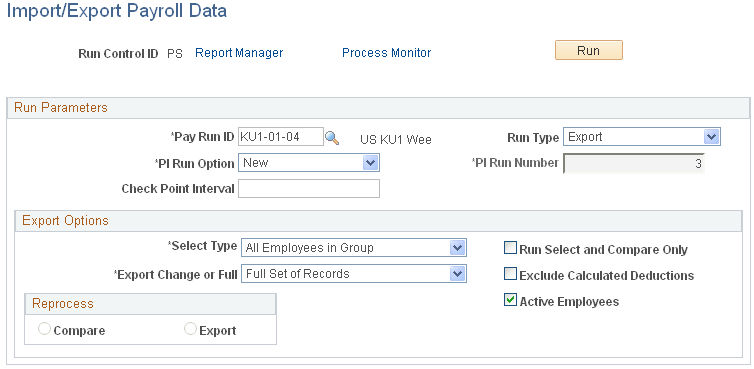

Import/Export Payroll Data Page
PI_RUNCTL_PNL
Select the export or import process options and run the P.I. Export/Import Driver Application Engine process (PI_INRUN) to export or import data.
Use the Import/Export Payroll Data page (PI_RUNCTL_PNL) to select the export or import process options and run the P.I. Export/Import Driver Application Engine process (PI_INRUN) to export or import data.
Image: Import/Export Payroll Data page
This example illustrates the fields and controls on the Import/Export Payroll Data page.
