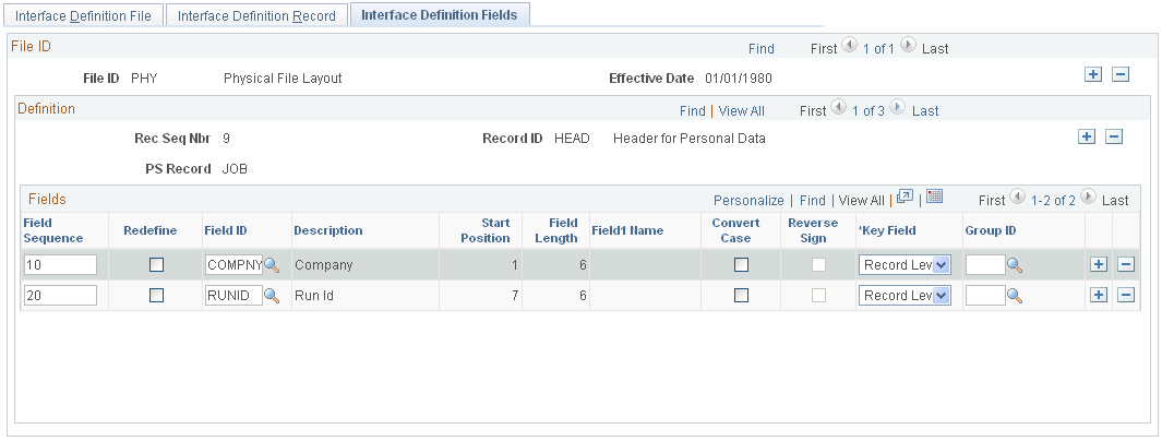

Use the Interface Definition Fields page (PI_FILE3_PNL) to set up the fields in a record.
Image: Interface Definition Fields page
This example illustrates the fields and controls on the Interface Definition Fields page.
Fields
Use the options in the Fields group box to define, order, and group the individual fields in a record.
Field or Control
Definition
Field Sequence (field sequence number) and Field ID
Select to enter a field and its position within the record (field IDs are defined on the Field Definition Table component).
Note: When you set up a transaction and its corresponding stop transaction, the field sequences in both records must match.
Redefine (redefine)
If the field's position in a record is also used by a subsequent field for a different purpose, use this check box to select the secondary field for later use. The secondary field must immediately follow the first definition with this position in the record.
Start Position, Field Length, and Field1 Name
Calculated from the Interface Field Table.
For physical files, the starting position and field length can be used to validate that the length of the fields has been set in the correct layout.
Convert Case
Used for ASCII files only. Select to override the case default for a field.
Reverse Sign
Select if the field is signed numeric type and the payroll system requires that the sign be reversed.
Key Field
Select from the following values:
  • None: Indicates a data-only field.
    Non Key: Indicates a non-key field.
  • Record: Defines a field as a primary record key. The system formats only one record per employee.
    Note: To make a field a record key, every key value in every row above the field must also be defined as a record key. The system delivers a COBOL error message if you order the key field in a manner such as Non Key, Record, and Non Key.
  • Occurrence: Defines a field as an occurrence key. Occurrence key processing allows multiple records to be formatted.
    See Working with Key Fields.
  • Effdt: Defines a field as an effective-date key. An effective-date key is special type of occurrence key. In addition to occurrence key functionality, further processing eliminates redundant information.
  • Company: If a field is defined as Company and the value on the System Table, Interface System Table 1 page - Process Filter field is set to Company, the system activates a filtering mechanism. Only rows with a Company value matching the processing company (the company tied to the run ID) are formatted and passed to the interface.
    See Working with Company Filtering.
Group ID
Select to indicate that the field belongs to a group of fields. All fields in the record with the same group ID are exported or imported together (if a data change occurs to one field in the group, all fields in the group are exported).
