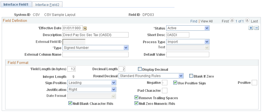

Image: Interface Field1 page, sample field ID used for import
This example of the Interface Field1 page shows a sample field ID used for import.
As shown in this example of the Interface Field1 page (Set Up HCM > Product Related > Payroll Interface > Interface Controls > Field Definition Table > Interface Field1), group ID D03 is attached to the field ID DPD03.
