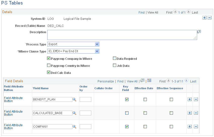

Step 1: Set Up the PS Tables Component
Identify the PeopleSoft tables and fields that store the data that is required for the transaction:
  • Table: DED_CALC.
  • Fields: DEDCD (deduction code), DED_CLASS (deduction class), and DED_CUR (deduction amount).
Use the PS Table (PI_PSREC_PNL) page to set up the PeopleSoft table and fields:
Image: PS Tables page for Step 1: Set Up the PS Tables Component
This example illustrates the fields and controls on the PS Tables page for Step 1: Set Up the PS Tables Component.

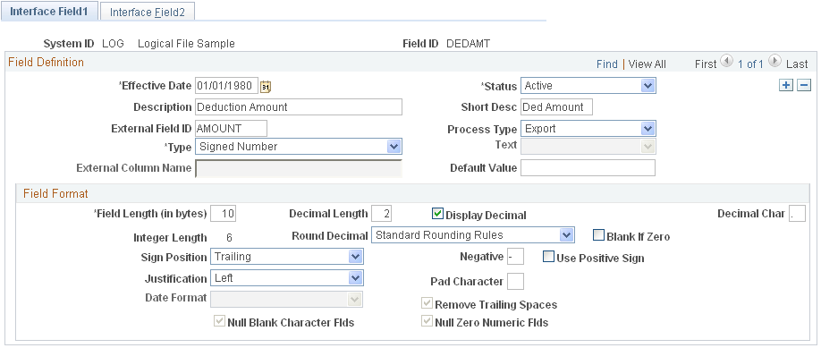

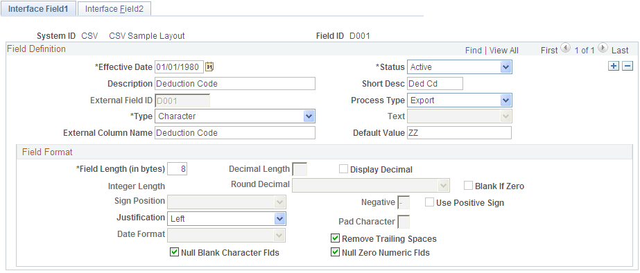

Step 2a: Set Up the Field Definition Table Component, Export File Fields
Define the fields for the deduction transaction: DEDAMT (shown in the following example) and DEDCD (not shown).
The default value for DEDAMT is the calculated deduction amount. The default value for DEDCD is the deduction code.
Note: The DED_CLASS field, identified in the PS Tables component, is not included in the export file. However, an instance ID for this field is set up in step 3.
Use the Interface Field1 page to set up the field definition for the DEDAMT field.
Image: Interface Field1 page for Step 2a: Set Up the Field Definition Table Component, Export File Fields
This example illustrates the fields and controls on the Interface Field1 page for Step 2a: Set Up the Field Definition Table Component, Export File Fields.

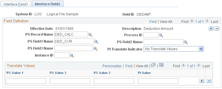

Step 2b: Set Up the Field Definition Table Component, PeopleSoft Table and Fields
Identify the corresponding PeopleSoft table and field for the DEDAMT field:
  • Table: DED_CALC
  • Field: DED_CUR
Note: You must set up the DED_CALC table and DED_CUR field in the PS Tables component before you can access them through the Field Definition component.
Use the Field Definition Table - Interface Field2 page to identify the PeopleSoft record (table) and fields:
Image: Interface Field2 page for Step 2b: Set Up the Field Definition Table Component, PeopleSoft Table and Fields
This example illustrates the fields and controls on the Interface Field2 page for Step 2b: Set Up the Field Definition Table Component, PeopleSoft Table and Fields.

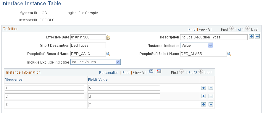

Step 3: (Optional) Set Up the Instance Table Component
Instance IDs enable you to restrict or modify the data that is sent to the third-party payroll system.
Deduction class values are A (after tax), B (before tax), N (non-taxable or employer paid), and T (taxable or imputed income). The Calculate Deductions process calculates deductions for all classes (A, B, N, T). In this example, the third-party payroll system wants to receive deductions only for class values A and B. Therefore, set up an instance ID DEDCLS for the DED_CLASS field to export calculated deductions for class values A and B. (Alternatively, you can set up the instanced ID to exclude class values N and T.)
Note: When setting up an instance ID, you can either include the values that you want to export or exclude values that you don't want to export. You may need to experiment to determine which set up works best. Alternatively, you can create a view to retrieve a restricted data set.
Use the Interface Instance Table page to set up instance IDs.
Image: Interface Instance Table page for Step 3: (Optional) Set Up the Instance Table Component
This example illustrates the fields and controls on the Interface Instance Table page for Step 3: (Optional) Set Up the Instance Table Component.

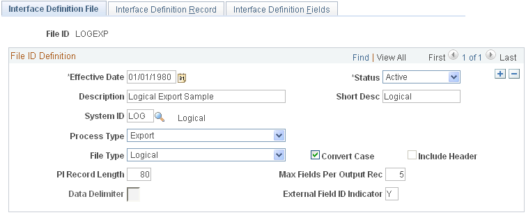

Step 4a: Set Up the Definition Table Component, File
Define the file, record, and field sequences for the export file.
Note: If you change any of the records or fields for a transaction, be sure to make the same changes to the records or fields for the corresponding stop transaction.
Use the Interface Definition File page to access the LOGEXP export file.
Image: Interface Definition File page for Step 4a: Set Up the Definition Table Component, File
This example illustrates the fields and controls on the Interface Definition File page for Step 4a: Set Up the Definition Table Component, File.

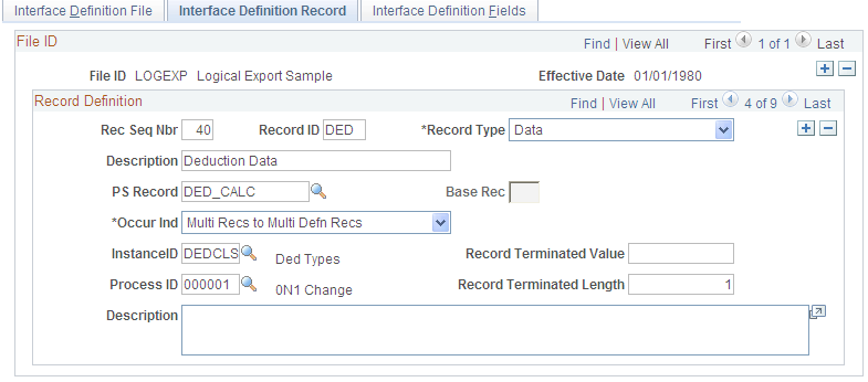

Step 4b: Set Up the Definition Table Component, Record
The LOGEXP export file includes nine record sequences. Record 40 is the deduction transaction. Record 50 is the deduction stop transactions.
Record Sequence
Record ID
Description
10
PERS
Personal Data
20
EMPL
Employment Data
30
JOB
Job Data
40
DED
Deductions
50
SDED
Stop Deductions
60
SAVE
Savings
70
SSAV
Stop Savings
80
APAY
Additional Pay
90
SPAY
Stop Additional Pay
Record 40, the deduction transaction (DED), includes:
  • Record type: Data
  • Instance ID: DEDCLS—the instance ID created in step 3.
  • Process ID: 000001 ON1 Change—a process required for the deduction transaction.
Use the Interface Definition Record page to set up the record sequences for the export file.
Image: Interface Definition Record page for Step 4b: Set Up the Definition Table Component, Record
This example illustrates the fields and controls on the Interface Definition Record page for Step 4b: Set Up the Definition Table Component, Record.

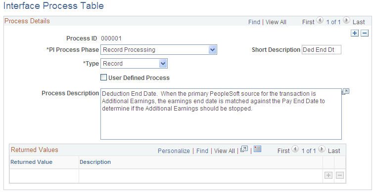

Step 2: Review the Process Table
Identify the COBOL process that will perform the stop transaction. This can be one of the processes delivered with Payroll Interface or a user-defined process. In this example, use Payroll Interface Process ID 000026.
See Working with COBOL Processes.
After the process is attached to the stop transaction record (see step 3), it runs in the background during the Export process. If the process determines that a deduction code is missing, the ZAMT default value (rather than the DEDAMT default value ) is written to the export file and a flag on the PI_PARTIC_EXPT table is set to P.
See Export Processing.
Use the Interface Process Table page to view the processes that are delivered with Payroll Interface.
Image: Interface Process Table page for Step 2: Review the Process Table
This example illustrates the fields and controls on the Interface Process Table page for Step 2: Review the Process Table.

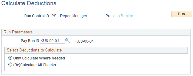

Step 1: Run the Calculate Deductions and Confirmation Processes
Calculate and confirm the deductions for the employee.
Use the Calculate Deductions page to calculate the deductions:
Image: Calculate Deductions page for Step 1: Run the Calculate Deductions and Confirmation Processes
This example illustrates the fields and controls on the Calculate Deductions page for Step 1: Run the Calculate Deductions and Confirmation Processes.

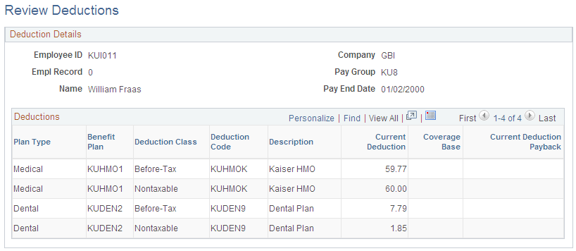

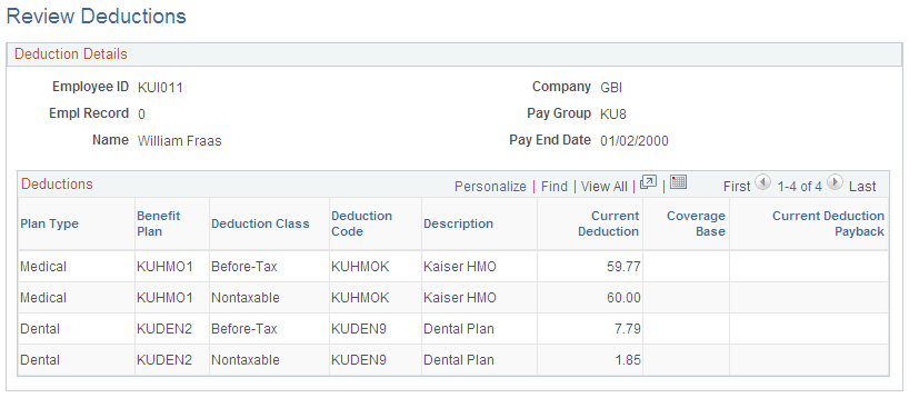

Review the results. The employee has medical and dental before-tax and nontaxable deductions. However, because the DEDCLS instance ID is set up, only the before-tax deductions will appear in the export file.
Use the Review Deductions page to review deductions.
Image: Review Deductions page for Step 1: Run the Calculate Deductions and Confirmation Processes
This example illustrates the fields and controls on the Review Deductions page for Step 1: Run the Calculate Deductions and Confirmation Processes.

Step 2: Run the Calculate Deductions and Confirmation Processes
Calculate and confirm the deductions for the employee. The terminated medical benefits no longer appear.
Use the Review Deductions page to review the deductions.
Image: Review Deductions page for Step 2: Run the Calculate Deductions and Confirmation Processes
This example illustrates the fields and controls on the Review Deductions page for Step 2: Run the Calculate Deductions and Confirmation Processes.
