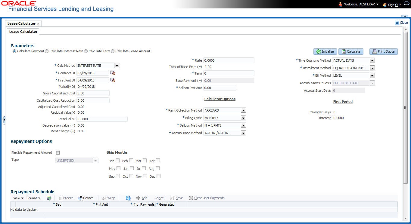

11.1 Lease Calculator
The Lease Calculator screen facilitates you to calculate various lease parameters such as Payment, Interest Rate, Residual Percent, Gross Capitalized Cost, Term and Lease Amount. You can define flexible repayment options, repayment/rate schedule and generate amortization schedules.
This screen is similar to the Lease Calculator screen opened from Underwriting or Funding screens; however, calculators opened from Tools master tab are standalone and do not link calculations or lease information to any specific application.
Based on the type of lease calculation method, the following calculation parameters are available in Lease Calculator screen:
Lease Calculation Method
Calculation Parameters Available
To Calculate

To calculate a lease payment
  1. On the Oracle Lending and Leasing home screen, click Tools > Tools > Lease Calculator.
  2. In the ‘Parameters’ section, Calculate Payment option is selected by default and the lease calculation method as ‘Rent Factor’. Select the required calculation method and the calculation parameter to display the applicable fields in Lease Calculator screen.
  3. In the Lease Details section, complete the following fields:
    Field:
    Do this:
    Calc Method
    Select the type of lease calculation method as one of the following:
    • RENT FACTOR (selected by default)
    • INTEREST RATE
    Note: Based on the above selection, some of the fields in Lease Calculator screen are either enabled or disabled, and if enabled some may be displayed in view only mode with default supported option. The same is detailed in respective fields.
    Contract Dt
    Enter the contract date.
    First Pmt Dt
    Enter the first payment date. Ensure that the payment date is later than the contract date.
    Note: This field is disabled for ‘Rent Factor’ type of lease calculation method and the value is defaulted from Contract Date. However, for ‘Interest Rate’ type of lease calculation, this field is either editable or dis­played in view mode based Rent Collection Method.
    Maturity Dt
    View the maturity date.
    Enter the gross capitalized cost.
    Capitalized Cost Reduction
    Enter the capitalized cost reduction.
    Adjusted Capitalized Cost
    View the adjusted cap cost.
    Residual Value (-)
    View the residual value.
    Residual%
    Enter the residual percentage.
    Depreciation Value (=)
    View the asset depreciation value.
    Rent Charge (+)
    View the rent.
    Rate
    Enter the rate.
    Rent Factor
    View the rent factor.
    Note: This field is displayed only if the lease calculation method is ‘Rent Factor’.
    Total of Base Pmts (=)
    View the total of payments.
    Term
    Enter the term.
    Base Payment
    View the base payment amount.
    Balloon Pmt Amt
    Specify the balloon payment amount.
    Note: This field is displayed only if the lease calculation method is ‘Interest Rate’.
    Calculator Options section
    Note: Except for Rent Collection Method (as Advance or Arrears), the other fields in this section are available only for ‘Interest Rate’ type of lease calculation method and the default values are populated from Setup > Contract screen. Also the Rent Collection Method field is view only for ‘Rent Factor’ calculation method.
    Select the applicable rent collection method from the drop-down list.
    If the lease calculation method is selected as Rent Factor, the rent collection method is set to ADVANCE by default. For Interest Rate calculation method, you can either select ADVANCE or ARREARS.
    In case of ADVANCE, the first payment date is displayed in view only mode and value is automatically populated from contract date. The first bill would be generated on contract date.
    In case of ARREARS, you can specify the first payment date as future date (but not the contract date) and bill would be generated from first payment date.
    Billing Cycle
    Select the billing cycle frequency from the drop-down list. System displays the applicable billing cycle by default based on the product and the calculation method defined at Setup > Products screen. The edit­able nature of billing cycle is controlled by the system parameter UIX_BILL_CYCLE_ALLOWED_IND.
    System supports ‘Biennial’ (once every 2 years) and Triennial (once every 3 years) type of billing cycles. Based on BILL_CYCLE_CD lookup, the billing cycle ‘frequency’ can be defined.
    During ‘Term’ calculation, the 'Rate' field is always con­sidered as per Year only. System displays an error to refine the input data if the calculation for Biennial term goes beyond 15 years and Triennial term goes beyond 10 years. For additional considerations of Biennial and Triennial term calculations (if any), refer to product release notes available at OTN library.
    Balloon Method
    If the lease calculation method is selected as Interest Rate, then the balloon payment method for accounts funded using this instrument is ‘N + 1 PMTS’ by default. Amortization happens based on N+1 payments.
    Accrual Base Method
    Select the accrual method used to calculate interest accrual for this instrument from the drop-down list.
    Time Counting Method
    Select the time counting method used to calculate inter­est accrual for this instrument from the drop-down list.
    Installment Method
    For ‘Interest Rate’ type of lease calculation method, the installment method by default is EQUATED PAYMENTS where-in, the installment amount is same for all billing cycle.
    Bill Method
    Select the billing method for accounts funded using this instrument from the drop-down list.
    Accrual Start Dt Basis
    This field will be enabled only if the product category is selected as Islamic.
    Select to define the start date from when the interest accrual is to be calculated for this lease instrument. If Effective Date is selected, then the interest is calcu­lated from Contract date and if Payment Date is selected then the interest is calculated on basis of (first payment date minus one billing cycle).
    Accrual Start Days
    Select the actual date from when to start interest accrual for lease is to be calculated.
    First Period section
    Calendar Days
    View the number of calendar days between contract date and the first payment date. The calendar days will differ based on the calendar method selected.
    Interest
    View the profit accrued for the calendar days.
  4. In the Lease Calculator section, click Calculate to view the results. You can further proceed with below sections to define flexible repayment options, repayment/rate schedule and generate amortization schedules.

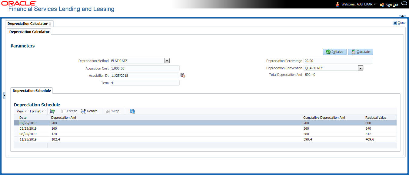

11.3 Depreciation Calculator
The Depreciation Calculator screen facilitates you to simulate depreciation calculation of an asset based on asset acquisition cost and using specific depreciation method, frequency and term. Further, you can view the depreciation amortization schedule based on calculation.
Depreciation Calculator is a standalone tab and information calculated here can only be viewed. They cannot be copied to the application / contract.
If you want to clear (or “refresh”) the Depreciation Calculator at any time, click ‘Initialize’ in the Parameters section.
To calculate an asset depreciation
  1. On the Oracle Lending and Leasing home screen, click Tools > Tools > Depreciation Calculator.
  2. In the Parameters section, complete the following fields:
    Field:
    Do this:
    Depreciation Method
    Select the asset depreciation method to be used for calculation as one of the following from the drop-down list.
    - FLAT RATE: This method is used to depreciate the asset over a fixed time using a fixed rate. This method of calculation is similar to Written Down Value Method (Diminishing Balance Method / Reducing Installment Method).
    - LIFE BASED: This method is used to depreciate the asset over a fixed time using the specified rates. This method of calculation is similar to Straight Line Method (Original Cost Method / Fixed Installment Method). On selecting this option, ‘Depreciation Rate Schedule’ sub tab is enabled to define depreciation rates slab.
    Acquisition Cost
    Specify the asset acquisition cost.
    Acquisition Dt
    By default, current system date is selected as the asset acquisition date. You can modify the same using the adjoining calendar. Based on this date depreciation accounting is done and is calculated till the term speci­fied.
    Term
    Specify the total term for depreciation calculation.
    Depreciation Percentage
    Specify the percentage of depreciation to be calculated during the above term. This option is not available for life based depreciation method.
    Depreciation Convention
    Select the frequency at which the asset depreciation is to be calculated from the drop-down list.
    Total Depreciation Amt
    The total depreciation amount is auto calculated and displayed on clicking Calculate button.
  3. In the ‘Parameters’ section, click Calculate to view the results. System displays the total depreciation amount for the simulation values along with the ‘Depreciation Schedule’ in below sub tab.
  4. The ‘Depreciation Schedule’ sub tab displays the following details:
  1. If you have selected LIFE BASED depreciation method, the ‘Depreciation Rate Schedule’ sub tab is enabled to define depreciation rates slab. For more information, refer to ‘Deprecation Rate Schedule’ tab details in Lease setup guide.
