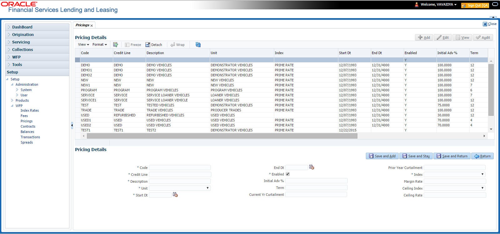

To use the Pricing link
On the Oracle Financial Services Lending and Leasing home screen, click Setup > Setup > WFP > Pricings
In the Pricing Details section, select the record you want to work with and click Show in the Details column.
  1. In the Pricing Details section, enter, view, or edit the following information:

  2. Click Save in the Pricing Details section.
