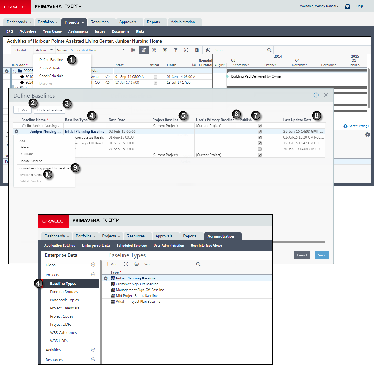

This illustration is a graphical representation of the text in the following table.
Table of Working with Baseline Elements
Item
Description
item one
Define Baselines: Use Define Baselines to add and delete baselines and restore projects from baselines.
item  two
Add Baselines: When you add a baseline, give it a name, assign it a type, and decide if you want to make it the Project Baseline or User's Primary Baseline for the currently selected project. Baseline designations are made in the projects rows of the table highlighted in blue.
item  three
Update Baselines: Update the baseline with the latest data from the project. You can select which data to update.
item  four
Baseline Type: Assign baseline types to baselines to help categorize multiple baselines for a single project. Configure the available baseline types along with your other Enterprise Data settings.
item five
Project Baseline: Lists the available baselines for the selected project. Select the baseline to use as the project baseline. If a baseline does not exist, the current project is the default value.
item six
User's Primary Baseline: Select the user's primary baseline from the list of available baselines. If a baseline does not exist, the current project is the default value.
item seven
Publish: Select this option for all baselines that you want to publish for reporting purposes. You must publish a project before you can publish any of its baselines.
item eight
Last Update Date: The date that the baseline was last updated.
item nine
Convert Existing Project to Baseline: Save a copy of the baseline before you convert it. Convert a project to use it as a baseline for a current project.
item  ten
Restore Baseline: Use restore a baseline to modify a baseline project. You must first unlink a baseline from its current project by restoring it as a separate project. You can then work with this restored baseline project as you would any other project in the EPS.
