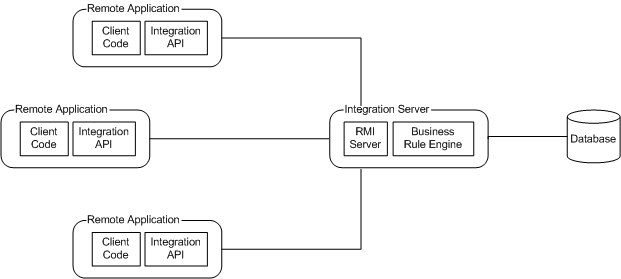

In Remote Mode, the client code runs on a different machine than the Integration server and Java Remote Method Invocation (RMI) is used for communication. Multiple clients can communicate with the Integration server simultaneously.
Note: The maximum number of clients that can access a remote server at one time is approximately 50. This number can be less, depending on multiple factors including system hardware and network configuration.
There are three possible service modes for the RMI server: Standard, Compression, and SSL. By default, all three modes are enabled. The RMI server also requires the RMI Registry, which listens to port 9099 by default. You can change the default settings for the RMI server via the Administrator tool, which can be launched using admin.cmd (admin.sh for AIX, HPUX, Linux, Solaris). The following settings can be found under Configurations\Custom\<Configuration Name>\Integration API Server\RMI:
Enable - Enables (true) or disables (false) the RMI server (default setting is true).
RegistryPort - Port for the RMI Registry (default setting is 9099).
StandardServiceEnable - Enables (true) or disables (false) the Standard service mode (default setting is true).
StandardServicePort - Port to use for Standard service mode. A setting of 0 (default) means that any available port will be used. If the server will be accessed across a firewall, you must set this to a specific port.
CompressionServiceEnable - Enables (true) or disables (false) the Compression service mode (default setting is true).
CompressionServicePort - Port to use for Compression service mode. A setting of 0 (default) means that any available port will be used. If the server will be accessed across a firewall, you must set this to a specific port.
SSLServiceEnable - Enables (true) or disables (false) the SSL service mode (default setting is true).
SSLServicePort - Port to use for SSL service mode. A setting of 0 (default) means that any available port will be used. If the server will be accessed across a firewall, you must set this to a specific port.
If the API is configured to use Remote Mode, the service mode can be chosen at runtime using the RMIURL helper class: standard, compression, and SSL modes are available.
