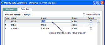

To edit a data set value
  1. Open a Data Definition and click the Data Set tab.
  2. Double-click the value or label to modify. The field becomes editable. Edit the field as needed and click OK.

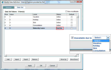

To activate or deactivate a data set value
  2. Click the Status pull-down menu and choose Active to activate, or Inactive to deactivate. Click OK.
    Inactive values do not appear on the list at runtime.
Active and Inactive data set values
To remove a data set value from the data definition drop-down list
  2. Do one of the following:
    • To permanently remove a value, select it form the list and click Remove.
    • To remove the value from the data definition drop-down selection list that the user is presented with, but retain it in the data set value list, click Inactive.
  3. Click OK.
