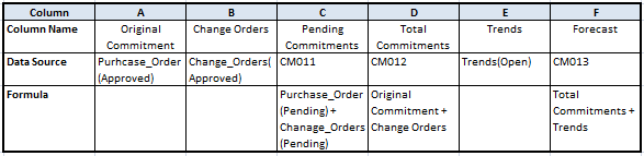

Update generic cost sheet columns and rows
You may have a large number of codes that are used within the Generic Cost Manager. In addition you may have a large number of shells in your implementation. To update codes and columns in your generic cost manager sheets with a minimal effort, you can push columns in a project or shell template generic cost sheet from the Columns Log to cost sheets.

To add or update generic cost sheet columns from a template
  1. Go to the Company Workspace tab and switch to Admin mode.
  2. Click Templates > Shells in the left Navigator.
  3. Open the shell-type template to update.
  4. In the shell template, navigate to Configurable Modules > Generic Cost Manager.
  5. Select the Generic Cost Manager Sheet template and click the Structure button.
  6. In the Generic Cost Manager Sheet log, select the cost sheet template and then click the Columns button. The Columns Log window opens.
  7. Select a cost sheet column.
  8. Click Update Shells and choose one of the following:
    • Shells: You can use this option to select one or more shells to update. When the update window opens, it lists all shells in the project. You can use Find to isolate the shells you want to update. The find window contains data elements from the Find form that was designed in uDesigner. When you have isolated the shells to update, click the Update button and select either Selected Shell(s) or All Filtered Shells.
    • All Shells: You can use this option to update all shells of that shell type.
    • History: You can view the update history from past updates or cancel a request before the update begins.
    An Alert window opens letting you know that you are about to push changes to the selected shells; there is no undo for the update.
  9. Click Yes if you want to proceed with the update, or No to cancel.
