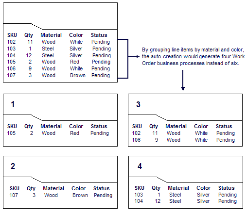

Unifier auto-creates new business process records using a BP Creator element. If this element is on the upper form of the business process, it will auto-create a single record. If the BP Creator element is on the detail or line item form, it will auto-create a record for every line item on the source record. For example, if source tab A has a BP Creator element and 10 line items, and source tab B has the same BP Creator element and 7 line items, 17 new records will be auto-created.
Sometimes, however, creating a record for every line item is cumbersome. You can end up with 17 records that differ in only one aspect, such as a color. For cases like this, you can group line items for auto-creation in order to create fewer generated records. In a simple example for a lumber yard order, you might have doors made of wood or steel, both in colors of white and red. You could group the line items according the material (wood or steel) and color (red or white) to create fewer work order records.
