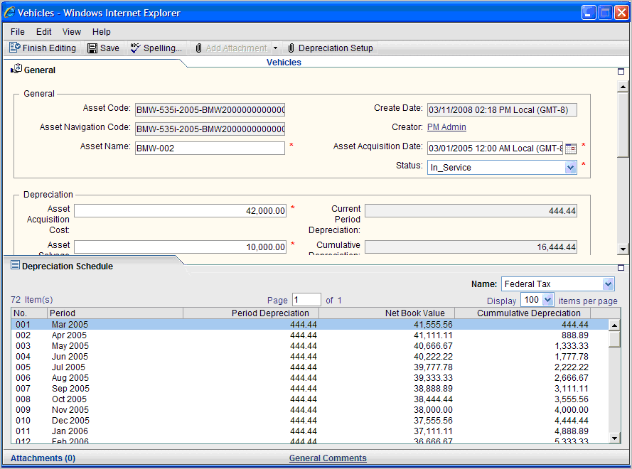

You can set up the depreciation of an asset template after the general information has been completed, and you have clicked the Save or Finish Editing button. This is optional in a template.
Depreciation schedule columns are predefined. Columns are populated based on the depreciation calculation. Below is a sample depreciation schedule.
Note: Before you can create a depreciation schedule for an asset, you must populate the data set for the SYS Depreciation Name data definition. To do this, use the instructions under Adding and Managing Data Sets

  4. Click the Depreciation Setup button. The Depreciation Setup window opens.
  5. Add a row by clicking the Add Row button.
  6. Complete the information for the depreciation setup as described in the table below.
  7. Click OK to save and exit the window.
  8. When the asset template is complete, click Finish Editing.
