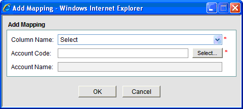

  1. In User mode, go to the Company Workspace tab and open the Asset Sheets log in the left Navigator, select an asset sheet, and click the Properties button. The Properties window opens.
  2. Click the Options tab, then click the Add button. The Add Mapping window opens.
  3. Use the table below to complete the fields in this window.
  4. Click OK.
In this field:
Do this:
Column Name
The drop-down list lists all columns that are defined on the asset sheet. Select the column you want to map to the account sheet.
Account Code
Click Select. A picker window opens displaying active codes from the accounts sheet. Select a code and click Open.
Account Name
This field is populated with the name of the account code chosen in the previous field.
To modify or remove mapping
Select a row and click Modify to edit mapping, or Remove to remove mapping. You cannot map two columns of an asset sheet to a single account code.
