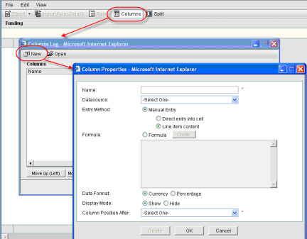

To add a funding column
  1. Open the funding sheet or template:
  2. Open the funding template and click the Columns button. The Column Log window opens, displaying the list of existing columns.
  3. Click New. The Column Properties window opens.
  4. Complete the Column Properties window as described in the table below.
  5. Click OK to add the new column.
In this field:
Do this:
Name
The name you choose will appear as the column header. You may manually enter a column name, or, if you leave the Name field blank, the selection you make in the Datasource field will automatically populate the Name field.
