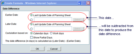

To create a "date difference" formula for a column
  1. In the Data Source field, choose the field on the sheet that should show the value you are calculating here.
  2. In the Entry Method field, click Formula and select Date Difference from the list.
  3. Click the Create button. The Date Difference window opens.
  4. For the Earlier and Later Dates, you can use either the last date the Planning Sheet was updated, or you can choose another field from the sheet or a planning item to supply the date value.
  5. In the Calculation based on field, specify whether the calculation should be based on calendar days or workdays.
  6. If you want the value in include fractions of days, select the Show Partial Days check box.
  7. Click OK.
