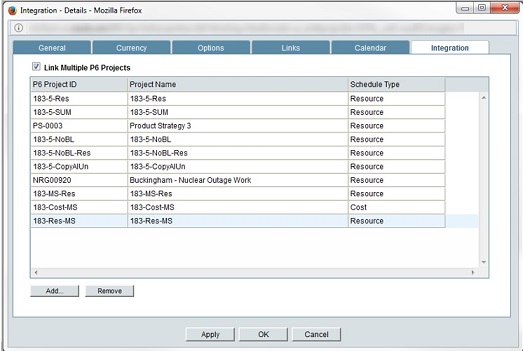

  1. Navigate to the shell in which you want to map multiple P6 projects to perform Earned Value analysis.
  2. In the Integration tab, select the Link Multiple P6 Projects checkbox. (This drives the synchronizations in the Gateway node).

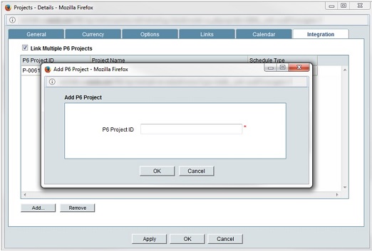

  3. Click Add.
  4. In the Add P6 Project dialog, enter the project ID and click OK.
The project name and schedule type are auto-populated after running the sync.
Only Cost Loaded and Resource Loaded projects are used in Earned Value Analysis.
The Duration Based projects are ignored because they do not have cost data.
