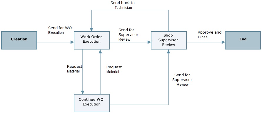

Preventive Work Orders (PWO) BP - Workflow
