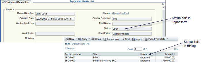

You can include statuses only in the upper portion of a form or in a log.
