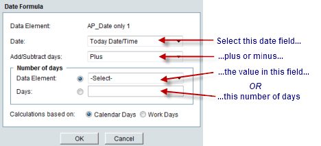

To create a date plus/minus formula
  1. Open the form that contains the date field for which you want to create a formula. The Form Designer window opens.
  2. In the Form Designer window, select the date field for which you want to create the formula.
    When the calculation is performed, this field will appear as read-only on the form and will be automatically updated whenever the fields that make up the formula change.
  3. Click the Formula button. A Date Formula window opens.
  4. For Calculations based on, choose:
    • Calendar Days to calculate the formula based on calendar days. This option does not take company non-working days into account.
    • Work Days to calculate the formula based on the company calendar working and non-working days.
