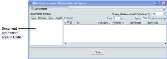

When a user opens a document business process, Primavera Unifier also opens a line item list; however, the list behaves differently, depending on whether or not the user activates the detail form. If the detail form is not activated, the Line Item list serves as a document attachment area, where users can attach documents or folders. If the detail form is activated, the user can add documents as line items.

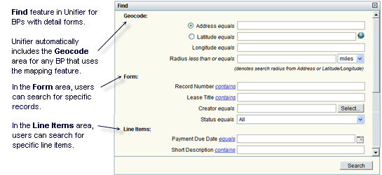

Primavera Unifier users will sometimes need to locate particular line items in a business process, often for the purpose of task management or milestone tracking. To make it easier for users to locate a line item, use the Find tab to specify field names on the form that they can use in their search. The user can also narrow a search by using operators on the fields, such as "contains" or "equals."
To specify search criteria
  1. Click the Find tab, then click Add. The Find Properties window opens.
  2. In the Data Element Label field, select a field (data element) users can use to find a line item.
    When you select a data element label, uDesigner automatically displays the database label of the element in the Find Label field. This field is editable.
  3. If you want to change the name of the element to something more meaningful to the user, enter the name in the Find Label field.
  4. Click Apply.
  5. To add another element for searching, repeat steps 2 through 4. Then click OK.
  6. On the Line Items window, click OK.
